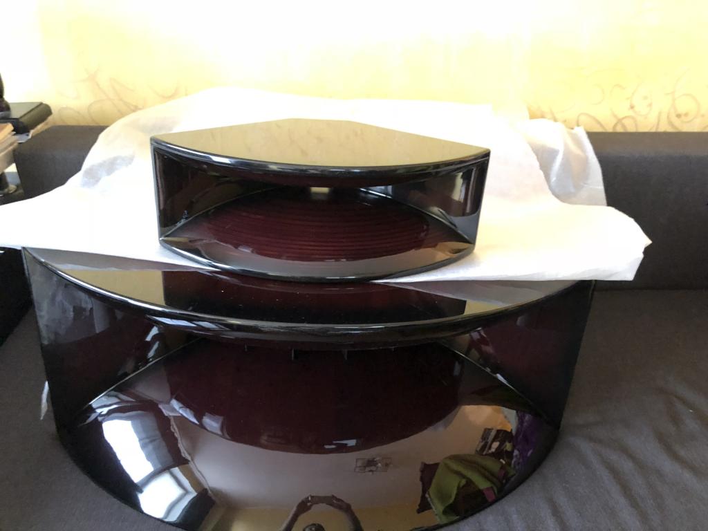

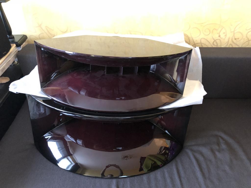

Yes, Yamamoto makes them (I believe), but I've seen clones as well.
It's a monster: Width 806, height 330 and depth of 513mm, it weighs 37Kg.
Can be used from 400Hz
Curves look decent too.

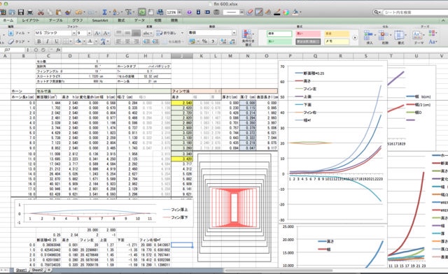

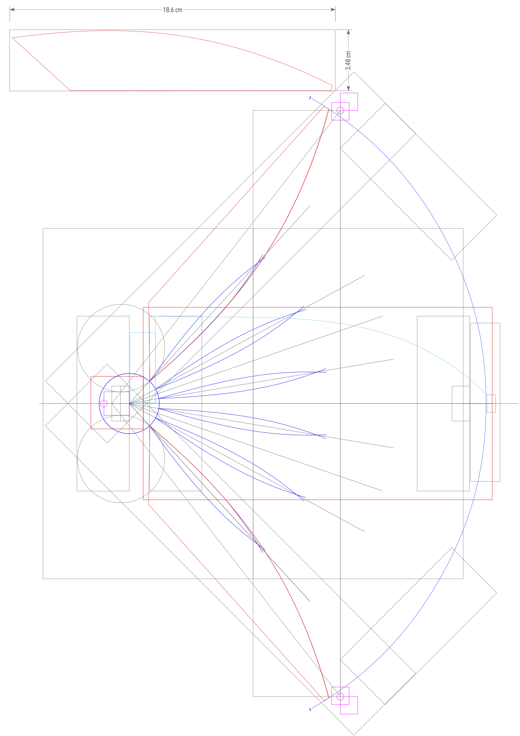

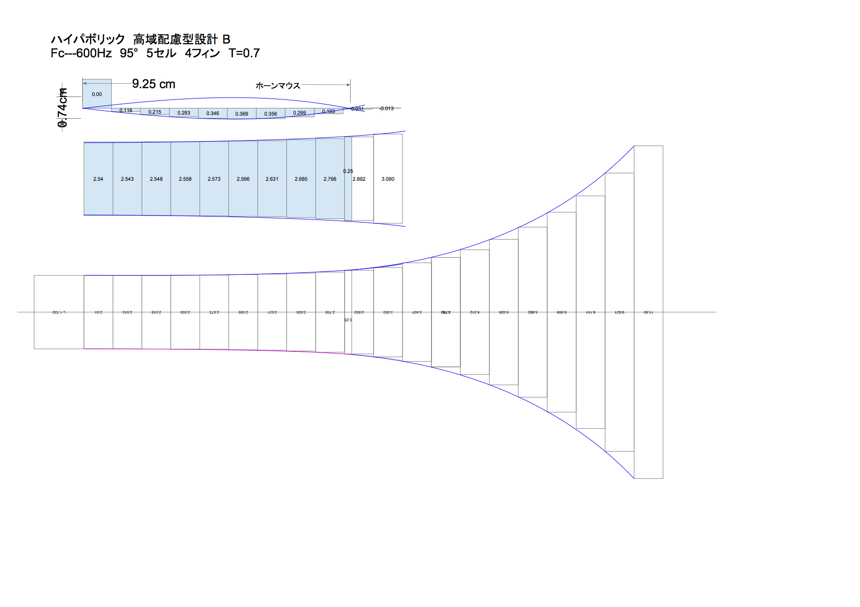

Found some Japanese tools for docali to play with...
This looks very sophisticated. Thanks!
What I find interesting with the Yamamoto F280A is that the fins already show a slight expansion vertical wise which should make it it much more difficult to manufacture. This is different to all other horns of this type. Additionally, the fins are made from a special very hard wood.
Where do you have found clones of this horn?

The clones were posted here.

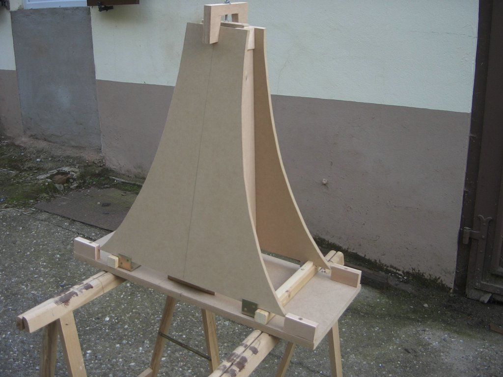

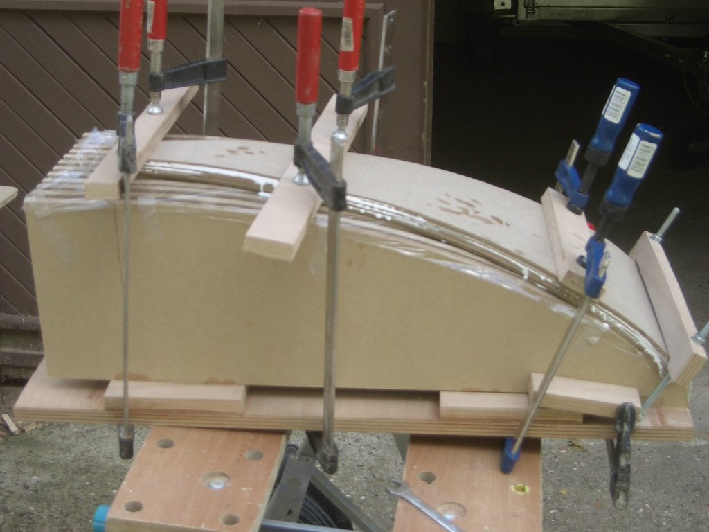

Big, non-snail Sato horn.
Fc is 110Hz and response shown with JBL 2482 + Radian diaphragm.

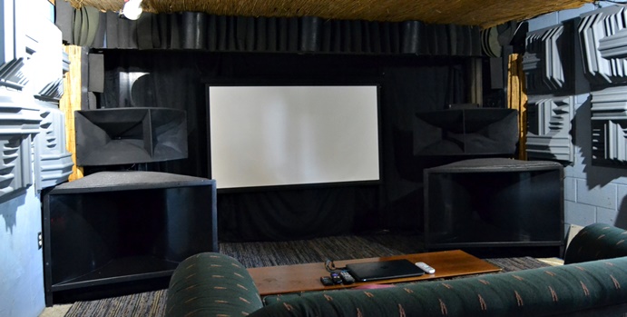

2" exit Docali
Low compromise 2 way 70 cycles up.
Are those HR9040s Nextel coated?
I know these were also available in black, but yours look velvety.
Mid-bass cabs are not Electro-Voice, I suppose?
