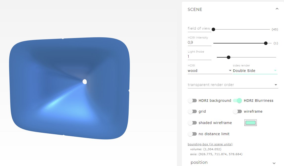

Here's a site that can easily view them online: Creators 3D
attachment.php
(this is the swh_ra_160_pe)
You can drag and drop the *.ply file to see the horn (just make sure to set sides render to "Double Side"). I have not checked if something like Fusion 360 supports the *.ply format, I know it can read *.stl.
This file is still a points cloud. To get it as a proper working model for CNC (or printing) it should be converted to a solid object by adding thickness etc.
When you've made a solid model from this you could slice it up again to create the information needed for a CNC tool (just as pictured in your post this would create a stepped model of the horn if you build it in slices).

Windows actually has a model viewer, never knew. Though I'm not sure what to do with it. I mean it looks cool, but I'll probably have to put it into autocad or something to get it represent real dimensions.

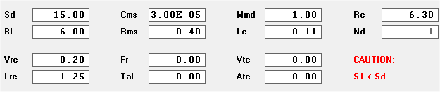

Allen....I was thinking that. I tried to make a horn the other day it keeps giving me issues because the thiel specs aren't optimal. Whens the last time you've seen thiel specs for a compression driver. I'm probably using it wrong.
Autocad wouldn't be the tool I'd recommend. Fusion 360 (also from AutoDesk and free to use for DIY) is a much better tool for that job. There you could build it up as a proper horn with a wall thickness etc. This ply file just represents the inner surface. The online viewer does give you the bounding box, in other words it shows the outside dimensions.
(my Windows did not have that cute 3D viewer, still at Win 7 Pro here :))

Thanks for the preparation of the ply file. I just recognize that the point cloud is not perfect at all. There are some artifacts on the outer edge which are not intended. My calculator was never tested with such large horns :eek:

Those specs are fine. You make a horn and press calculate. You switch back to the input screen from the menu at the top to make changes then recalculate.
I don't use the wizard so I read the fine manual ;) and found out it only works with C/P/E and multi section horns. LeCleach, OS and Hyp/Ex are examples of horns that hornresp will only do with a single section operating at a time.
I understand hornresp is a little old school. It harks back to a time when this information was only available at a library, all calculations by hand and near no chance of finding anybody to help you with it. As a result DIY horns were not as common as they could have been, but many were brilliant just like their designers. Information is information even when you have to dig.
