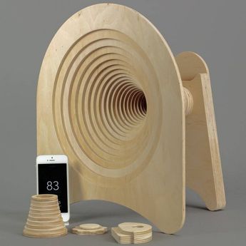

Isn't that how to properly run a horn down to 200hz? These are just ideas at the moment, I mean if its more reasonable to use a 200hz tractrix/jmlc profile and cross at 300hz thats what I would do.
Here is a variant based on 250Hz but the loading should be lesser because of the increasing T factor. Should be better usable on top of a bass cabinet.
View attachment drba_250hz_pe.zip
I like that shape! Unfortunately, 3D print service automatically linked to my viewer said its too large to print and warned about thin walls![]()
It needs to be solidified and yes it is big
But no problem to make it smaller.
...the same as just shown but with a little portion of stereograhic projection applied.
View attachment drba_250hz_pe_sp.zip

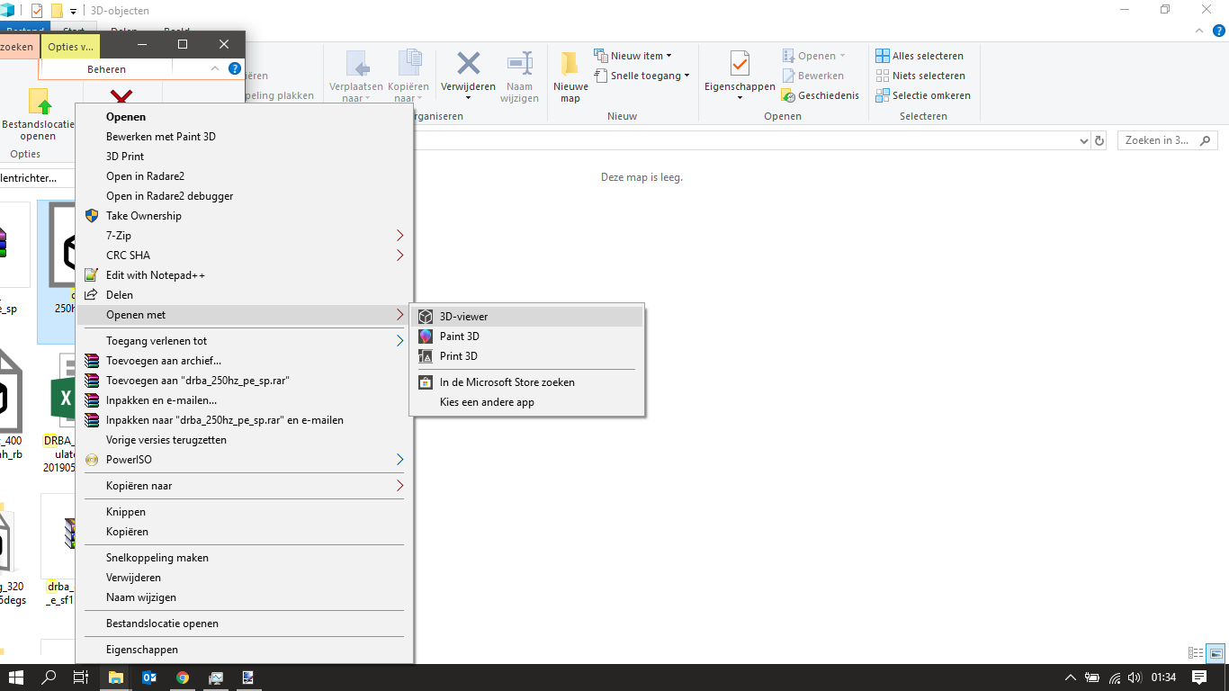

What are you guys using to view these files btw?

You can use the windows 3D viewer or Meshlab or any other that can open ply files. ply is a different format like stl.
A tractrix like this from Autotech would beam terribly. The cut-off in my examples only hold for horns with constant T factor. So, the examples should have less loading capabilities. You can roughly consider the length of the horn and do a quarter-wave or half-wave guess.
The first question for me is what driver you want to use and how far you want go down for the cross-over frequency. Even for my 18s 4015Be I would not go much below 650 Hz as cross-over point with an appropriate horn. My 400Hz Tractrix already beams quite much but sounds natural. The best compromise so far is a Selenium 40x20 horn.
If you leave the T factor constant you get a quite long horn but with slightly more beaming. This is why I introduced an algorithm for a constantly increasing T factor.
So, you should a little more precise what you want to use for your setup.

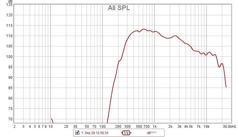

The driver is an Celestion Axi2050, 2" exit.
xover desire is 200hz
Beaming is acceptable
Your input is welcome...you say that your unique T factor adjustment makes for less beaming yet the half wavelength intended is 34" so I imagine that the opening would be larger. What is that number? I may sacrifice size in order to gain performance. A tractrix horn would lessen the opening diameter.
Celestion Axi2050 - 2" Compression Driver
Looking at the PWT I believe that with the proper horn this driver can play even lower than 200hz. 200hz xover is my goal... but 150hz xover putting me at -1db at 200hz in the horn... would make me cry tears of joy. The group delay of this driver on a 250hz classic JMLC seems to comply...in the measurements it seems that the driver falls off right at 250hz. I am also believing that group delay will improve with a larger horn, for the passband. The TD15M is under 1ms above 150hz.
So I hope that answers your questions, thank you so much for lending you time! The first jmlc you sent (160hz) what are its dimensions?

Once you've extracted the .rar, right click on the "drba_250hz_pe_sp" 3D-object file (.ply) and choose "open with" > 3D-viewer.
The attachment is in Dutch, but you'll get it.
This only works on Windows 10, if you're still on 7 you can use an online 3D viewer, or download meshlab.

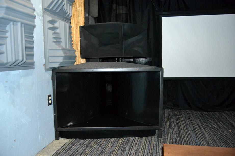

Mid-bass cabs are not Electro-Voice, I suppose?
Hi
I used black mat camouflage paint. They disappear visually even when I have on the projector in the dark room. The original white was like sitting between two bathtubs.
Midbass is Emilar horn with floor/sidewall placed with B&C 8".
I also use the EV big 60 degree horns with JBL 2450SL.. both sound very good.
Crossover is 500 Hz - upper range driver is Radian 835 1.4" with BE
