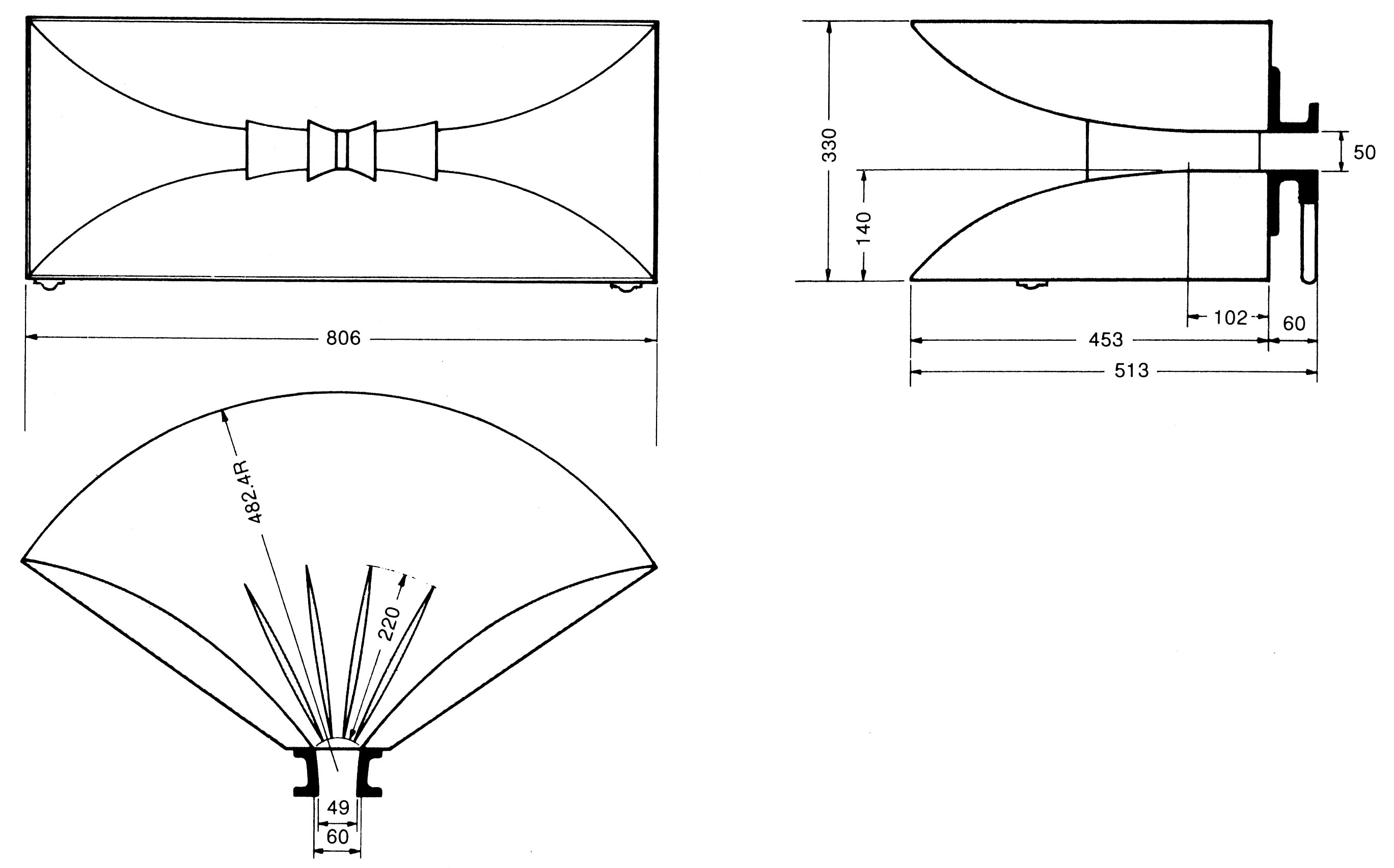

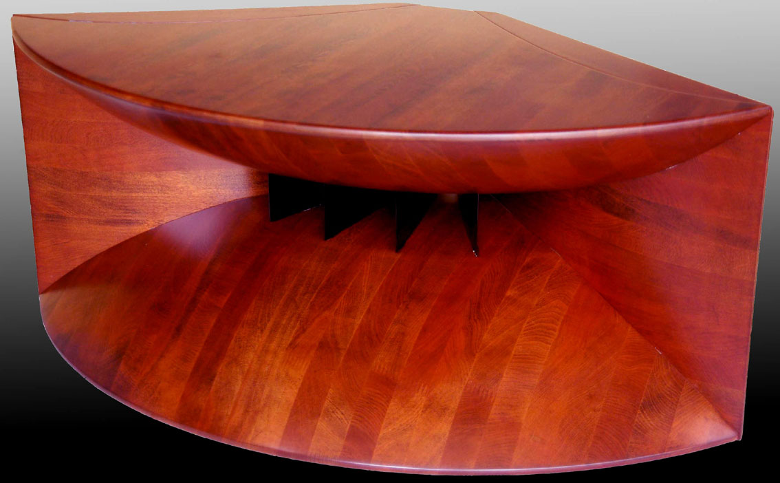

Would like a 150Hz pair of the Cowan wooden horns shown further up or a pair of Markus Klug multi cell horns eventually.
What is the opinion here on those multi cell horns?

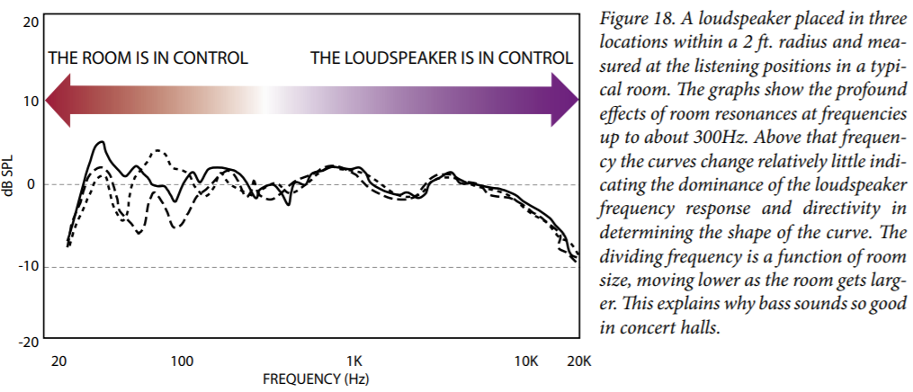

Well from my experience everybody can locate 80hz... in the required conditions: either some very big room or outside.
Once you are in a room and below schroeder frequency the room dominate the reproduction and every bets are off wrt outcome in low end ( even simulations used by acousticians are only what they are, they often only gives guideline and i witnessed this a few times.). Given the room volume schroeder frequency change and thus ability to locate low end follow. I'm almost sure this happend as i was unable to locate subs xover at 150hz in mid sized room and heard outside as low as 80hz pan and phase effects.

But as krivium says, once you are in a room and below Schroeder frequency the room dominate the reproduction...
See https://www.harman.com/sites/default/files/AudioScience_0.pdf and Room Modes 101 - Acoustic Frontiers

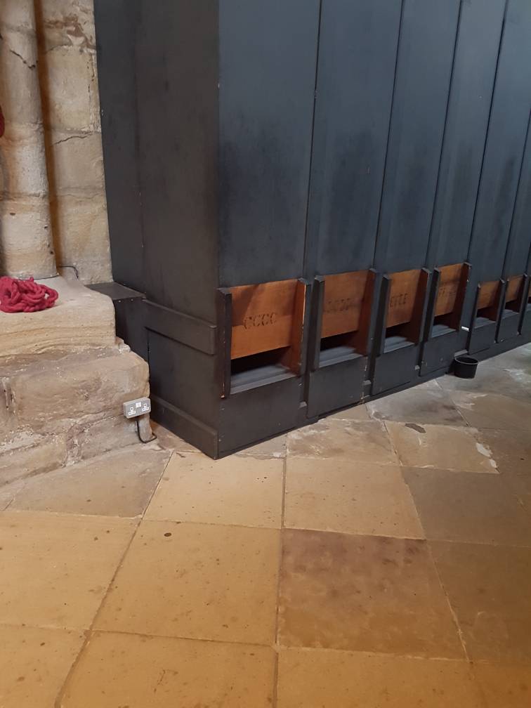

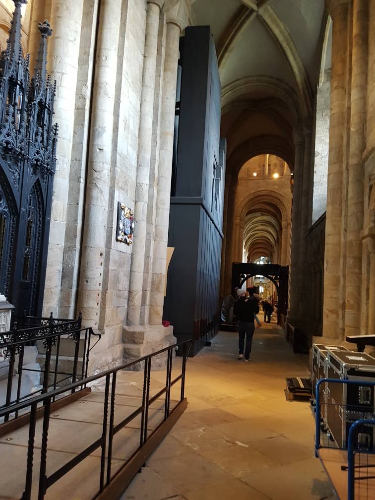

The multi-cell horns are very interesting indeed. It's been shown in various tests by P. Newell and K. R. Holland, as well as JMLC (ETF 2010), these don't exhibit typical horn artefacts, while at the same time allow very low crossover points.
Evidently, multi-cells aren't perfect, but very pleasing to the ear, according to the people who've listened to those.
In Durham Cathedral......Not suitable domestically methinks.
True, but fortunately only need a small fraction of a cathedral's sheer acoustic power to [over] power a typical consumer app. 😉

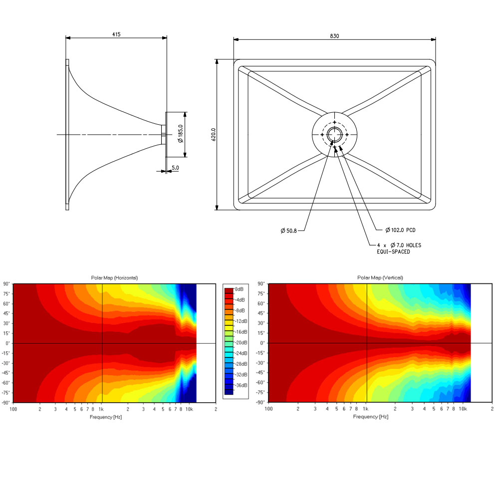

Hi guys great thread. Thought this might be useful. Lean Business is now stocking Celestion's new LH9045 horn for their axi driver!
Celestion LH9045R 2 90 x 45 Wide Bandwith Horn
Thanks for notifying!
These are not exactly cheap at £950.00 for the LH9045R and £1,050.00 for the LH6040R.
A Klipsch K402 is only slightly more expensive, and probably (a lot) cheaper in the US due to shipping costs.
