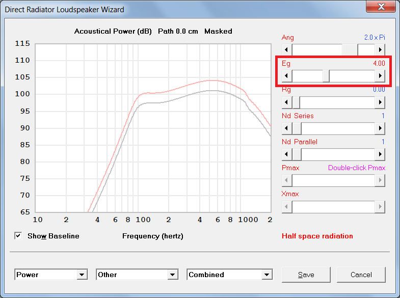

Double-clicking on the Pmax slider label selects the Maximum SPL mode (see the Help file for details).
Leave the Pmax and Xmax sliders disabled and simply adjust the Eg slider if you want to change the input level (2.83V = 1W into 8 ohms, 4.00V = 2W into 8 ohms, etc).
the thing that makes no sense is that sound is only emitted from one source when there should be two in the wavefront sim.
I suggest that you forget about the Wavefront Simulator, it won't really help you with your transmission line design. It serves a different purpose.

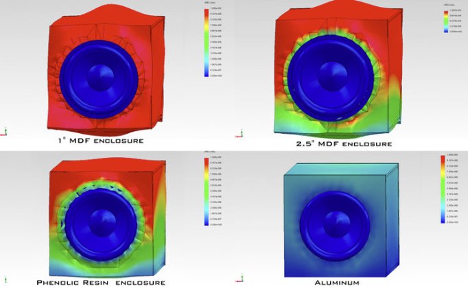

I’ve been looking up enclosure design, seems like 1” mdf would be fine with minimal bracing and some acoustic dampening material on the walls and call it a day?

But the pictures make me think some bracing would not have to be a bad idea. Now yours will be ported though, not sealed like their monster subs...

Don't have my calculator available, but from memory it takes 1.125" thick MDF to match close enough to 3/4" [19 mm] no void marine grade, BB and apple plywood's ~1.8 mil psi stiffness [MOE], which with any decent size sub will still require significant bracing to make it 'ring' like metal where it ideally needs to be and while bracing increases stiffness quicker than thickness it will still require a lot more, so ideally start with 10 ga CRS with cast iron angle bracing and 'U' channel iron fork lift skid plates to move it around and with this much stiffness, mass it won't need anything but a motor brace.
While a cab designed to deal with the hum of an electro-mechanical 10 kV motor controller is a bit overkill for your app, it's not as excessive as you might think when trying to eek the most acoustic efficiency practical out of a speaker cab, so think 'stiff' first and foremost with mass a close second to keep it 'planted', which if a separate cab can have removable mass on top.

I was reading about dual panel walls with sand in between the layers. That’s a thing I guess.
It's about increasing stiffness, mass loading, to provide a stable, inert working platform for the driver while not being excited by it, but when I 'ran the numbers' decades ago it wasn't heavy enough to either push the cab's resonance below it's tuning or stiff enough to raise it well above it, so while certainly an above average performer, wasn't all it could be and why I prefer pushing the cab's resonance ~ an octave above the drivers pass band with high MOE materials, proper bracing.
