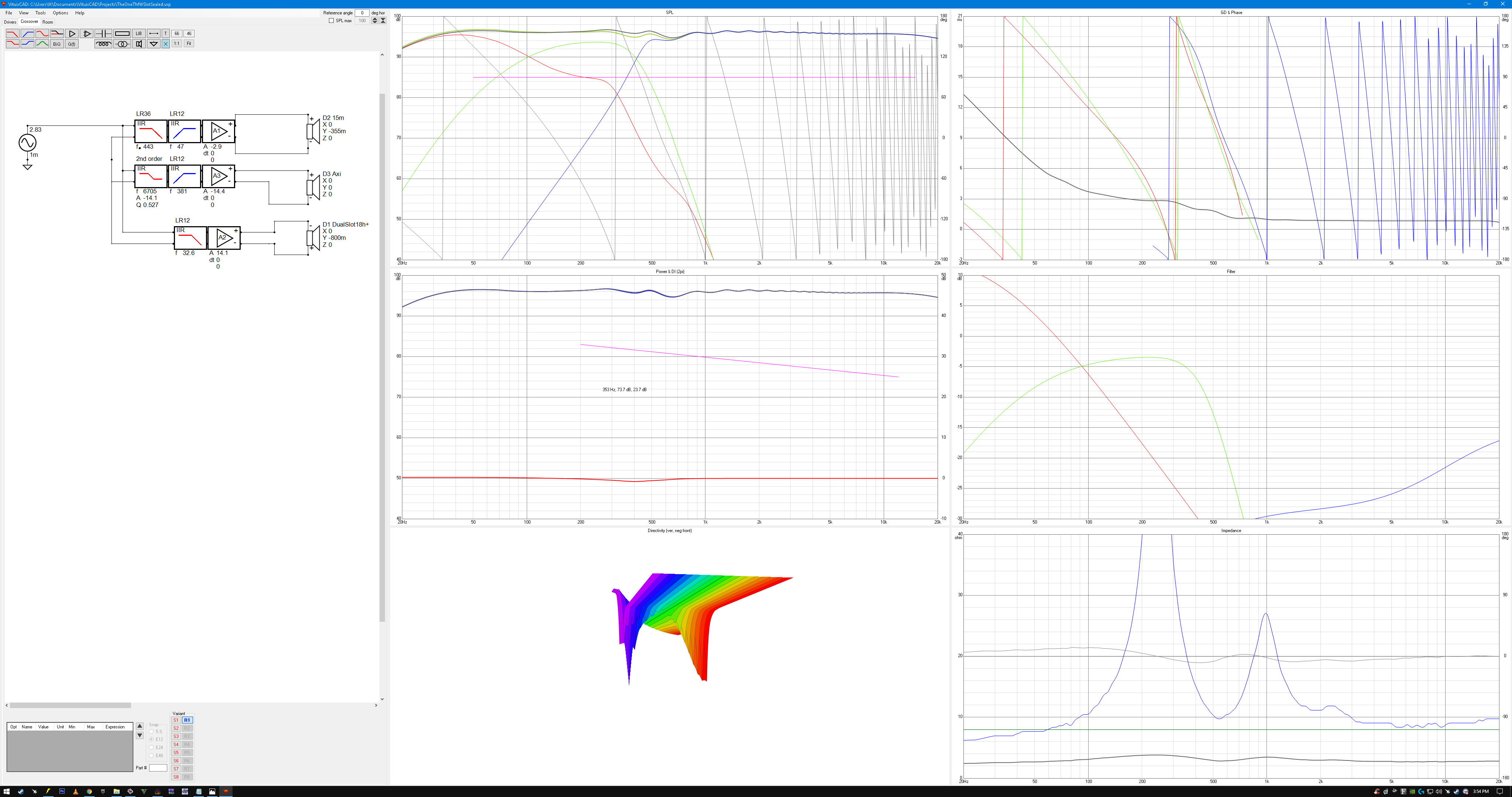

I didn't try a mock directivity model for the horn...was more interested in if I could make a decent looking crossing. Looks ok I guess. With the low pass shelf to create a flat response on the 350hz tractrix and a 381hz 2nd order LR the excursion remains very low even near 115dbit peaks around 0.12mm....

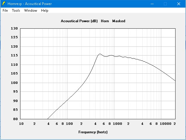

This is the unequalized response I got for 350hz tractrix but I don't know how correct it is.

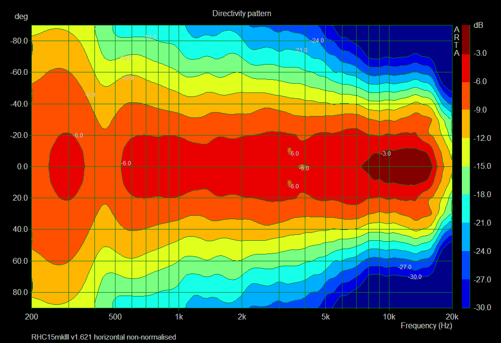

Mitch, as you undoubtedly know, this is true for many oldskool drivers, but not necessarily for modern designs.
The beam width in the top octave is primarily defined by the phase-plug and - if present - the the angle of the conical section.
Here's an example of a 3" diaphragm, 2" exit driver mounted on a short(ened) horn. The driver's exit angle is 34.7°.
Hi Rob, wow, that is impressive response in the top octave! What CD is that?
