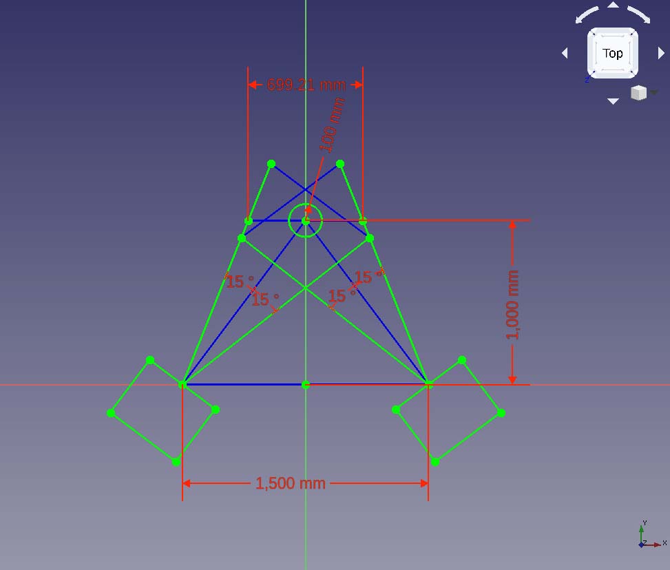

Can someone help me make this formula work?

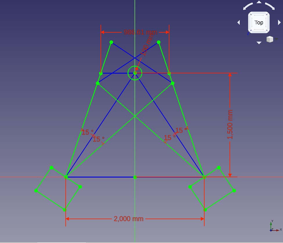

If we use +/-15deg w.r.t axis at 1.5m the soundfield width would be +/-1.5m*tan(15deg)=+/-40cm = 80cm wide at 14.5Khz.
Its one thing talk about beam width....the next level is to decipher the literally size of the window at 1 meter...I cannot get this formula DonK gave me, to work. It is likely a mathematical misunderstanding on my part. Looking at the solved formula for the 1.5m listening distance, at 14.5k, the window is 31inches wide lol...wheres all the beaming at? My heads not 31inches wide lol sounds like you guys are asking for gigantic unnecessarily wide sweet spots.

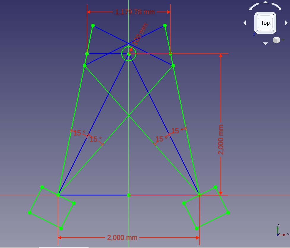

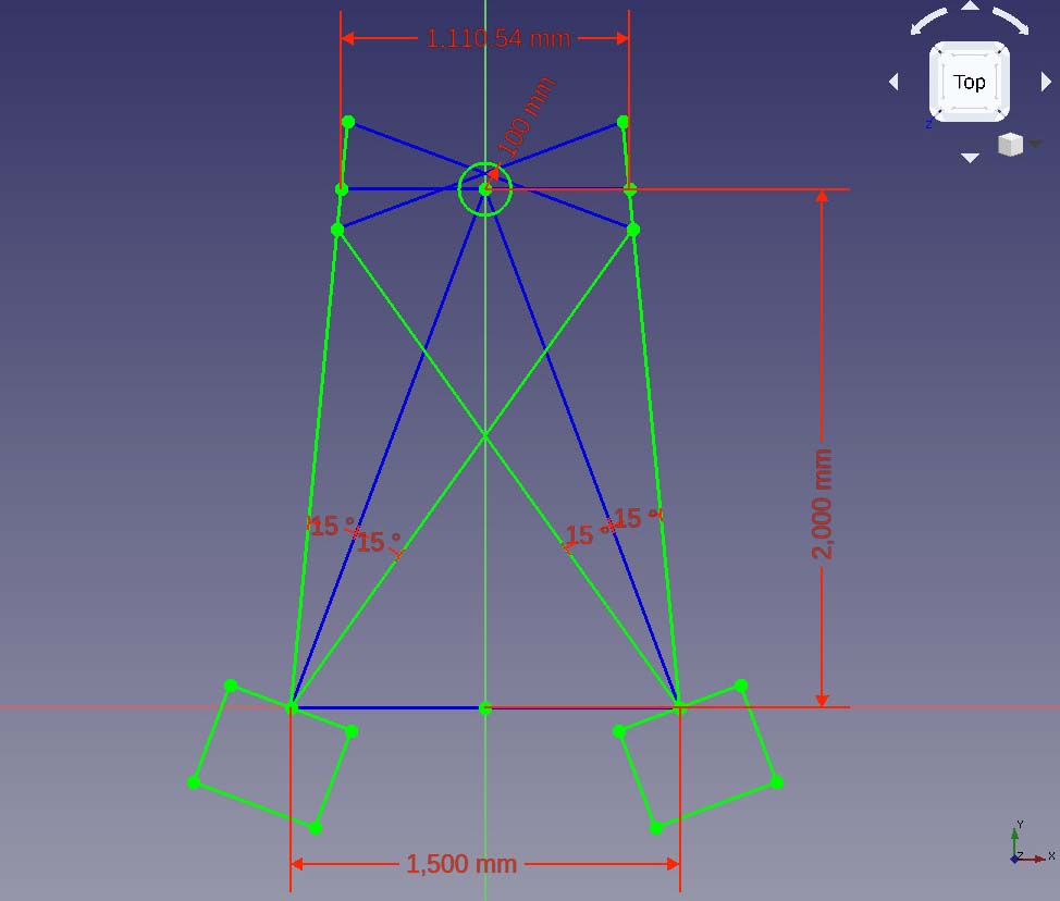

Can someone help me make this formula work? Its one thing talk about beam width....the next level is to decipher the literally size of the window at 1 meter...I cannot get this formula DonK gave me, to work. It is likely a mathematical misunderstanding on my part. Looking at the solved formula for the 1.5m listening distance, at 14.5k, the window is 31inches wide lol...wheres all the beaming at? My heads not 31inches wide lol sounds like you guys are asking for gigantic unnecessarily wide sweet spots.
It might be something as simple your calculator/spreadsheet is using radians (DRG mode) instead of degrees.
I made a few drawings with measurements to show the speaker beam angle (+/-15deg), the beam width, and the sweet spot width. The speaker axial center is always aimed at the center of the listeners head (circle). Wide enough for a single listener, but maybe not for a group of people.

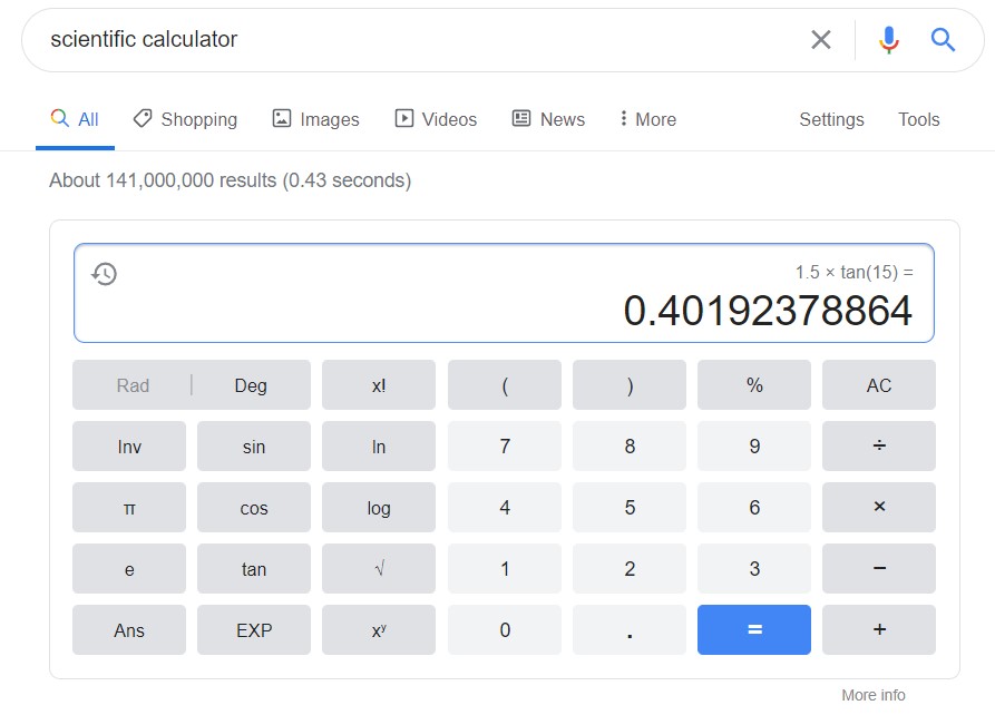

Edit: Don beat me to it. Here you go, google scientific calculator put it in degrees instead of radians then type 1.5 x tan 15 and you will get the answer in metres. There is your 40cm half angle. Change the 1.5 or the 15 to vary the distance and angle.

OK now we are rolling!!! I just had to change the settings to degrees as suggested... So in the future if we have a discussion about this supposed beaming...I'm bustin out this formula!
By intelligent coincidence, I once said that the polar shouldn't be any smaller than 15 degrees...this turns into 10 inches at 1 meter! Thats perfect as far as I'm concerned...
You don't seem to be grasping what "beaming" means. You could have a speaker with 90 degree beamwidth at 20KHz that would be beaming if the beamwidth at 2KHz was 180 degrees.
It is the narrowing with increasing frequency that the term refers to. If you want or are happy with a +/-15 degree window great. If it was the same beamwidth down to lower frequencies it would not beam.
The DI shows this the best. This needs some manual intervention to get out of ABEC so it isn't often shown.
The difference between what will be heard on axis and what will be heard or reflected back off axis.
Ok I see, its been explained before but for some reason I keep focusing on the window size....

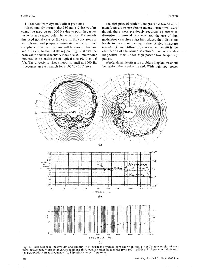

Narrowing directivity with increasing frequency is the fundamental issue. As fluid says, looking at the DI shows this best. Almost always, the narrowing directivity really increases in the top octave (i.e. 10 to 20 kHz.) It can be so narrow above 10 kHz the beam is like a pencil light width (1" diameter beam) focused at your ears. Move your head inches and there is a change in tone and a change in level. This is what is meant by "head in vice" listening position. Even with time alignment, I wonder how/what the image will integrate/sound like at 1 meter distance... Will be interesting to hear your results.
Very usefull input. Is it also because room reflexions ?
How to do for not having the problem when one moves his head at the sweet spot 3" inches left or right? Narrow sweet spot is a real pain for the pleasure of the listener...
How to see it at looking at a spl curve from 0 to 60 degrees off axis, please ?

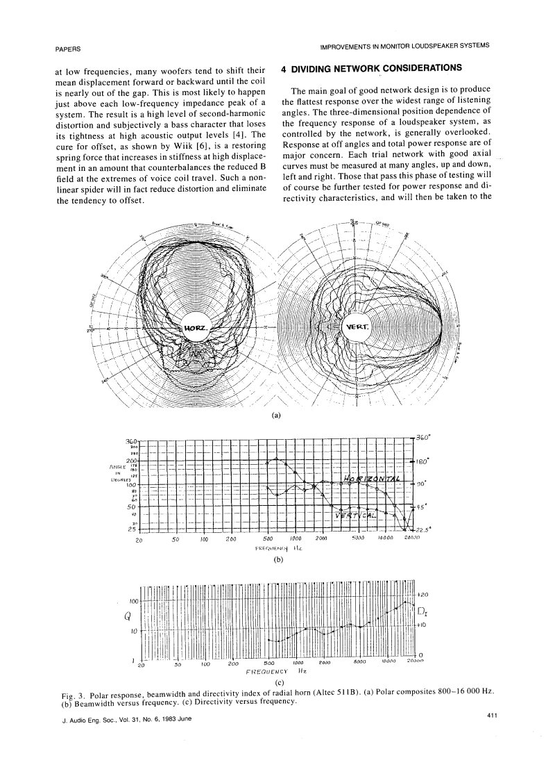

Your best bet is polar response curves and DI. Here is a 2344 CD horn vs a more traditional Altec 511 horn. It's really easy to see the beaming especially in the vertical axis. The 2344 horn has a much larger sweet spot and very stable imaging because of the very smooth and linear DI curve which craps out in the last octave as expected.
Rob :)
