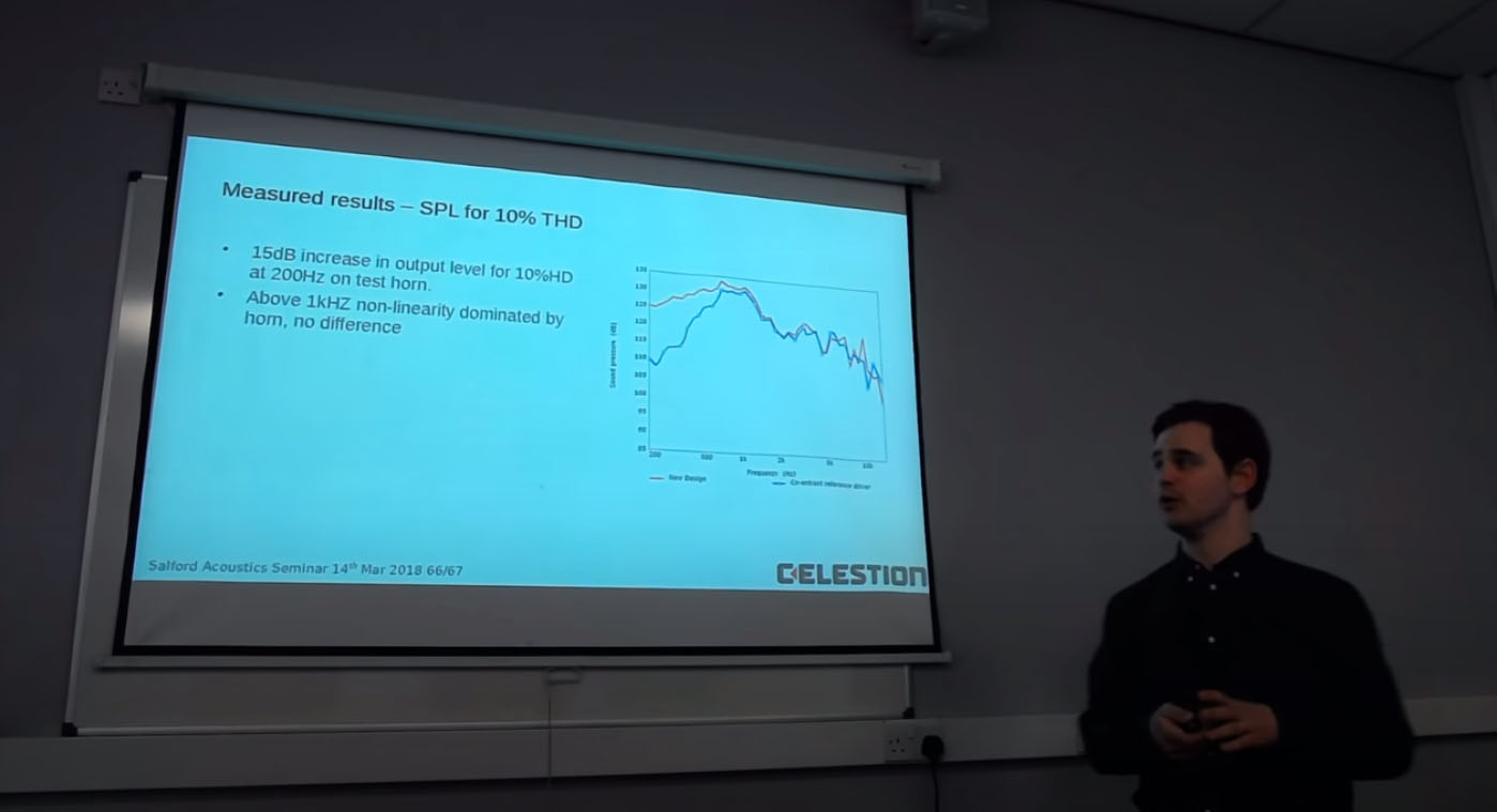

The FB Celestion rep says that the xmax is 0.5mm and that xdamage is 1mm...he’s working on getting the Sd.
If you love specificity, FB is probably not the best venue ;^).
Since the Axi2050 annular diaphragm at full excursion has no movement at the inner and outer edges of the Sd, you could figure displacement at roughly 1/2 of Sd multiplied by the excursion. However, the designer specifically mentioned excursion was linear to 1mm at the voice coil location, which conflicts with what you say the rep says.

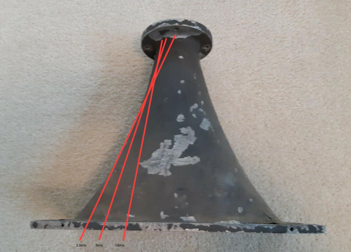

Looks like the HL26-50 TRIO is a plastic version of the JBL H5038, which appears to be the same horn AKA 2343 or 2395.
The exponential horn expansion results in a narrowing high frequency response approximately as shown in the image below.

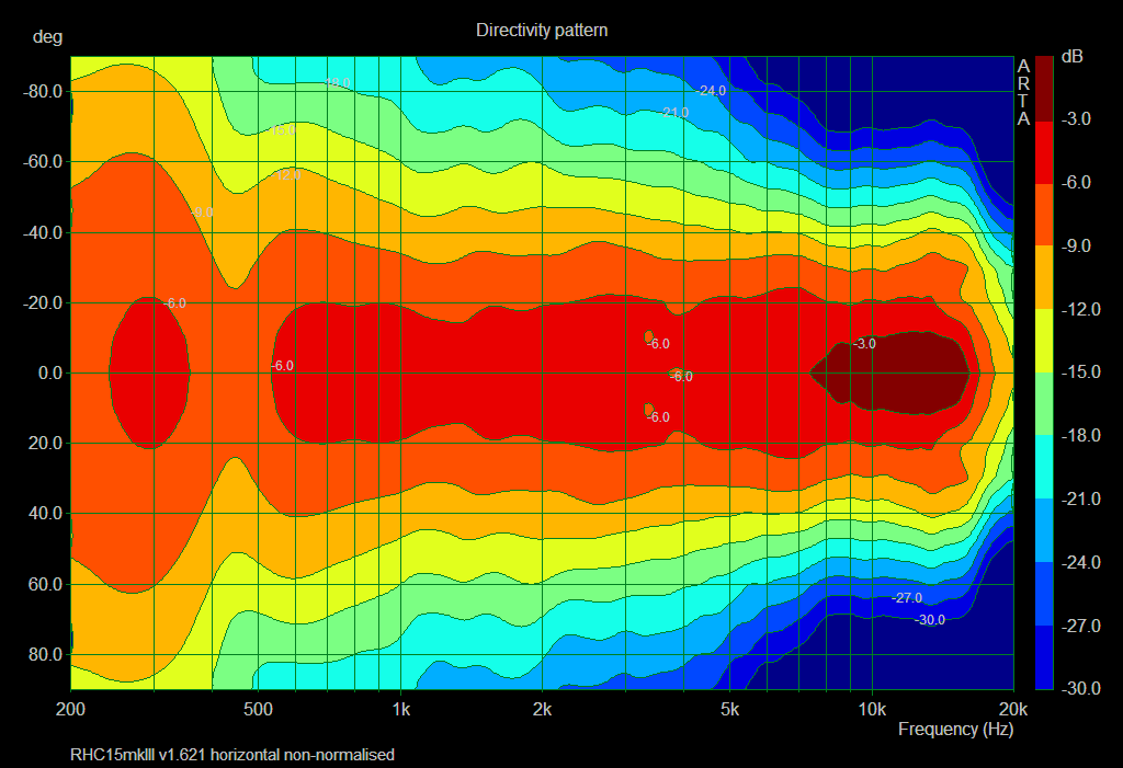

Narrowing directivity with increasing frequency is the fundamental issue. As fluid says, looking at the DI shows this best. Almost always, the narrowing directivity really increases in the top octave (i.e. 10 to 20 kHz.) It can be so narrow above 10 kHz the beam is like a pencil light width (1" diameter beam) focused at your ears. Move your head inches and there is a change in tone and a change in level. This is what is meant by "head in vice" listening position. Even with time alignment, I wonder how/what the image will integrate/sound like at 1 meter distance... Will be interesting to hear your results.
Mitch, as you undoubtedly know, this is true for many oldskool drivers, but not necessarily for modern designs.
The beam width in the top octave is primarily defined by the phase-plug and - if present - the the angle of the conical section.
Here's an example of a 3" diaphragm, 2" exit driver mounted on a short(ened) horn. The driver's exit angle is 34.7°.
