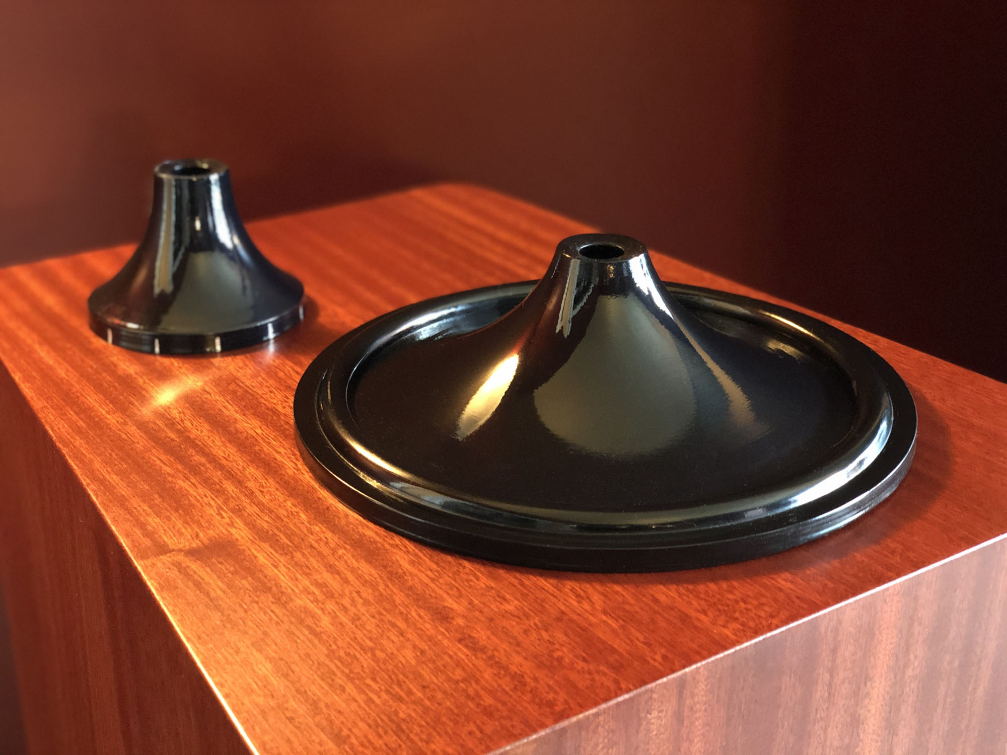

Maybe a tiny very open waveguide, just for the transition between throat (axis) and baffle.
Inspiration here: DIY 18" elliptical waveguide with a bigger throat and shorter (only the length of the foam swimming nodle).

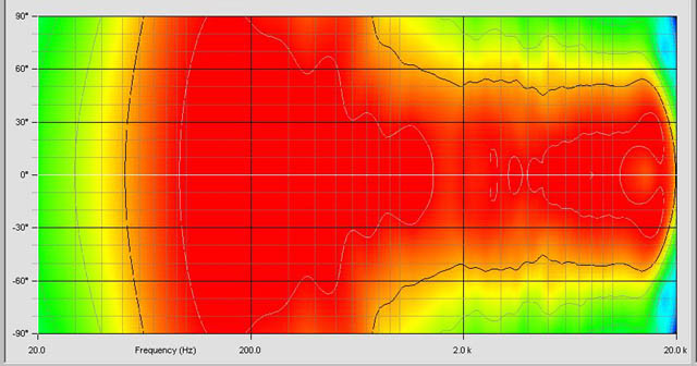

2446 Hornless at "comfortable level" (300Hz LR24 crossover which match with the natural roll off of 4" JBL CDs and 7.5khz XO to)
Brown curve is hornless (@50cm) and cancel a 2.5hz EQ I didn't remove.
Black curve is more or less what you obtain with a "big" horn.
At this level you loose 10-15db of sensivity
3rd harmonic distorsion is rising before 600Hz with this level (maybe you could expect the same with axi2050...or less?)
At moderate level this is ok but needs EQ if you want 400hz lo level. Below that there are 300hz XO and natural roll off so it's not possible with 2446 but should be ok with axi?
I didn't add of axis measurement because at 1m listenning distance it's not very important but it's constant directivity kind of (thanks to the diffraction)
Conclusion: with your 1m listenning distance and EQ it should be possible at "moderate" level. Adding a large but short waveguide (12" large and 4" length?) should help the transition between throat and air to avoid diffraction and to help smoothing impedance curve (which should be terrible hornless). Karlson tube should be another way to try.

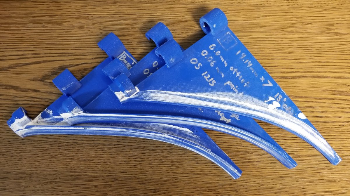

Camplo, if you're looking for an example how you could create the HVdiff, there's an excellent example how to create a mould using 3D printing in the full range section of the forum: https://www.diyaudio.com/forums/full-range/352790-creating-field-coil-driver-loudspeaker-5.html#post6218986
847558d1590479209-creating-field-coil-driver-loudspeaker-new_molds-jpg
My guess is you've already seen another option of using 3D printing to aid in horn creation (for symmetrical horns)... https://www.diyaudio.com/forums/multi-way/354772-acoustic-horn-design-practical-2.html#post6214298
846258d1590114815-acoustic-horn-design-practical-templates-jpg
