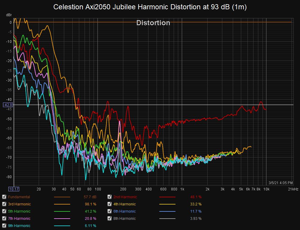

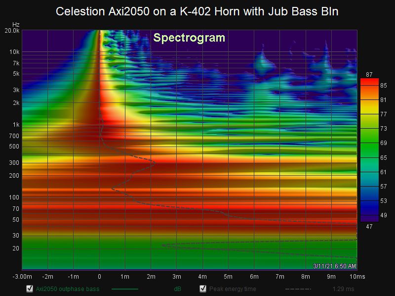

It's the Axi2050 used with an in-throat acoustic lens designed by Roy Delgado in order to improve polars above 6-8 kHz.
Even without the lens you can obtain decent pattern control from the K402 + Axi2050 as demonstrated by Cask05's measurements.

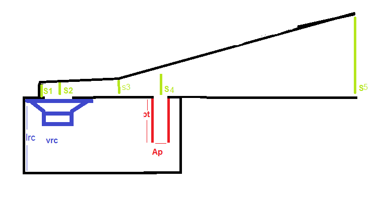

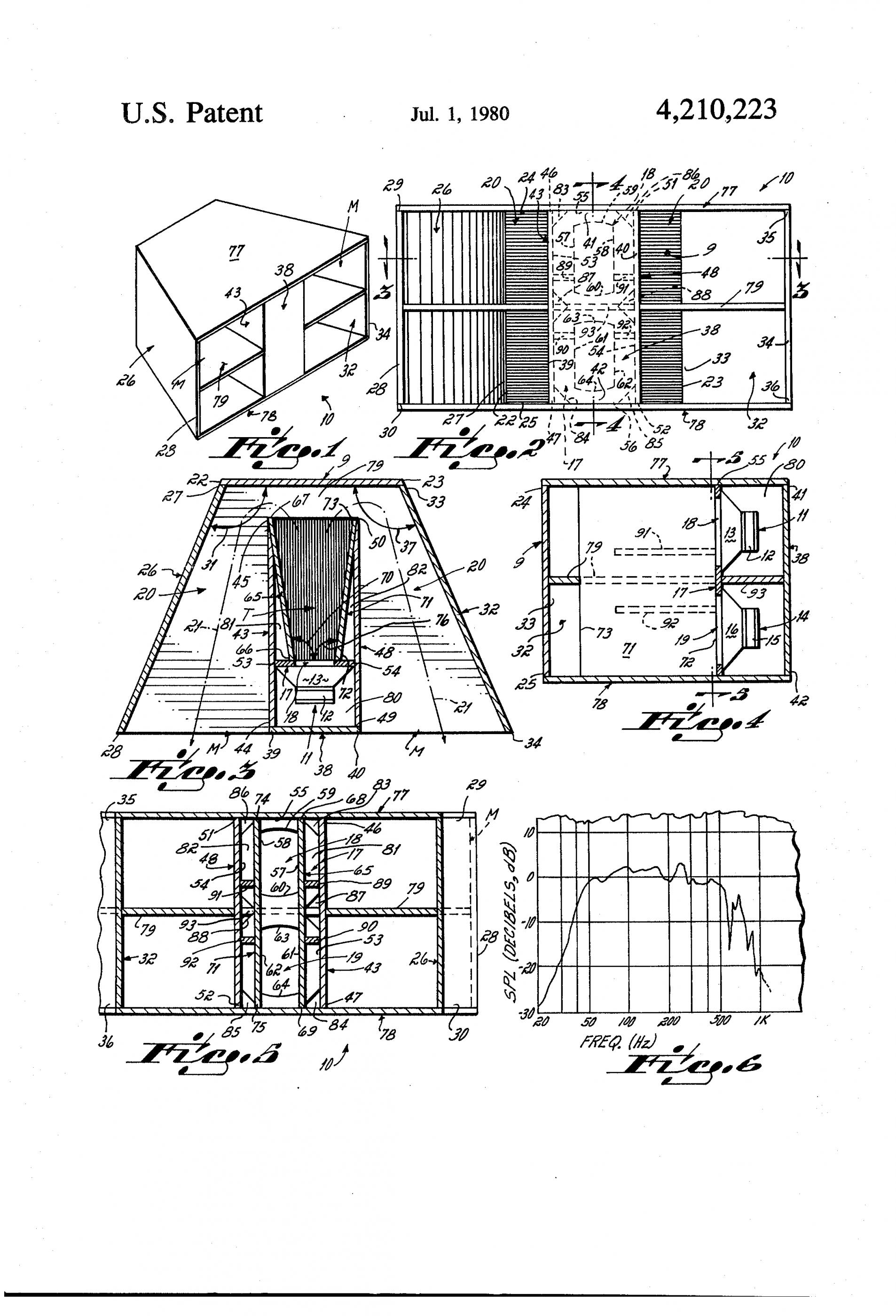

So this woofer/port firing into a line is not a new concept aye? hold on...when I choose ported rear chamber in the hornresp, for a front loaded horn, is this what its doing?
Very likely, although it seems best to leave this question to David McBean.

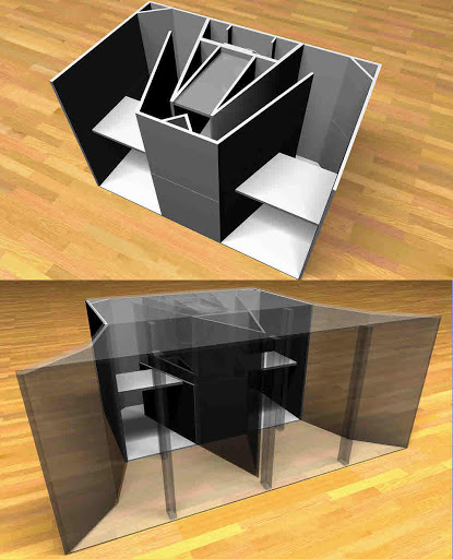

I like this reflex ported FLH by Inlow Sound.
This is different form the new Jubilee variant. There are lots of PA horns with reflex openings to the outside like the Inlow example. The Jubilee looks as if the reflex openings were radiating into the horn throat (which isn't new either). And it does somehow seem to lack a front chamber.

It's indeed different Charles and that's why I mentioned the Inlow horn.
A horn where the cone is not visible from the outside is in my opinion best used for reproduction below approx. 120-150 Hz.
In this regard I agree with Mark Kravchenko.
Perhaps this diagram explains the Jubilee bin.
I think the ports enter the horn at the same place (in terms of length or depth or whatever term one prefers) as the driver.
I have seen such a topology used within a horn-loaded PA sub of a German manufacturer decades ago.

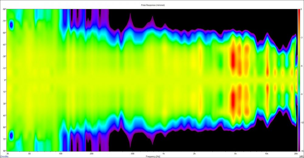

What kind of horn/waveguide was used for this measurement ?
Regards
Charles
350hz E-tractrix LMH out if Germany made them (can find them on fb or ebay)

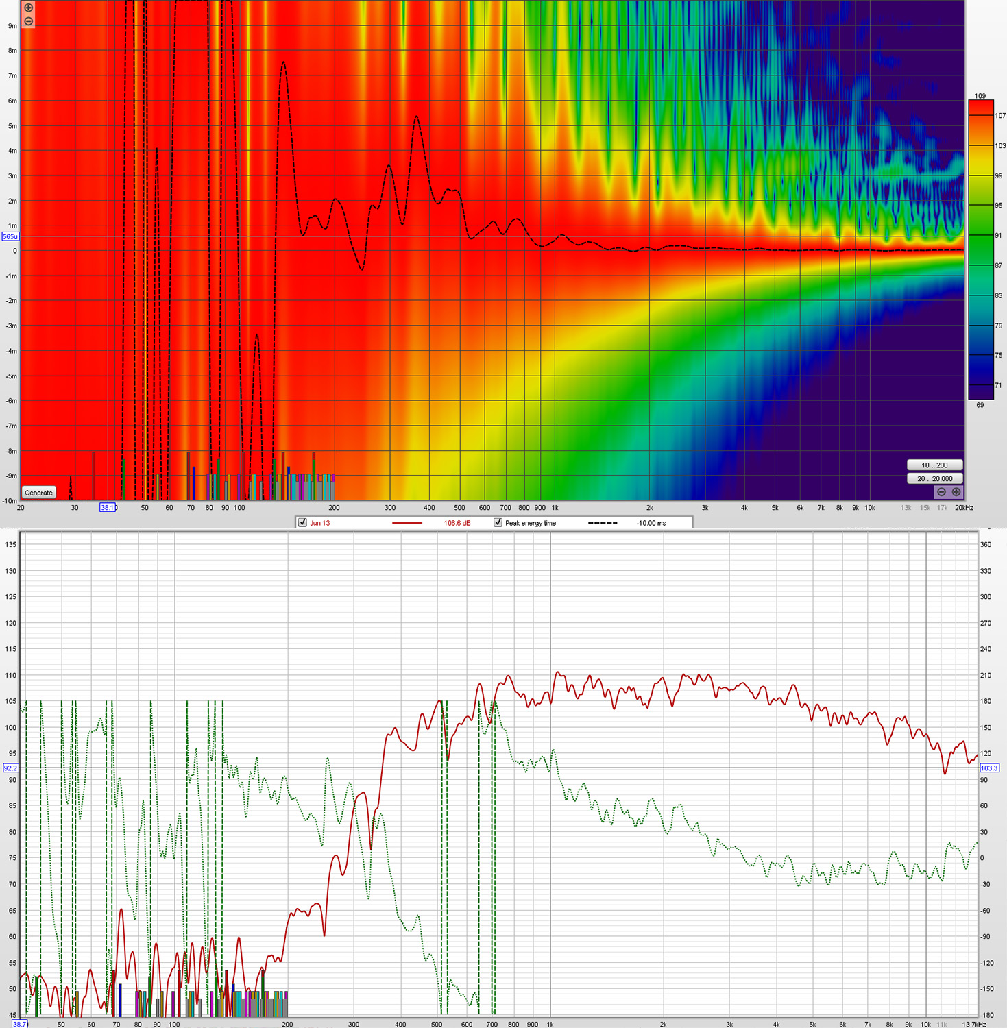

I was wondering… What do you guys think about the electro voice HP420???
1w 1m me holding mic (lol) I tried to mimic the spectral graph above.
Is this without any normalization? What happens beyond 14k? Where do you set the xo point with this horn?
I'll have to re-post the response when I get home I didn't notice and I clipped it at 14 kHz, sorry about that....the spectral is normalized I believe. Above 14khz the trend/slope follows to about 19-19khz then dives
i mean the frequency response curve. Is that the raw response without any normalization? There is a very even decay towards HF and it looks like that it could be done with a passive xover/eq to get the HF right.
I built 8 x 15" for PA use about 25 years ago, based on a discussion I had with the late Steve Hewlett of Fane Acoustics, the Void Stasys X V2 is also of a similar design principle. I posted the concept on another forum about 12 years ago, somehow Klipsch still managed to get a patent on it.
Oh ok, yes it is a raw frequency response.
