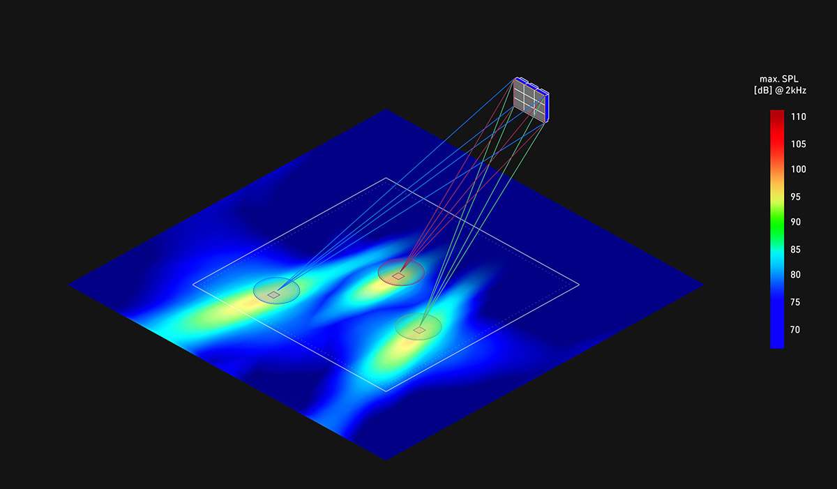

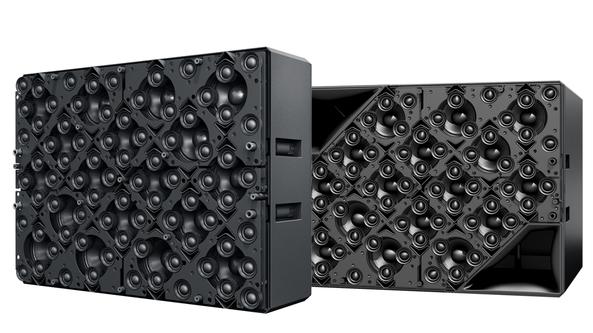

It somehow reminds me of Bateman's improved array and FollGott's Pseudo-Coaxial, as well as Holoplot's Wavefield Synthesis X1 Matrix Array.
Recently I have been studying similar beam steering systems in response to a request from a friend. He runs a bar that is partly located in 2 medieval vaults, the curved walls of which are also covered with glazed tiles. In short, the worst acoustic conditions imaginable.
Fortunately, research material is available from the groundbreaking collaboration between Rafael Guastavino Jr. and Professor Wallace Sabine.
The Holoplot beam forming and steering technology maybe the next big thing in audio.
I remember the first experiments in this field that took place in Germany (where else?
), around the time I became a member of this forum.
Participants included the Fraunhofer Institute, Humboldt University, AFMG Technologies, as well as IFAA-Akustik and Four Audio,
the companies of Prof. Dr.-Ing. Anselm Goertz, also the man who tested the Funktion One Evo-Series.
Dr.-Ing. Michael Makarski is a managing partner at IFAA-Akustik.
In short, the technique works like virtually placing a point source at an infinite distance behind the speaker array, leaving you with a near planar wavefront.

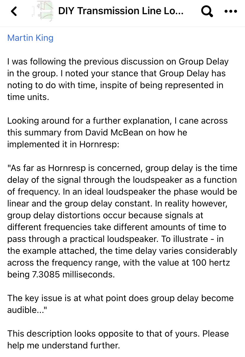

Someone started a new thread readdressing group delay using David McBeans definition from the hornresp manual, I believe, and King rejected it
The definition of group delay given in the Hornresp Help file is:
|Group Delay
Negative derivative in milliseconds of the loudspeaker system phase response, versus frequency in hertz.
Group delay is a measure of the rate of change of phase with respect to frequency, and is positive when the phase slope is negative.
If the above definition is not correct, then how is it proposed that group delay be calculated?

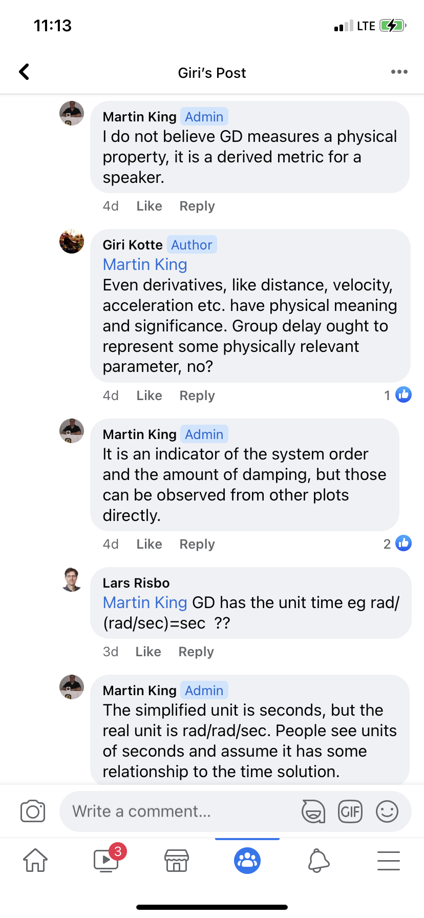

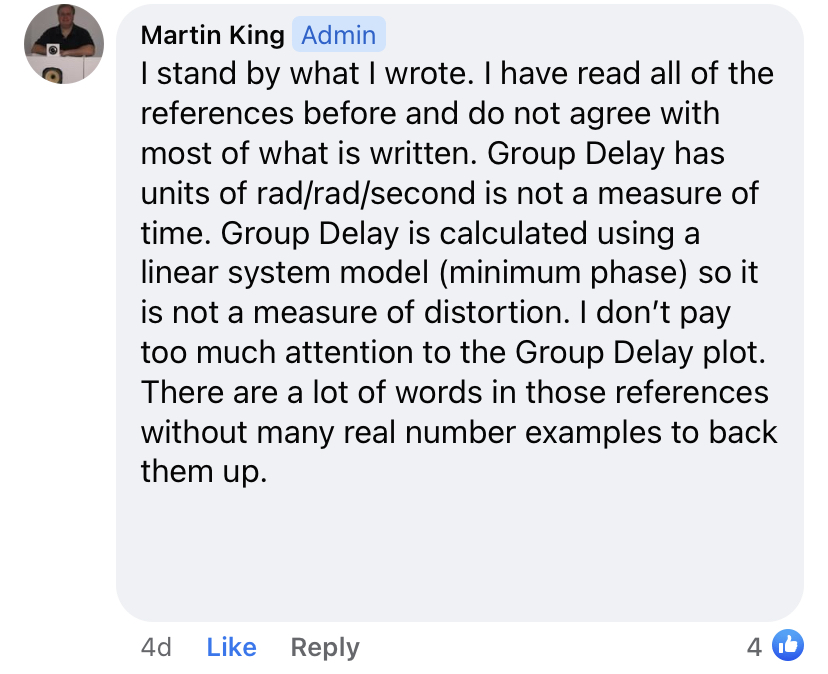

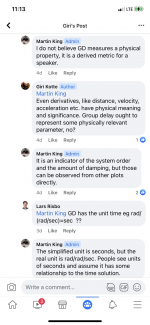

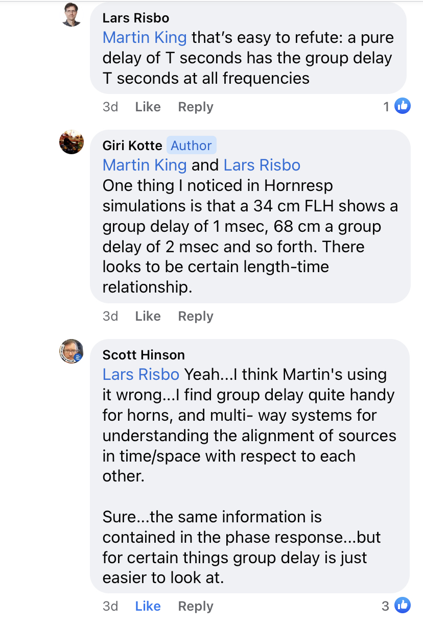

So here is the post that got me back on to group delay....
Havent heard back from Martin since this transpired, I can't wait to see Mr. King's response, I'm sure it will be juicy
The more i read discussions and articles about Group Delay, the more i think much of the confusion and disagreement stems from a simple starting assumption about what delays does GD include.
In my mind there are two delay components: fixed, and variable-by-frequency.
The fixed delay component is called many terms: simple delay, propagation delay, constant delay, time-of-flight delay plus fixed processor delay, etc, etc.
Imo, it makes no sense to evaluate GD with the fixed delay component included.
That seems analogous to looking at phase traces without their fixed delay having been removed.......you know, a grillion sloping lines.
Besides all fixed delay inclusion in GD does, is uniformly shift the entire GD trace up vertically.
The fixed component is easy to understand, and to remove from our measurements.
And for me, remove from consideration in thinking about GD.
Where things get trickier, is with the variable-by-frequency component, (Group Delay
What makes it tricky imo, is that some particular value of GD is included in our FFT timing measurements.
For instance, when we measure Delay relative to loopback in REW, with a Timing offset initially set to 0.0ms,
the Delay produced will be the sum of the fixed component previously discussed, and some particular time value of GD from some particular frequency.
That time value and frequency come from where GD is the flattest within the meat of the passband. Where magnitude is flattest, where phase is flattest, where peak ETC energy occurs...they all march together.
Imo, this is probably the only real value in knowing Group Delay, because it represents an apparent acoustic shift in our timing measurements, relative to simple fixed delay.
Iow, drivers with a low-pass will measure a little farther away, than distance alone would indicate.
Doesn't mean they actually are farther away, just means there is no way to mathematically describe them otherwise.
A proponent that I think is essential to recognizes, that is not focused exactly on phase, but its the point at which max spl is achieved, in relation to the original signal.
