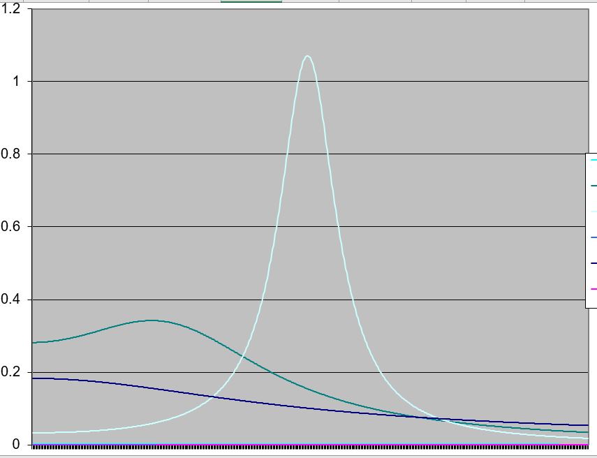

Sorry for coming back to group delay. I undug my excel spreadsheet that I once made for the the dimensioning of group-delay equalisers in order to show where the comparision between loudspeaker group-delay and most group-delay studies falls short.
The green curve shows the group delay of an LR4 (basically the GD of a 2nd order allpass with a Q of 0.71). The white curve is showing the GD of a high-Q 2nd order allpass like they are used for most GD audibility tests. The main difference is that these high-Q allpass filters have high GD values over a small bandwith but very low GD at low frequencies and falling towards zero at very high frequencies.
So the perceptual studies are mostly about peaking group-delay within a narrow frequency band while the typical loudspeaker crossover has high (and quite constant) group-delay at low frequencies and low group-delay at high frequencies. The only paper I have seen that is dealing with the typical crossover-cause GD is a recent one from Finland. I willl cite it when I have found it again.
Regards
Charles
P.S.: The dark blue curve is from the 2nd/3rd order crossover that I personally use when it is dimesioned for the same crossover frequency as the LR4. Its GD distortion (difference between the highest and lowest GD value is only one third of that form the LR4).

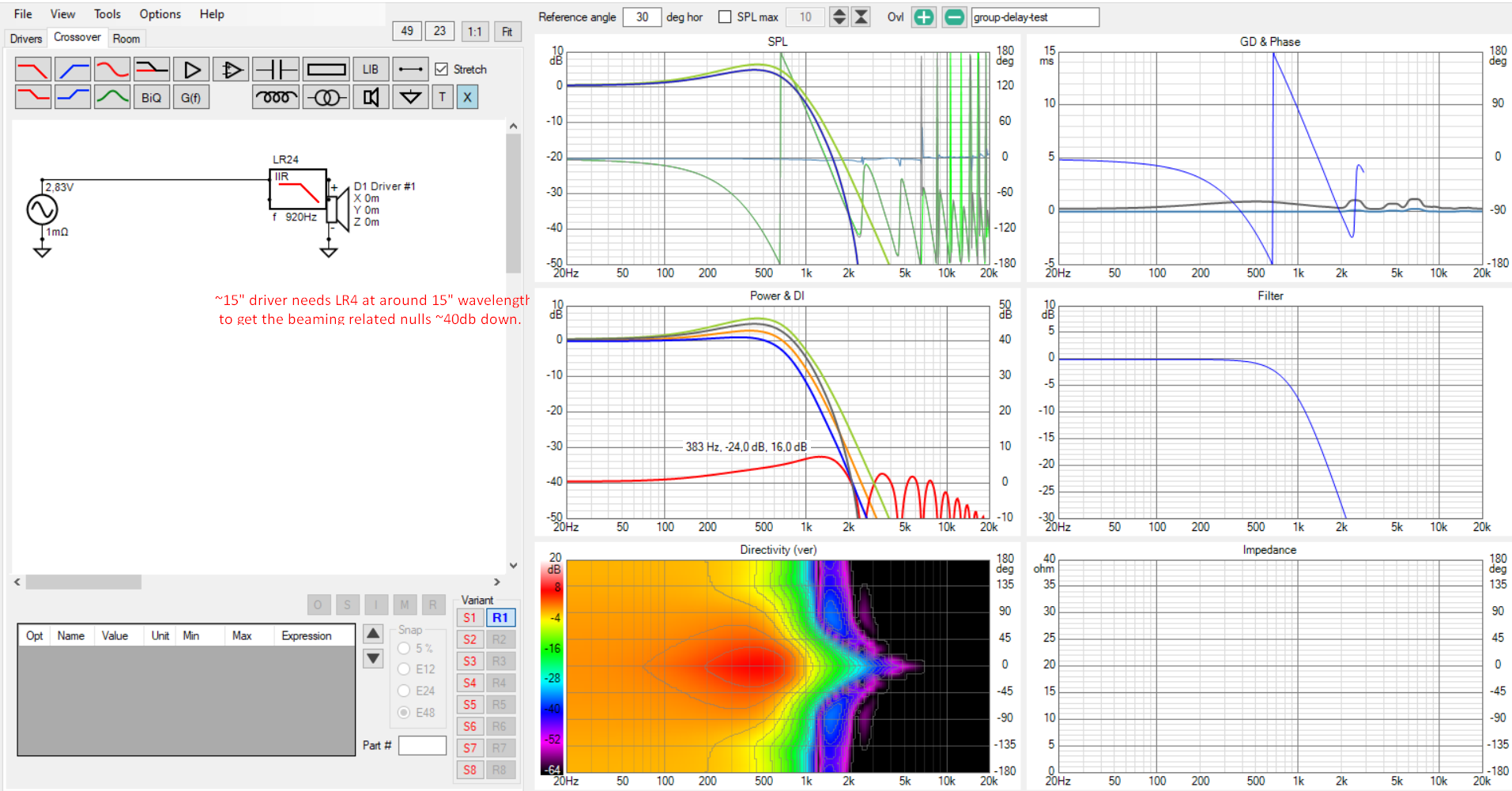

I've recently noticed crossover region can also have peaking GD at off-axis angles due to transducer size and resulting beaming or self interference or how'd ya call it. It depends crossover frequency and slope how attenuated signal is at these GD peaks and it seems LR4 at wavelength ~= driver diameter takes these about ~30-40db down inside listening window. GD peaks move lower in frequency the more off axis one goes until 90 degrees.
Attached is ideal driver simulation but some smaller GD peaks were in my measurements as well. I've got no idea if these are of any concern. Just an observation.
First attachment is simulation of ~3" driver at 30 degrees off-axis and some 1ms GD peaks at high frequencies are seen at interference nulls.
Second attachment is ~15" driver at 70 degrees, 3ms group delay peak at 1.5kHz wowza.
Third is a filter test.
Listening window SPL is roughly 40db down at GD peak frequency with the filter. Listening window in the simulations is +-30 degrees from the reference on horizontal axis and +-10 on vertical axis. Listening window is the light green trace on the SPL and Power&DI graphs.

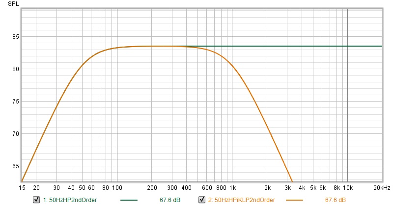

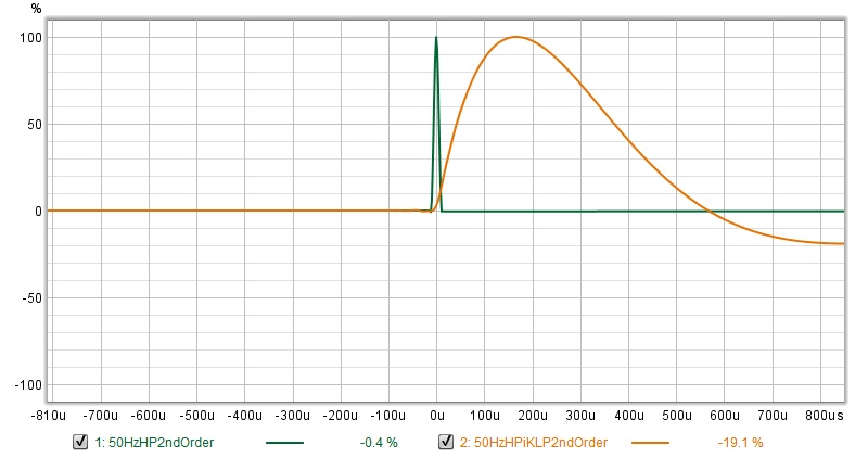

What about phase then...
I think you are confusing phase as it relates to a wave and measured phase of a speaker. Pattern flip is not a good term to use as it means something totally different in speakers.
Wave phase image
attachment.php

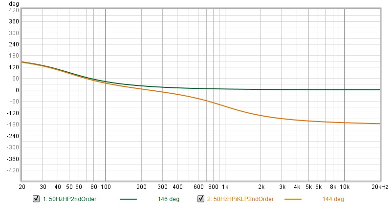

The change in measured phase of speaker is either due to bandwidth limitation or crossover.
Here is an example of a theoretical woofer. There is a 2nd order rolloff at 50Hz to simulate a sealed box and then either no lowpass or one added at 1K. When there is no upper bandwidth limitation the phase changes 180 degrees over the bandwidth 0 degrees at HF (no rolloff) to plus 180 at DC
attachment.php
When the upper bandwidth is limited with a 2nd order low pass at 1K there is 360 degrees of change from -180 to plus 180.
attachment.php
This the the difference in the impulse response due to the bandwidth change.
attachment.php

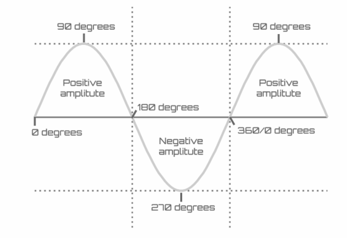

I can relate this to tracking the movement of the woofer, for phase or group delay....this would be the best kind of visual reference, even better if animated...seeing is believing.
attachment.php
So where were we? 200hz and -90 degrees.....is that the 270 mark on the graph here? So the phase response measurement if 200hz -90degrees...what does this mean in relation to when the woofer takes flight.
When in time and were is 0? 0 has to be when the signal arrived....the woofer will be at 0 for this example....the measurement says -90 phase angle for 200hz....so the rate of change at 200hz... (1cycle/200hz) * (-90/360) = -1.25ms...it takes the woofer 1.25ms to reach where on the graph?
I have to be able to visualize this
All I want to know is how long it takes the woofer to start moving at each frequency....I think unwrapped phase is the backdoor...
Regarding Martin Kings response...I'll have to look at the formulas and do the comparison at the same frequency to make it makes sense to me. The period size changes with frequency so that variable throws me off...

As I said the measured phase of speaker and the phase of a wave are not equivalent which is where I think your confusion is.
It will take 5ms for a single cycle of 200Hz regardless of the measured phase. 1000(ms) / 200(Hz) = 5(ms) to be at the 270 degree point will take 3/4 of 5ms. There can only be a -90 when comparing relative phase or go back in time.
Camplo, you appear to be thinking about phase as it relates to a sine wave going through a single driver. That ain't it at all.
Phase is the relative timing of frequency vs frequency across the spectrum.
Perfect phase is when are all the frequencies rise together from a starting 0 amplitude at the same time.
A sine wave through a driver is simply described by polarity....does it move out, or in, with a + signal.
