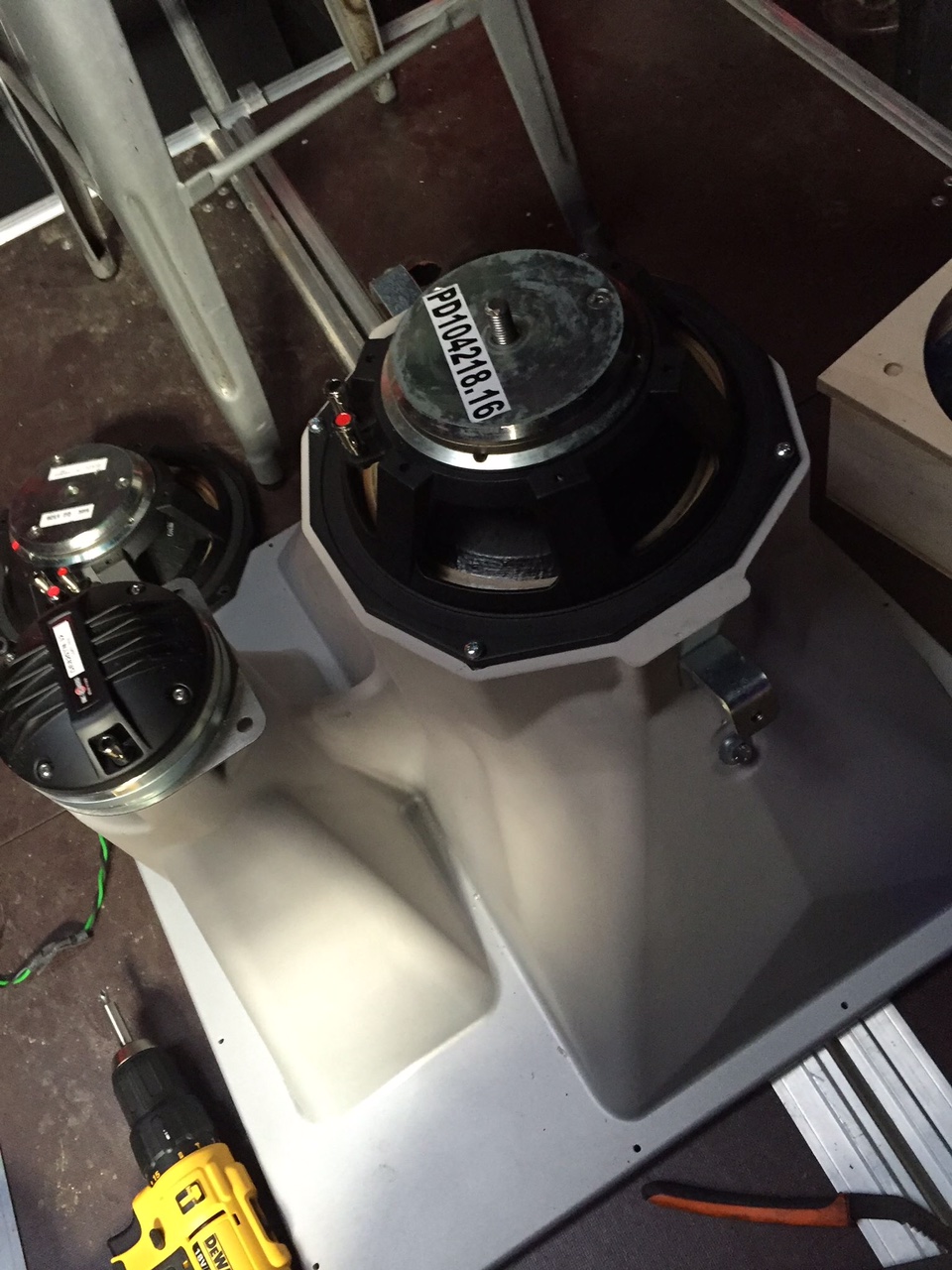

In the light of simplification and harking back to a brand discussed earlier, here's a review from a reputable German pro audio magazine that I came across recently. It is not a pure 2-way system, but a mid / high horn top (the core) with 1 or 2 segments for bass reproduction.

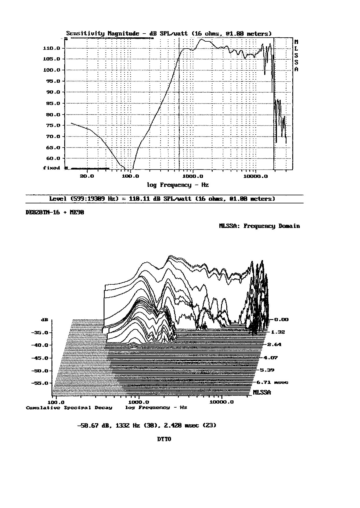

honestly seems like a bit of a joke. they say there are no glaring issues in the measurement. what about that HUGE notch above 10k.... or the so-so polars.

Regarding the test of the Funktion One Resolution 6, the skeleton horn tops are often used in pairs that are pointed at the dance floor. As can be seen in the test data, a uniform radiation pattern is thus obtained over a wide angle, whereby the integration between the woofer and compression driver is improved.
Cynics will undoubtedly argue that polars of brand X or Y are even better, but the average club attendee tends to judge a sound system based on completely different characteristics.
The dominant position that Funktion One has occupied for years in the lists of best-rated clubs(ystems) doesn't come out of the blue.
As for that notch, it's the breakup of the B&C DE820TN, which looks worse in the plot than it actually is in terms of audible resonances. It adds some sparkle to the treble.
