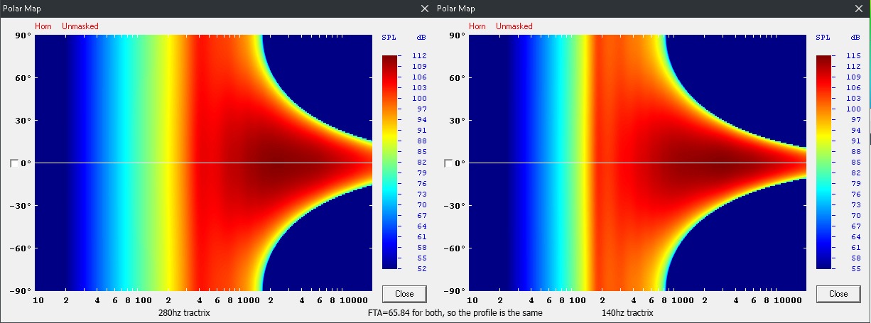

Hello CamploWhat I don't understand is why a 30inch wide horn should loose pattern control at 370hz yet the jbl 236X series all claim pattern control to 200hz....All the plots show about a 130-110degree pattern at 200hz and rising DI increasing above 200hz..is this inaccurate info from Jbl? Seems like every above a 370hz or so would be at 180degrees....
They claim full horn loading to 200Hz and there is directivity control you can see it in the beam width plots. If you look closer they start really "working" at 500Hz and above. Closer to 1K on the 2366. This is where the claimed vs actual pattern control lines up. This make sense as in actual use 500Hz would be where the crossover would be. These are real measurements not simulations.

Also what with the posted plots for the 140hz vs 280hz are those simulations of your horn?? What are you using to determine pattern control?? -6db point so the contour from say 115 and 109?? on the 140Hz. Can't you plot them without the dead space out to 10 hz and change to say 200Hz and up???

Increasing the length narrowed the wall angle (as much as there can be one in a profile like this) which is why the high frequency directivity is now narrower.Heres at least the two horns polars I wanted to share...

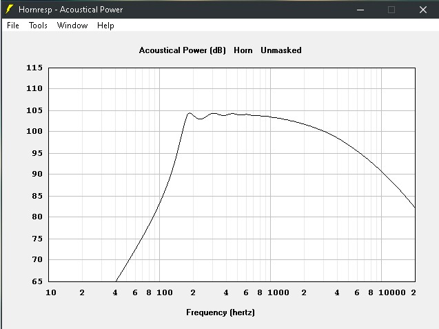

I tried to find polar maps and FR/impedance measurements, no luck yet. The 2365 and 2360 likely do not load to 200hz, it claims 350hz loading at the top of the article but it gives 350hz minimum XO for those horns ( then it says 300hz minimum use) ...The 2366 listed 200hz lower use limit, 300 lowest XO (lowest xo used with jbl 2485 rated to 300hz).... The 2366 is also 54" long. The other 2 are 32" long....My tractrix is 36" long and loads to ~150hz
Proper Xo would require at least a cutoff 1.5-2x under desired Xo, isn't that the general consensus?
140hz vs 280hz are those simulations of your horn?? - Horn Resp sims
What are you using to determine pattern control?? - Horn Respsims
Can't you plot them without the dead space out to 10 hz and change to say 200Hz and up??? - 10hz and up or 1hz and up...I put in a request to add option to change spl scale to -25db =)

A quick example; again assuming a constant directivity horn profile - your 30 inch mouth dimension sets a loss of pattern control at 370 Hz, if you’re aiming for a 90 degree nominal coverage in that dimension. If you’d prefer 60 degrees coverage, to keep sound of the walls, then the loss of directivity occurs at 555 Hz.
For the 60 degree example, at 300 Hz your 30 inch mouth dimension would give a coverage angle of 110 degrees. Aiming for narrower coverage in that dimension using multiple LF drivers would create an inconsistent polar pattern, and by nature an inconsistent set of reflections that would affect the CTA 2034 measures.

Simply stated a horn such as yours is probably imposes a 4th order crossover in itself at cutoff. With the intrinsic cutoff of the horn at 150Hz and the electrical cutoff 1 octave above that it's not going to be a true 2nd or 3rd order, or whatever, filter.

Does the slope of filter matter? a 48db filter at 300hz isnt going to be true? I can only speculate because I have not the actually response to play with....I do have this FR to play with...my best guess AxiSim with a round tractrix sim about the same width as my e-tractrix horn lol....the ballpark way

Leaving aside the issues of the Yosemite Halfdome filter, your acoustical filter will be a composite of the two, horn cutoff and electrical. I suppose at some point the added effect will be moot but you still have to make the woofer hand over nicely. I would look at it the other way, you have free slope from the natural cutoff, work with that and don't try to beat it.
Is that a thing!? I was getting wind of this from some of my readings but my first thought was that something would be wrong with excursion...time to look at horn resp.....wait a second....are you suggesting to layer an electrical filter on top of the mechanical one.....or to not use an electronic filter, period lol....
You need to combine the two. An example from the TAD cookbook as used in their pro 1601/4001 passive two way is to use a 6th order slope for the bass and a 2nd order electrical for the compression driver/horn to compensate for the Z offset and hand over nicely.
