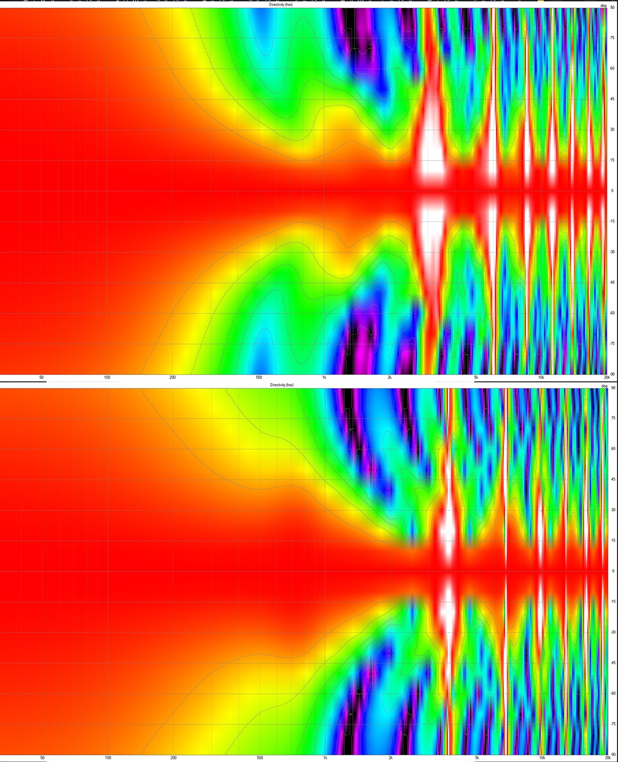

Horizontal Polar mismatch to the horn with dual woofers...final answer lol...how well does it have to match...what if it matches at 30degress but not at 90?

The nulls you spoke of exist where exactly on the above graph? If I understand you, I don't won't any crossband higher than 600hz.. But if I look at the polar at all widths...it doesn't look like I think it should, for a good xo, that high anyway...revisiting it after looking at the right polars.......600hz is way more directional from the dual woofers than it is the horn.

This does not seem like realityWhat this makes me think of is the polar pattern of the next driver in line....the driver below the horn has similar directivity at 555hz and 370hz....if I cross at 555hz the pattern goes from 60degrees to 90degrees...if I cross at 370hz I go from 90degrees to 90degrees, and the pattern is still 60degrees at 555hz....
No the most directivity you can have is to cross the horn to the woofer around where the patterns match (if there is a frequency where they do).So if I take the horn down till it looses directivity, I will have the most directivity I can get....which makes sense if the horns mouth is the same width as the baffle....at ~30" width, baffle vs horn mouth, the axial length and wall angle creates more directivity
The gain in directivity from the woofer at that point up offsets the loss of directivity from the horn going down and allows the higher directivity of the horn to be maintained to a lower frequency when the two are combined. This is what Earl does with the Summa and what most large two way designs aim to do.

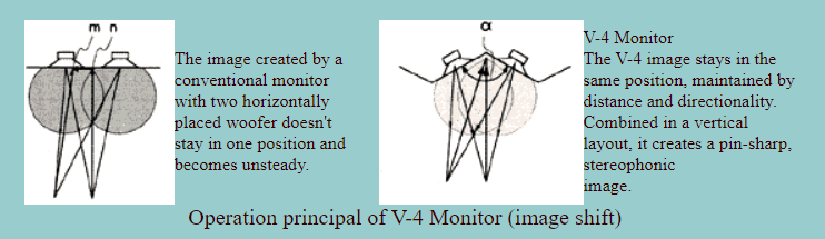

This image from the Rey Audio WARP page has a good visual on the difference between the mounting options of side by side drivers.
Angled inwards seems perfect for someone who wants to bathe in a field of direct sound
Get 4 on the go with a big Bi-Radial and you can have yourself Avtar D at home.

Sim by Vituixcad, 32x17 baffle with 15" woofer in the middleThis does not seem like reality

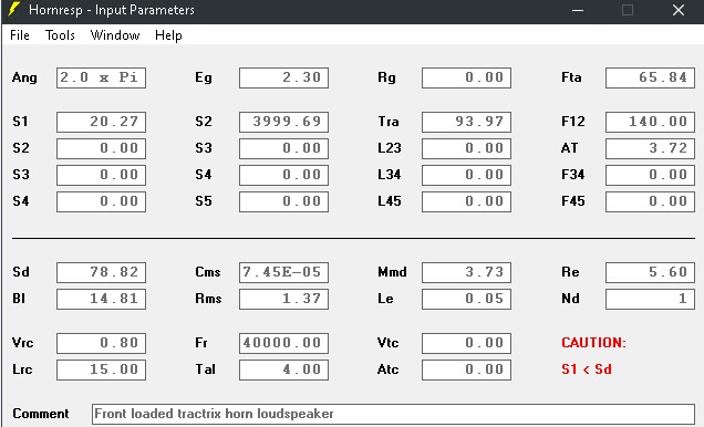

Sim by Horn Resp
Witch is exactly at the same point that I suggested I'd get the most directivity, how convenient, and uncoincidentalNo the most directivity you can have is to cross the horn to the woofer around where the patterns match (if there is a frequency where they do).
The only issue is those numbers, I think I had single woofer in the sim instead of a double. At 555 there is not a good match, dual woofer to the horn...Actually most of the territory I'm hunting for is suspect. The dual woofers seem to have higher directivity all the way down to 300hz even....
Trying to help you is as much fun as slowing down a chainsaw blade with your hand.Witch is exactly at the same point that I suggested I'd get the most directivity, how convenient, and uncoincidental

Moving forward...I don't think I have a polar match using side by side woofers vs the polar I'm getting with Hornresp....I can't see letting that go so I unless I can convince myself to move the tweeter axius from being almost directly at my sitting ear level and about 6inches higher to accommodate 3 large woofers on the front baffle....I'll be sticking with the design as is
