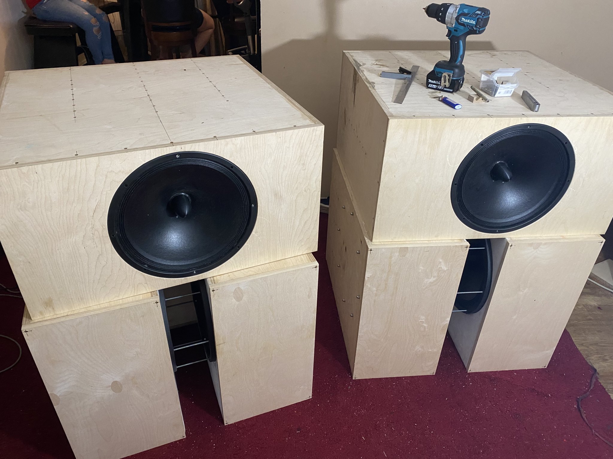

Im not making excuses....but hear me out, I have more ideas to be criticized
so those 2 boxes are like 43" tall...all volume I need for dual 15" is there, with enough room for the dual 18"s yet...
Merging the boxes from 2 to 1...I could put 2 vertically stacked 15"s on front....burry the dual 18"s on the bottom and towards the back...then create a vent from the burried 18's to the front, bottom, remaining 13"x32" baffle
crazy?
crazy?
