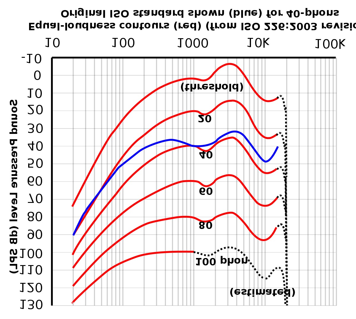

That 'Depends'. Pun intended.Lol you guys are a good time... isnt high spl and hearing a topic of frequency also? 115db at 30hz isnt as dangerous as say 700hz? Correct?

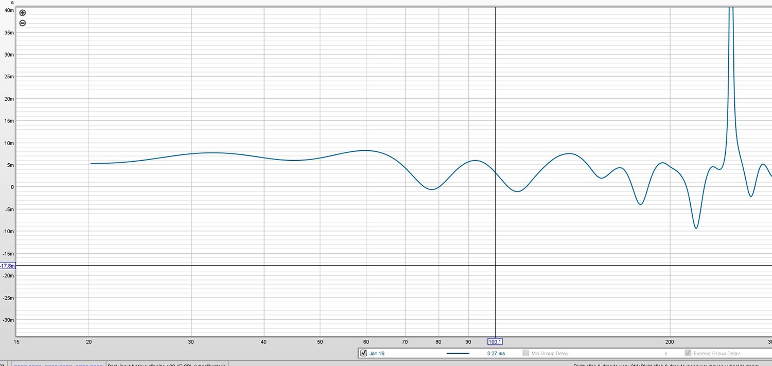

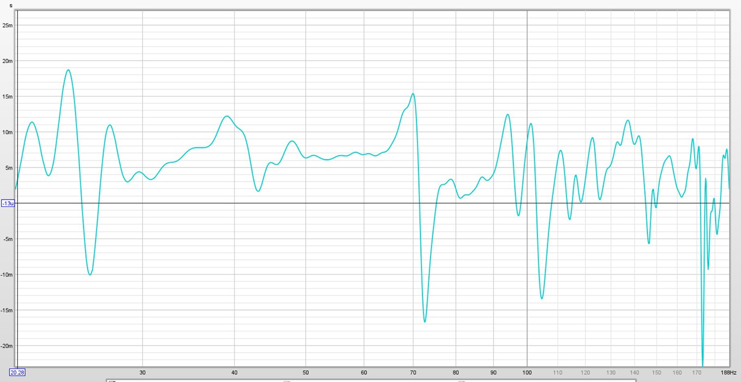

I'd like to provide some humor....I spent the last day under the impression that my measurements were correct....
I made a change...I added a top baffle to complete the slot, for proper measurements....somewhere along the lines the mic choice switched...Ive been starring at measurements from the labtop mic scratching my head... I even started working on the crossover in vituixcad 🤣🤣🤣
I was like "well it's within plus +/-2.5db....
They warned me about putting it in a slot"🤣🤣🤣

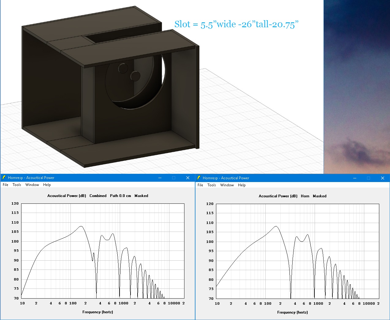

The more direct energy/directivity.....the less colored the FR, will be, by the room. But how low can this effect be had at a measure that mattered? For example with my wide 32" baffles, baffle step is around 140hz....so above that directivity is much stronger....and below that, the direct to reverb would be no more or less, equal, to a baffle, half the size? Or does the wider baffle still have a degree higher direct energy in comparison to the half width baffle at low bass frequencies like 100-50hz?
Sort of. Remember, each line on the F/M chart is like a frame on a film strip; it is not until we “run the film” (re: examine the delta between subsequent lines) that we understand what it is it is telling us about our hearing with regard to acoustic amplitude.

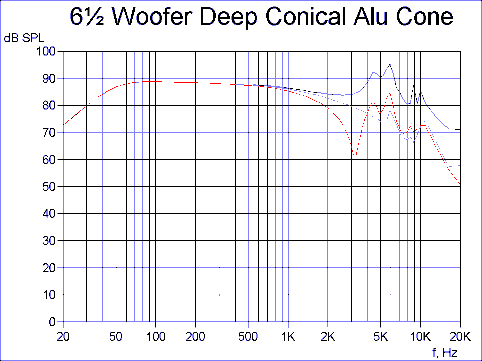

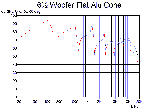

Ever heard about geometrical stiffness?The frequency of beaming depends purely on the size of the speaker.
How this is beaming (the DI, directivity index) depends a little on the cone shape.
Although the majority of speakers kind of use the same shape for that.
What you're talking about is cone break-up/roll-off.
Which depends mostly on the inductance (or the lack thereof with demodulation rings) and mass of the cone.
Any other effects, like local resonances or surround-dips, might sometimes disturb the response as well.
