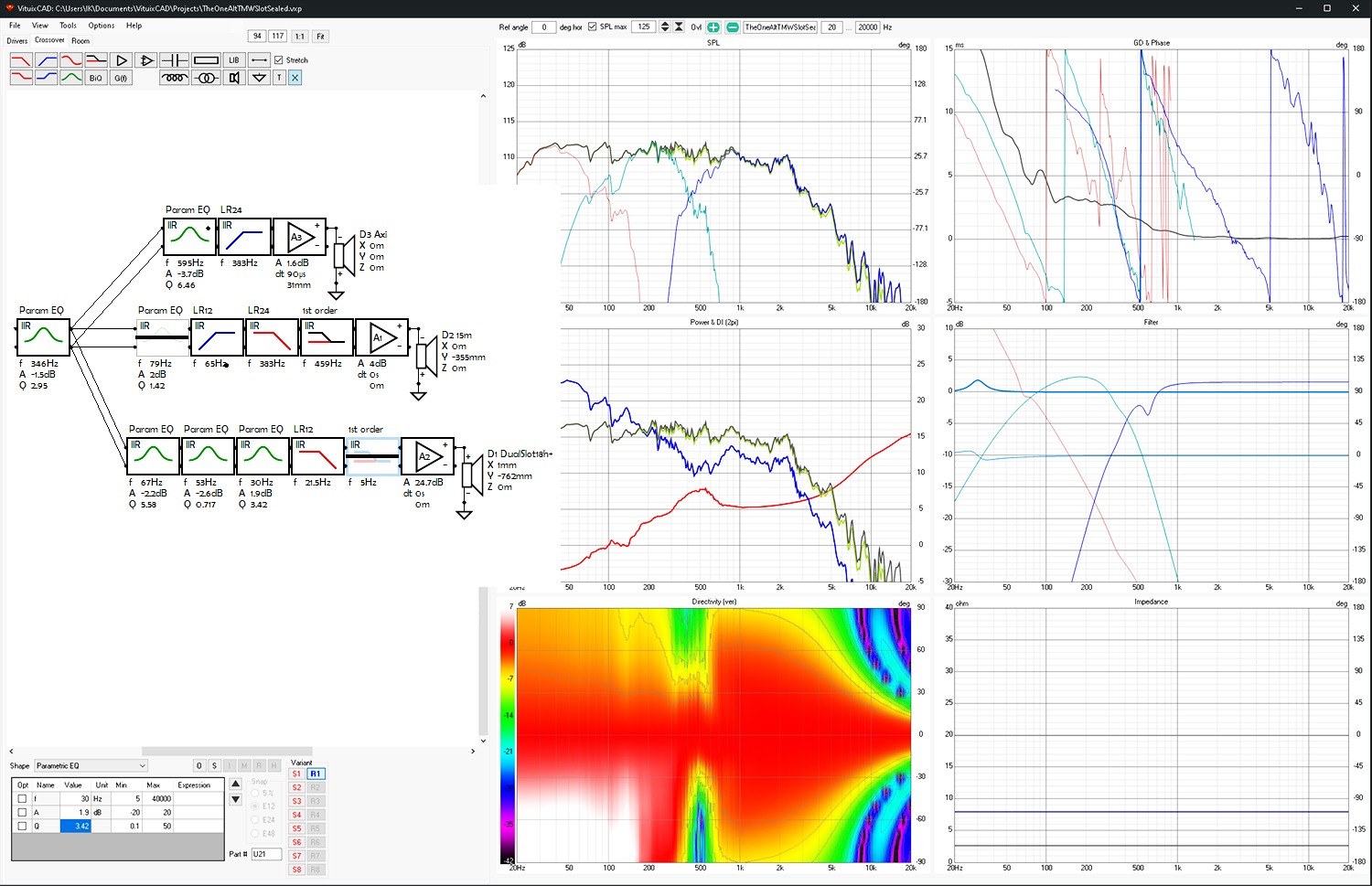

(The pic actually includes an allpass, on the lower woofers. In XO pic its showed, as turned off.....with it off, GD is better (13ms at 30hz) and FR the same.)

That could be argued if you weren’t also applying a +24 dB gain to the passband.
I’m also not sure what the other simulation parameters such as driver diameter and baffle placement are entered as, but right now you appear to have a speaker with 180 degrees of coverage - apart from some bad waist banding through the midrange to HF transition and narrowing of coverage above 10 kHz.
Being polite, I would call the model ‘untrustworthy’.
I'd agree, HP at 27 Hz. and + 24 dB gain?
And the data that Camplo has been showing is either a different format than I am used to, or these results are pretty bad - by my design intent. Do you (Camplo) really think that high SPL and directivity is going to make up for a bad frequency (axial and/or power) response? Or is the idea to EQ it all flat for near field and not worry about anything else.

Without full measured data the only part of camplo's system that can be simulated to any degree of accuracy in Vituix is the mid woofer.Being polite, I would call the model ‘untrustworthy’.
Did you guys read the part about the horns polar being a rectangle made with vituixcad? I have to wait to get the horn to get accurate data.
The gain staging is so random. I will try to clean it up...to take an actual 1 meter measurement atm, would include room, so I stuck with measurements from about 1"
mid woofer and sub...Without full measured data the only part of camplo's system that can be simulated to any degree of accuracy in Vituix is the mid woofer.
The above is almost +\-2db. Power response, is a room calculation isnt it? I thought we were not to trust room calculators? With a typical tractrix horn tweeter system the top end is going to beam...in respect to what is known as the "better" polar, achieved with a constant directivity waveguide, this set up will have a smooth off axis transition but the beaming up top, is what it is.Do you (Camplo) really think that high SPL and directivity is going to make up for a bad frequency (axial and/or power) response? Or is the idea to EQ it all flat for near field and not worry about anything else.

No midwoofer only, the slot loaded sub has more going on than a nearfield and basic baffle diffraction can predict. If you are crossing at 80Hz you could probably get away with simulating it like an omni source on a big baffle and not worry about the rest.mid woofer and sub...

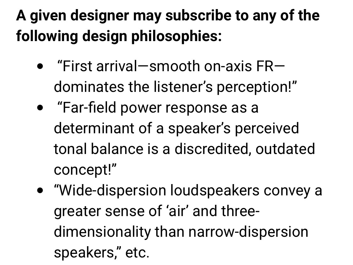

How do you personally feel about power response...the article the above pic is from, suggest that, some say it is an outdated concept. "Outdated" sometimes can seen as "neglected" lol so I tread lightly
Lets consider the power response of my 350hz tractrix...I listen to it pointed at the ceiling...when I put my ear on axis....I hear no "power response" per say....lets say I do... I'd think its the "airiness" of the reverb, using my dome tweeters...the lower the power response the less reverb....
If I were to theorize; Power response, no less than off axis transition, should be smooth and without peaks or nulls....and as uniform, as in constant, as possible. To which one could apply that, just like off axis transition, having a smooth transition devoid of peaks/nulls, is most important.

Not exactly correct.The power response is the inverse of the directivity Index/DI of the system. Go look up the JBL M2 brochure it's all in there. On axis, listening widow, power response, first reflection and system DI.
Rob![]()
The DI(theta) is the power response normalized by the "theta" response. In other words, the DI is dependent on what is chosen as the listening axis.
The listening axis response is what the direct field response will be, and the DI indicates what the relationship will be between the direct sound and the reverberant sound. If the DI is flat, then the reverberant field will have the same timbre as the direct sound. If it rises, then the direct sound will be "bright". This holds above say 300-400 Hz where the ears integration time is such that it cannot distinguish between the direct sound and the reverberant sound. But always remember that this is dependent on what one chooses as the listening axis. I choose and design my systems for a flat DI along about 20-25 degrees and toe-in the speakers. Thus, my direct field has the same timbre as the direct sound.
Is there a source of data showing various power responses of different systems?
The software on my website shows many speakers listening axis response and the DI as the angle is changed. It also shows the power response. So there are many examples available.
Your "theory" is exactly the reverse - the higher the power response the greater the reverberation will be. The higher the DI, the lessor the reverb field will be and, which is very important, the more delay there will be in the onset of the reverb field.
