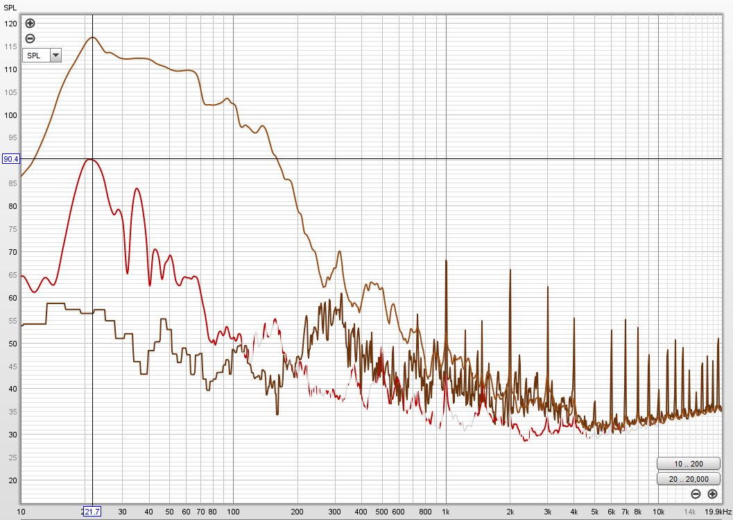

I think its the sound pressure in the room.... a lighter flame gives the same impression....mic says about 112 at one meter. Up closer the pressure waves impose on anything it can....like the diaphragm of the woofer....my theory
Random Rap song on youtube,,,,,808 note at ~30hz lol
(make sure to use ear protection while testing dynamics =)

![1642798594927.png 1642798594927.png](https://www.diyaudio.com/community/data/attachments/925/925151-b1e19d251fcf45143c57be5d5f895847.jpg)
This is from about 20" away, 2nd order 4.56% and lower at farther listening? GJ bandpass?

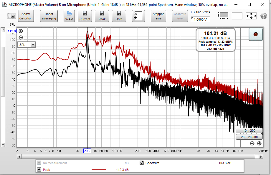

I've been playing bass content...most recently, tones at 20hz and 104db from 1 meter.....the amp is 10 degrees over ambient....54volts 16ohms..
with a system voiced flat to 20hz, I don't think the amp would ever get very hot.
The amp has been playing 20hz at said volume for about 10 minutes now.....The air out of the exhaust vent is about 30 over ambient, being near 100 while its 72 in hear
what are the drawbacks of using the 2nd order at 21hz?
You are getting a 30 degree temp rise coming out of your vent?? Your cones are facing the slot?? This is sealed so no venting to cool the drivers?? Have to wonder what's going on inside the box. Sounds like you have built up so much heat that it's radiating through the cones and frame into the slot. Might want to shut down and carefully lay a finger close to on the frames.
