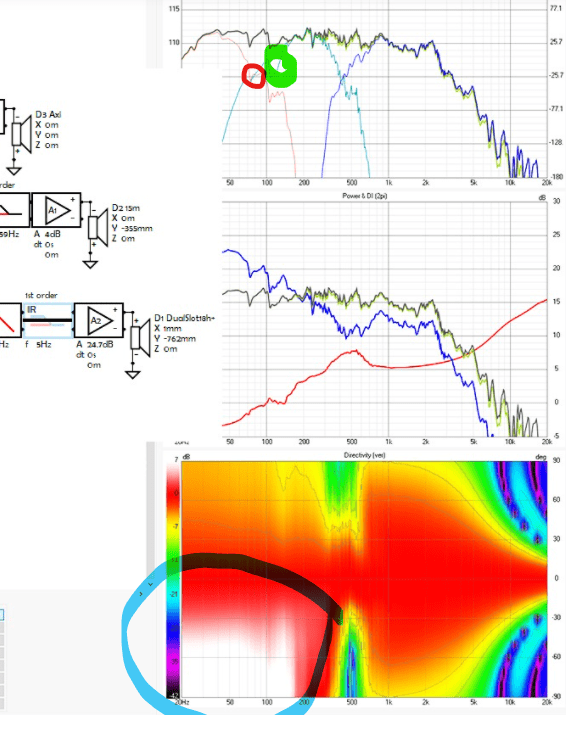

Lets focus on the measurements since thats all that matters in the end....That and our ears...Do you see something bad about the measurements? When I attempted to sum the sub/mid the first go round in vituixcad the resulting FR was plus minus 2db. Is this disappointing??

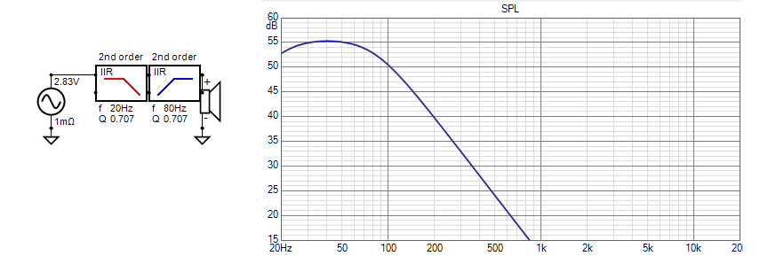

2nd order lowpass doesn't seem much different to a linkwitz transform on this sub ? I've used low LP filters to tame a rising response and then a 2nd, higher frequency LP to perform the XO in quite a few car installs. (Combination of in-built amplifier xo's and head unit xo)

Yes! Its displayed in the Vituixcad picture, of course this idea will look different once the room is factored in.
The reason why I pointed to Allens post, other than his own legitimacy lol, did you note how low the sensitivity was as a result of the filters...make up gain is required.
I've been slowly applying filters, according to the vituixcad FR design, and then making observations after each change....I didnt get past the low pass and gain staging up....but it seems that a low pass and room eq is all this response needs in the sub region...There is very little need for voice eq with the cross band
A second order filter does not change the sensitivity or make it low. Two matched second order slopes would give you a flat response and a wide overlap normally with a polarity flip on one side.
There is something fundamentally wrong somewhere in your simulation. In the picture attached below you can see that the polar below zero is white. There is some kind of offset here and I think your gain is related to it. There should not be a 24dB difference in output between the PPSL sub and the mid driver. With two 18's matching to a 15 there should be more output on the sub.
Take a measurement of the sub raw without any processing and a measurement of the mid at the same distance with the same mic gain and see what the difference in sensitivity is between them.
I would look at what is causing the dips in the sub and mid circled in the attachment. It will be difficult to blend these together, it is not easy to tell when other EQ.
I am trying to be helpful instead of rude, there is a fundamental problem in the simulation that needs to be addressed to move forward.
