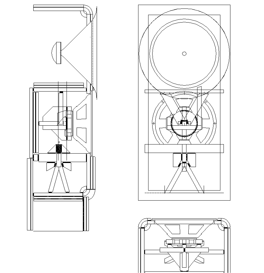

You will open opportunities, such as mounting the driver to the front of the rear piece, and the front piece to the cabinet.I have to buy 2 sheets of plywood and only need a sheet and a half so I plan on making the front baffle with 2 sheets of plywood with Decidamp between them.
Direct transmission of vibration from the basket to the whole cabinet, even through the mounting screws could be a concern especially with a full range driver.
It is the primary conduit for driver energy to pass to the enclosure. My philosophy is to brace well and directly connect the driver to more than just the baffle panel so as to spread its energy around. If you use a lossy fitment the driver basket will have significantly increase the movement of the basket to a relative fixed point decreasing the potential to reproduce the very small details, ie it degrades DDR.
dave
I really like the idea of attaching the driver to the inner baffle and attaching the outer baffle to the cabinet but I'm not sure if the Decidamp is strong enough to adhere the inner and outer baffle with out mechanical help.
If you take a look at the photo I posted, that's how I did it. There's no crime in shooting in a couple of screws to hold it all together. I think that box had about 70 or 80 screws in it... I made sure it wasn't coming apart!

That makes perfect sense, Dave. But without attaching some numbers to either side of the story, how can we make a decision about the magnitude of the effects of each approach?
Without accounting for panel flex, the simpliest analysis has M1 = driver mass vrs M2 = (driver mass + box mass). M2 >> M1.
With conservation of momentum M1 x V1 = M2 x V2. So V2, the driver movement w the box rigidly attached, is smaller, ie V2 = M1/M2 x V1.
Flexing of box panels will complicate the actual problem a bit.

Seems astonishing to think that any motion of a compliantly attached basket relative to your ears could be a good thing with or without numbers to prove it. Planet10 said it plainly enough in his post.
Either the basket is solidly mounted, or it is shaking in unplanned and unmusical ways. That's what "compliant" means, eh. Either the basket is a solid fixed foundation for the cone or it is just shaking as it pleases.

That's quite a black and white perspective. So a rigidly mounted basket doesn't vibrate/resonate/flex at all? I'm not disagreeing with your point, or with Dave. It just doesn't have to be zip ties and silly putty that we're talking about. There is a small world of methods and degrees of loss available in a less than perfectly rigid mount, if someone wants to explore that option.
I do agree with your second point, it's the essence of what my question was addressing.
It does. The idea is to hold it as rigid in space as possible. But there will always be some — hopefully vanishngly small — rocking motion of the cabinet as the speaker moves in and out.

Indeed, it's intuitive that any disturbance due to vibration, etc in a rigid mount would be primarily in the longitudinal direction. Whereas a driver in a viscous attachment could lose focus more easily in 3D. And, IMHO that should make someone cautious, but no less prone to experiment with such approaches.
