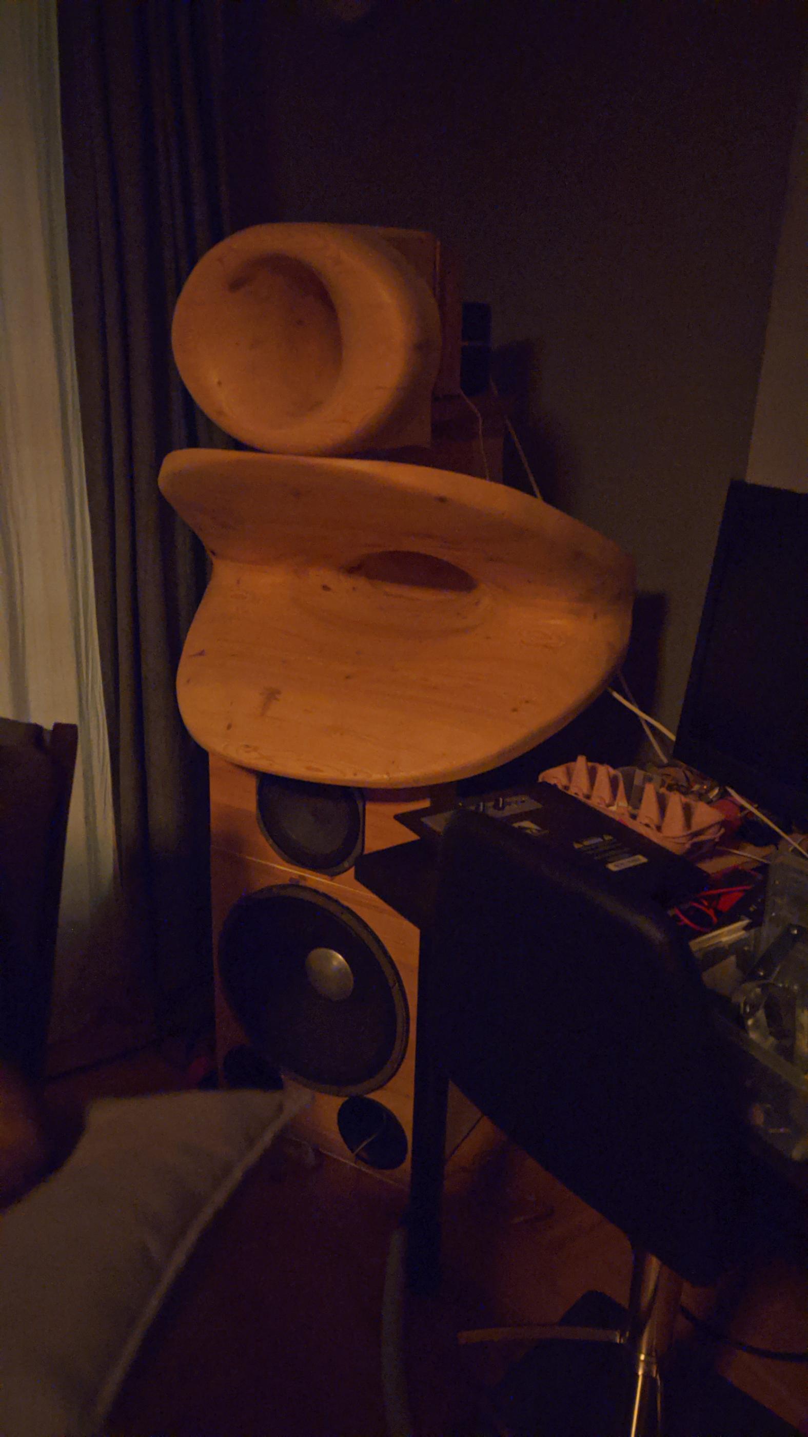

I use 2-by-4 and 2-by-8 for my horns. It becomes very dead because of its thick walls, but has a nice tone. Similar metal horns have a harder sound. Main advantage is that you can shape it into whatever you want. The drawbacks are weight, and the time it takes to carve it out and to grind the finish. If the wood has not been dried for a year it can crack, if it has not done so already while drying. It is easy to fill the cracks with wood filler (super glue mixed with wood dust) and looks nice.
For the midwoofer cabinet I used MDF on the sides, top, bottom, and back, with some supports inside, but the front is also in pine, to keep some of the looks and tone. Everything is gently painted with Flügger Natural Wood three times with fine sandpaper in between.

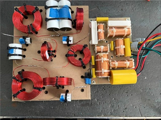

Re: Klipsch Forte III Upgrade with Pictures!
Pictures optimized and clarified.
* Stock Speaker Impressions
* Short Summary of Changes Made
* Upgraded Speaker Impressions

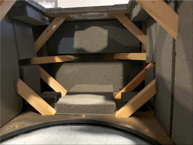

Cutting the braces. We did it differently than I thought we would. My idea was just to get some oak dowels and glue them lenghthwise and crosswise, flat against each interior panel. But Danny [Richie] explained that while it would make the cabinet stiffer, it would also eat up airspace. A better way for our purposes is to cut small diagonal braces and make triangle braces at key locations.
I also would have put the braces closer to the middle but Danny showed me that putting them at the 1/3rd point instead of the 1/2 point actually does a better job reducing resonance and increasing cabinet stiffness.
OK, so that’s it for impressions. Was it worth it? Hell yeah. It didn’t fundamentally change the speaker, but it took what the Forte III was already good at and made it much better. It didn’t lose any of that “Klipsch Magic”, in fact it seriously increased the Klipsch Magic.

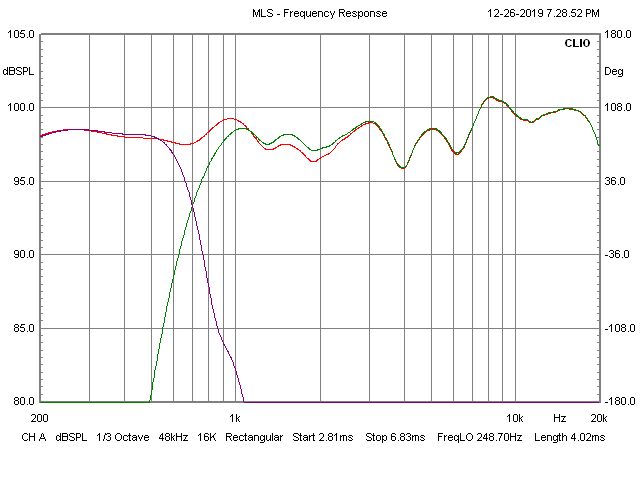

To complement the Klipsch Forte III comment, on axis measurements. Before and after:
