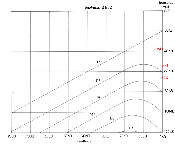

Some reading....
It is well known that if we start with an amplifier with an open-loop square-law response it will produce only second harmonic distortion, but with overall negative feedback added higher order harmonics will then be produced. This is perfectly true, but almost entirely misleading for several reasons. For a start there are no perfect square-law amplifiers. The closest we can get is probably the field-effect transistor, (fet), but measurements confirm that these already add low levels of high order harmonics even with no feedback. The following graph shows approximately what happens to the harmonics of a typical fet as feedback is applied. The distortion levels at zero and low feedback may differ widely for different fets, but as feedback is increased the results will become more similar to the example shown:
The signal level is chosen to give 10% second harmonic at zero feedback. The harmonics are shown as H2 (second) to H7 (seventh). With zero feedback harmonics up to the 5th are above the -120dB level. Applying a low level of feedback the 6th and 7th harmonics increase a little above -120dB. Increasing feedback further the higher harmonics one by one fall down below the -120dB level until at a little over 80dB feedback we are left with only the fundamental plus second harmonic.
This shows the misleading aspect of the initial assertion that feedback adds high order harmonics. In any single fet amplifier stage the third and higher order harmonics are already there without feedback, become worse with low levels of feedback, but all disappear below -120dB at high levels of feedback. It is only at sufficiently high feedback levels that the 'audible' level distortion is purely second harmonic, and in the present example at 80dB feedback that second harmonic level is at -100dB (0.001%) rather than the -20dB (10%) of the zero feedback amplifier.

The signal level is chosen to give 10% second harmonic at zero feedback. The harmonics are shown as H2 (second) to H7 (seventh). .
Jam this seems higher than what I normally get (relying on memory here), I think I normally get around 1% THD or better without feedback (I will check that out though).
From recent memory, measuring ACA and F6, increasing feedback by an additional 6dB to 9dB did not add any increase in higher harmonics (It was purely 2nd and 3rd) at 1W 1kHz.

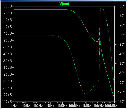

C6 and C8 could be eliminated by adding resistors at the base of each bipolar Q5, Q6
If I eliminate the Miller comp (is it still Miller comp on a differential VAS?) I get a really ugly spike at 10Mhz. (The phase spikes too, so the stability margins remain OK, but it still worries me.)
What resistor values did you use at the base of the bipolars when you eliminated the caps?
Try 1kOhm base resistors.
You can obviously use lower values, but start with 1kOhm.
This is very informative.
Bingo. That works. (I had tried all the way up to 470 with no success.)
Eliminating those caps (Miller or not) gives a huge boost to 10kHz performance....
