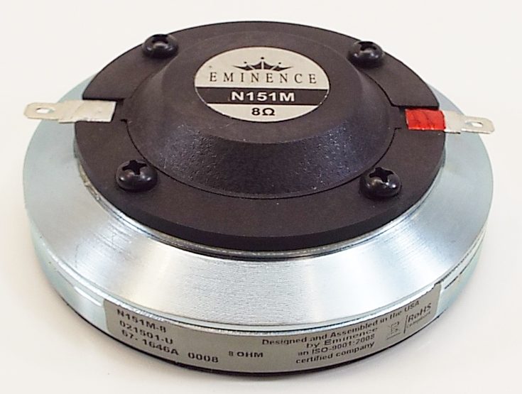

I stumbled onto the Eminence entry not long ago. Having always wanted to try a ring radiator but not wanting to pay JBL prices and risk disappointment, I ordered a pair plus screw-on adapters despite their advertised graph giving me doubts. I replaced my standard-diaphragm drivers (with far more impressive advertised graphs) with these units and was struck by their HF energy and clarity. So much for graphs.
I wanted a driver to run from 2600hz onward. I used the cheap-but-impressive Eminence 150s CD horns and continue to do so. I was surprised by the linearity I saw in my simple mike/scope test, with just a slight amplitude bump from 5k to 7k. I'm not concerned with lower frequency extension since my crossover is FIR-based and fairly steep. In short, they work fine for my purposes. I continue to `tune' them.
I'd be interested to see how such an affordable combination stacks up vs. high priced units in subjective listening tests.

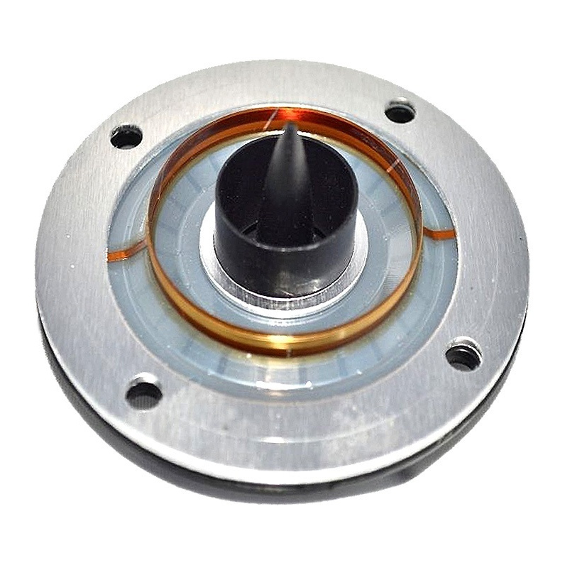

The Eminence N151M really seems to be a shameless copy of BMS. Did the patents expire or something?!
![bms-4538.jpg](https://www.componentesdealtavoz.com/838-large_default/bms-4538.jpg)
BMS 4538 - about $80
![4552ND.jpg](https://smhttp-ssl-69079.nexcesscdn.net/media/catalog/product/cache/1/medium_image/640x640/5e06319eda06f020e43594a9c230972d/b/m/bms-4552ND-0/4552ND.jpg)
BMS 4552 - $300
![product_d_s_dscf4583.jpg](https://www.midwestspeakerrepair.com/wp-content/uploads/2017/10/product_d_s_dscf4583.jpg)
Eminence N151M
![BM4538LD.jpg](https://www.bluearan.co.uk/sales/bms/images/BM4538LD.jpg)
BMS 4538 diaphragm
BMS 4552 diaphragm
Eminence N151M diaphragm
It's so close to the BMS 4538, you'd almost think the diaphragms are interchangeable. But the Eminence is neodymium while the BMS 4538 is ferrite. The BMS 4552 is neo, but it costs more than 3X as much as the Eminence.
