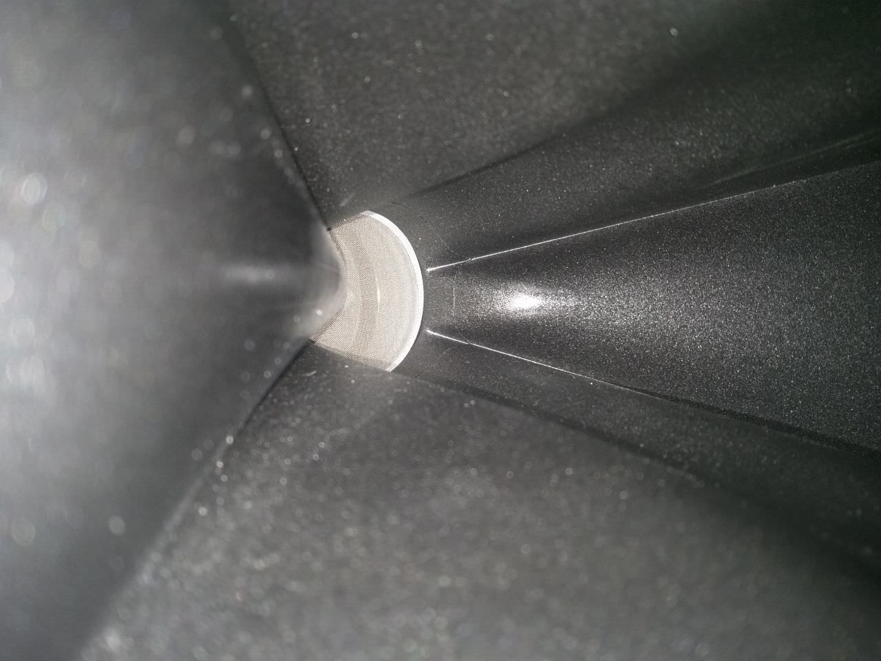

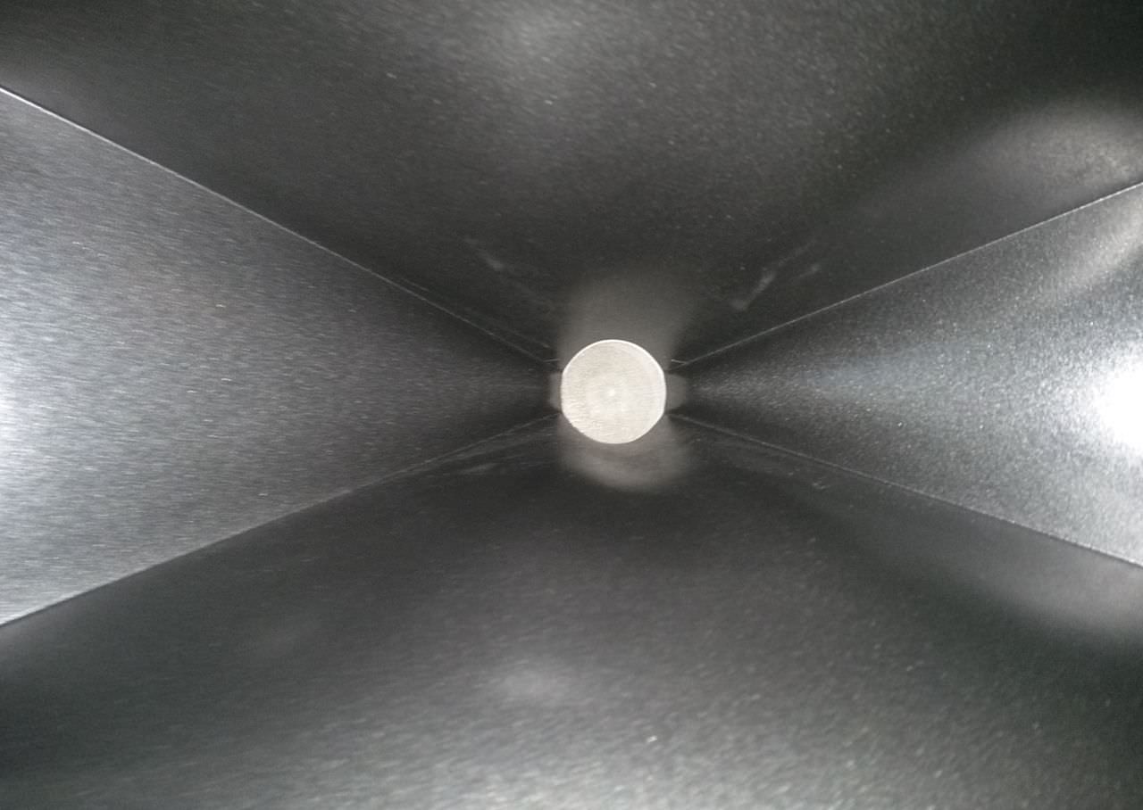

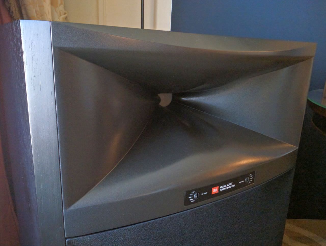

After messing around with ABEC a bit, I found that the JBL Image Control Waveguides work a bit differently than I realized.
In a previous post, I'd argued that the M2 waveguide is basically a diffraction horn with a 3D diffraction slot.
So instead of this
We have this
What I'm noticing in ABEC, is that higher frequencies don't "see" the walls of the waveguide if the coverage angle is particularly wide.
Tom Danley has talked about this a few times. Here's an example:
In the waveguide pictured above, the horizontal and the vertical angle is sixty degrees. Along the diagonals, the coverage angle is 84.84 degrees. This is just basic Pythagorean Theorem; the horn is wider along the diagonals.
Danley took advantage of that wider angle, and that's why the midrange taps in a Unity horn are in the corners of the horn.
From what I can see in ABEC, particularly at higher frequencies, the wavefront literally doesn't "see" the walls of the waveguide.
A wide coverage angle was one of the stated goals of the M2 project. As documented in another thread (https://www.diyaudio.com/forums/multi-way/330741-preference-direct-radiators-14), listeners appear to prefer a wider angle.
But this poses a technical problem; if the wavefronts literally can't "see" the walls, what's the point of the waveguide?!
Overall, the new JBL waveguides have wide angles (like listeners prefer) but they're 'pinched' along the horizontal axis. I'm guessing that they're using something like ABEC to come up with a shape where the wavefronts aren't 'detached' from the waveguide walls. I would speculate that this would likely also reduce Higher Order Modes; because if the walls are just *barely* narrow enough to constrain the wavefront, the likelihood of Higher Order Modes is reduced.
This could also help explain why listeners seem to like these shallow waveguide: for a large part of their bandwidth, the wavefronts generated by the tweeter don't "see" the waveguide whatsoever.
On the downside, I've only scratched the surface of this phenomenon. This is a complex problem and there's a million factors that will influence the behavior of the unit:
