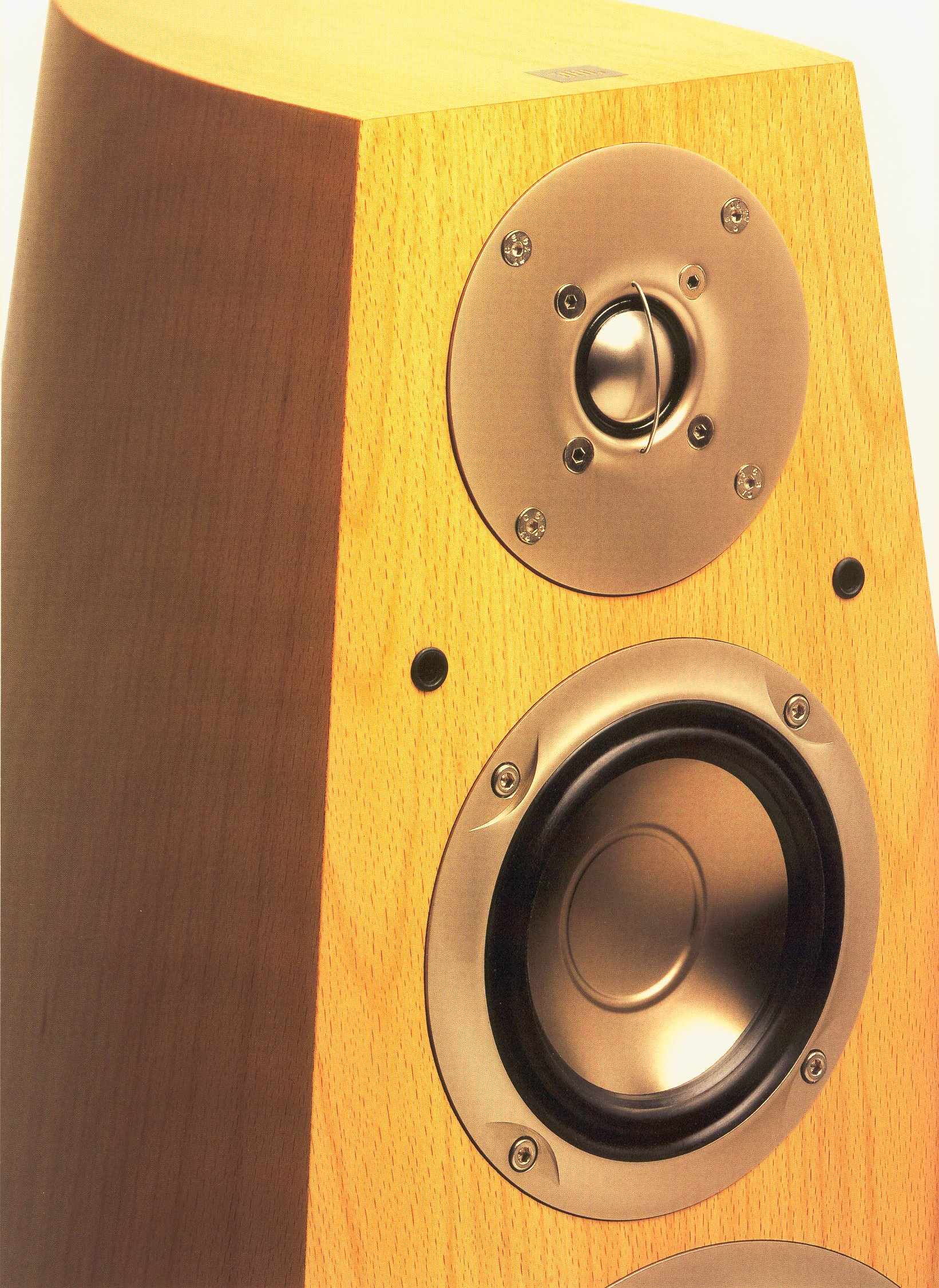

I have listened to the Mk1 and Mk2 Evidence on several occasions...
and found those remarkably bad.
I have owned 6 pairs of Dynaudio speakers, all from the Contour range as well as the Crafft with Esotar 330, so I am familiar with the brand.
With a few exceptions, the smaller monitors are their best products. That is, if you like the sound of low sensitivity monitors.
No doubt, the Revel Salon2 will give the Evidence a run for its money.
