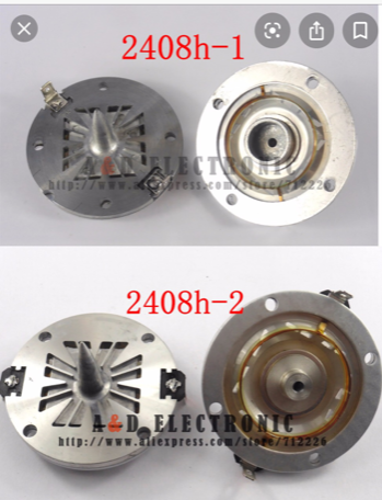

I'm not entirely sure why the 2408H-2 is one third of the price of the 2408H-1. From looking at the spec sheet, they seem to be similar. The former seems to have a smaller motor. Phase plug seems to be similar.
I can't easily explain the difference unless I measured both of them. I have a BMS 4540ND here, and a JBL 2408H-1, and they are very similar. The primary difference that I can see is that the phase plug on the JBL is more advanced.

Sorry. Not a spec sheet per se, but the information online about the weight, diameter, pictures, etc. They can give you some clues on the driver.
Did find this picture that can bring some light to what is the difference between 2408h-1 and 2408h-2.
The picture is from aliexpress so everyone can judge for them self. But if these are clones then somebody did make them different for a reason.
The 2409 in JBL 708 can still not be bought but is that a new driver or a development of the 2408h-2.
