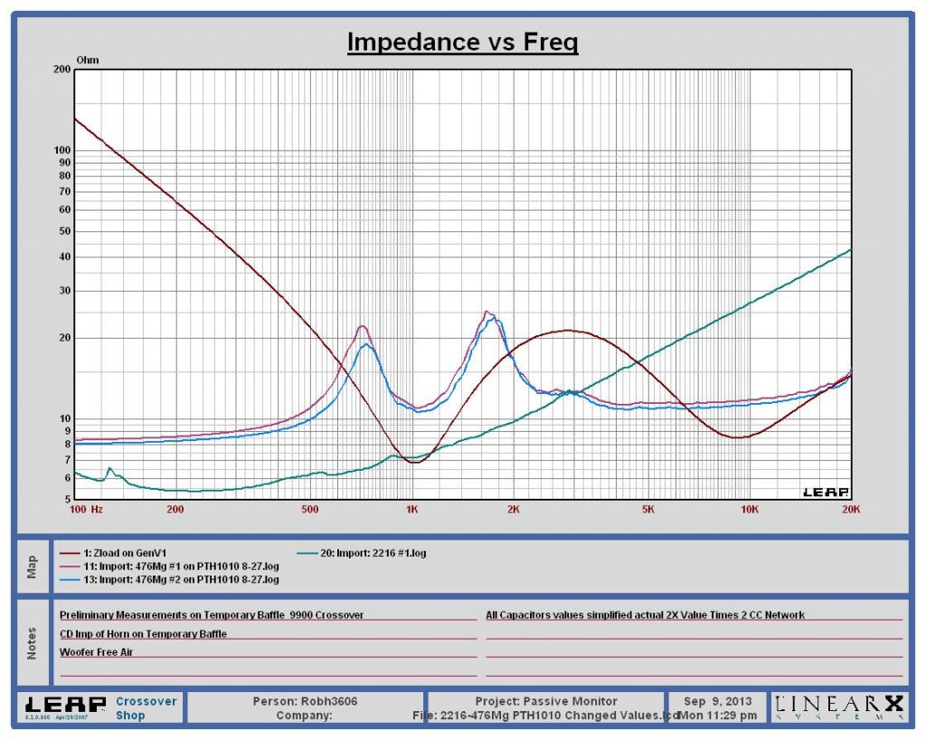

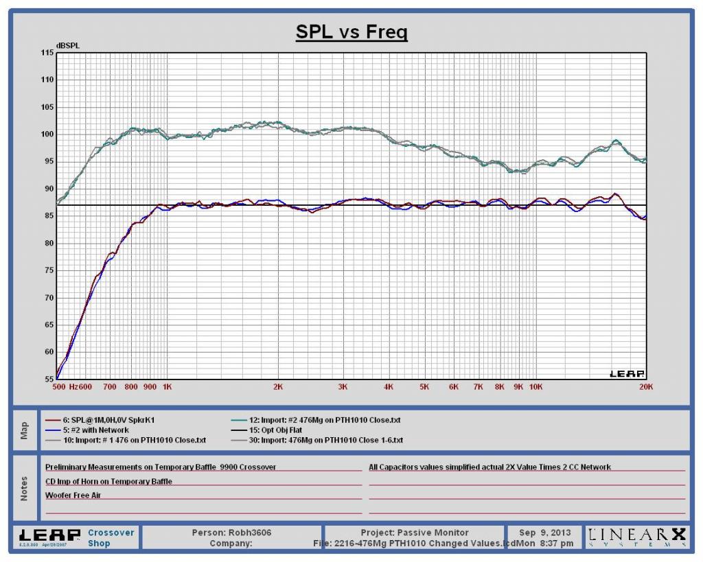

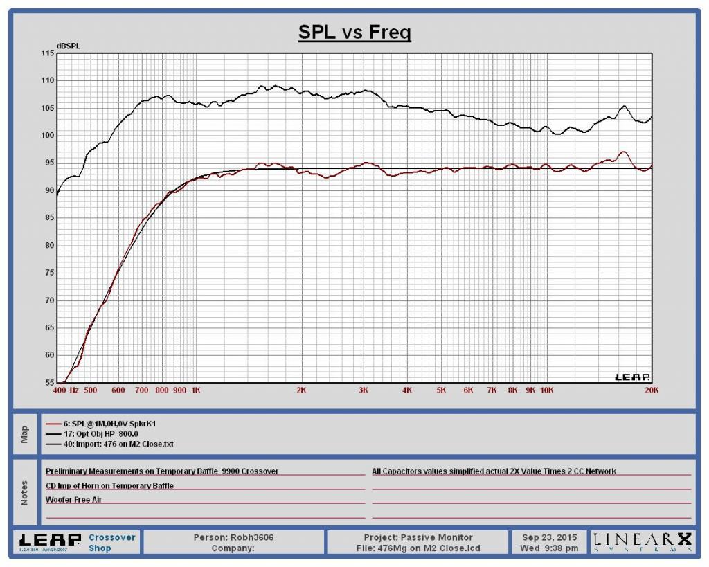

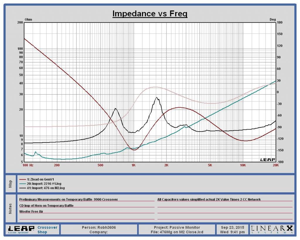

Not sure how you define loading. I look at from the view of where the roll off starts. Attached are the frequency response and the impedance plots for both using the same large format 4" driver. Either one of them make an easy 800Hz crossover point and both can do well with a passive network to flatten out the response. As I see it both are very similar look at the impedance plots.

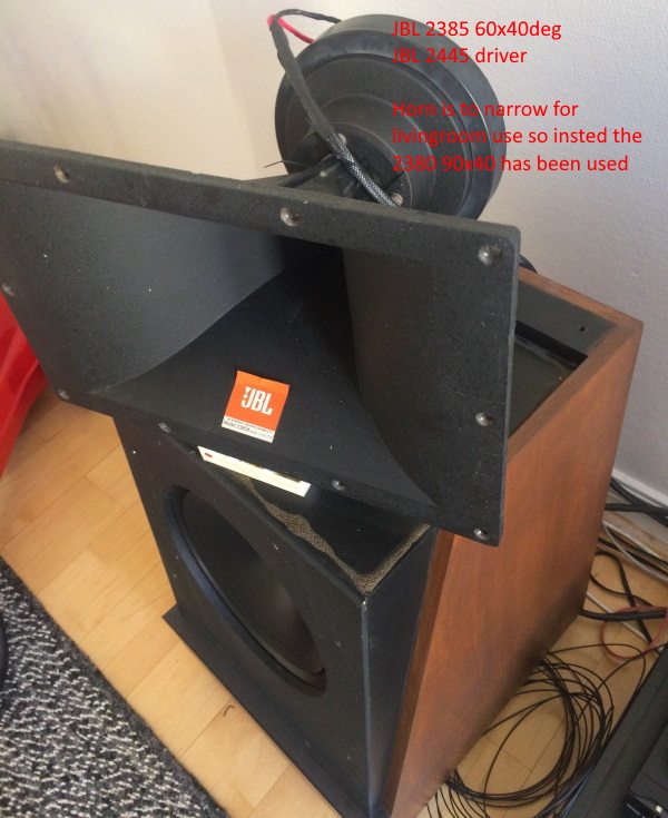

Se my picture. I hade these old KEF105 speakers. Took the base from them and put the horn on top. That was not difficult to do but I had the parts laying around for a year before I realized I can use them together.
