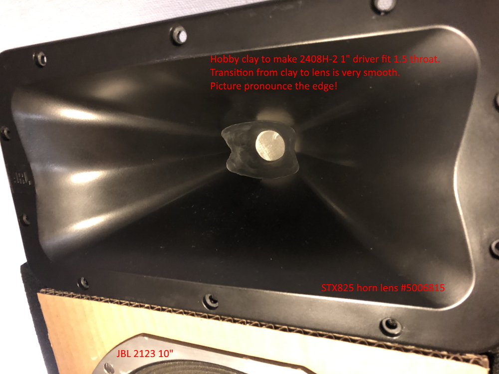

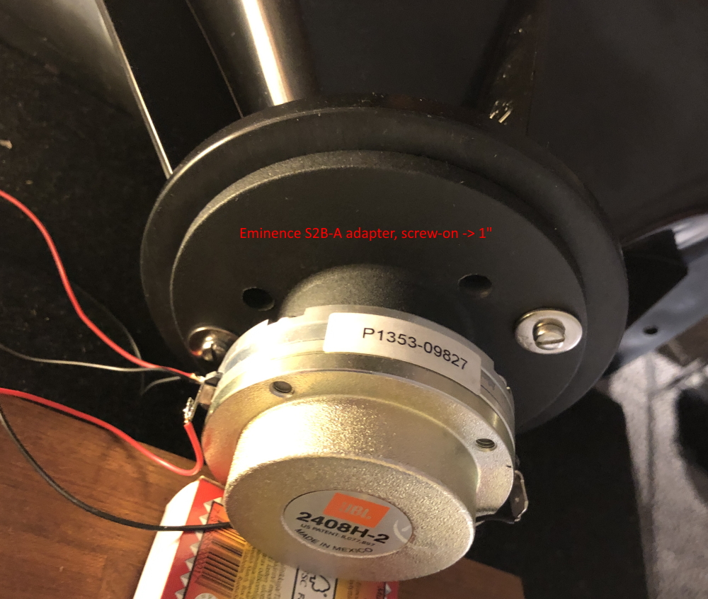

I did buy 2408h-2 for 58,99$. I use them with STX825 horns. Did some modification to the horn throat with ”hobby clay” to fit the 1” driver to the 1,5 horn throat.
JBL 2408H-2 Compression Driver for PRX Series 5020337X - Speaker Exchange

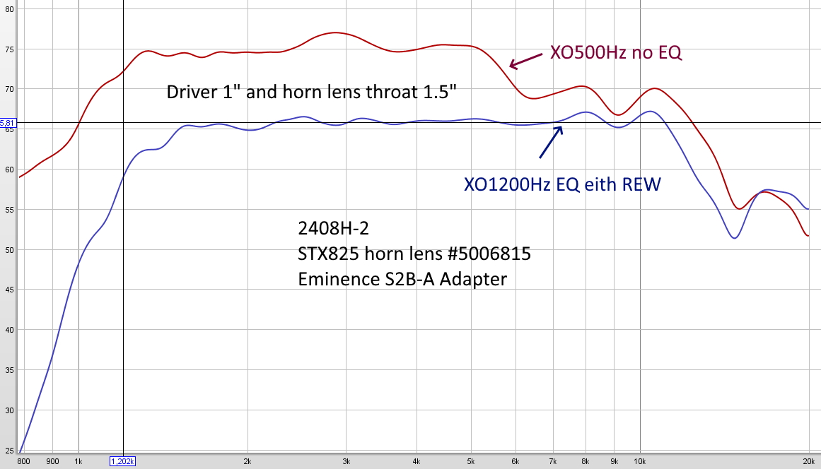

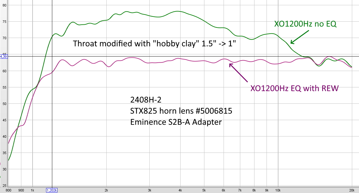

Here some measurements before and after modifying the horn throat. So why did I do this? Well, I bought the 2408H-2 out of interest to try and because it is very cheap so I thought I have little to loos.
The horn lens because when ordering overs sea the shipment is always +50$. So I thought to buy at the same time as I now have the option to fit a 1,5" driver later if I want. And If the lens does not work the I can buy the JBL 1" copy her locally in Helsinki.

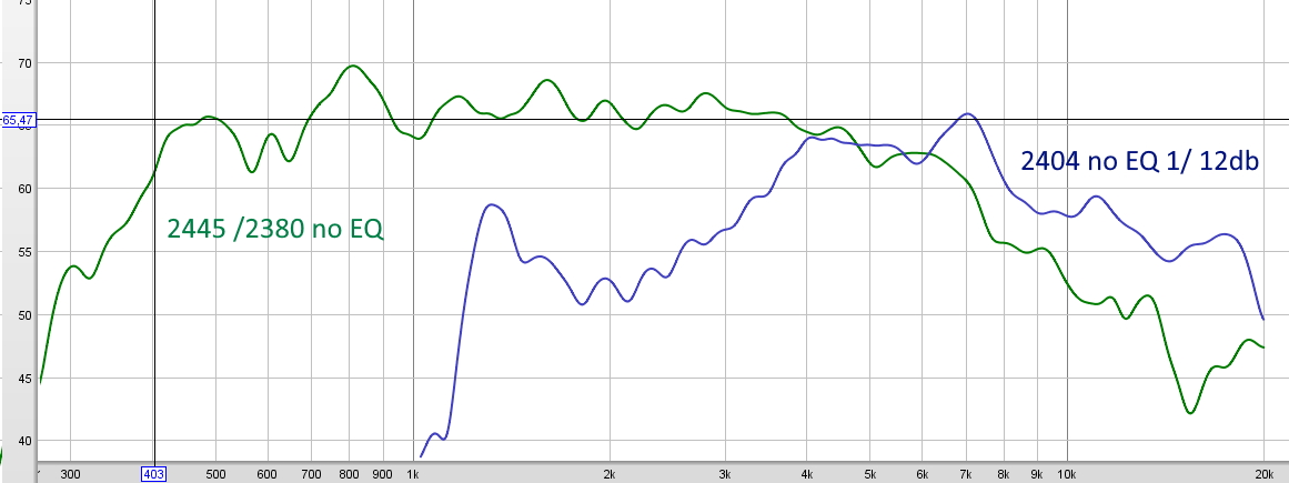

I have been toying for some years now with the 2380 horn and the 2445 2" driver. This is not the same as 2446 but as near as you can get.
I have been using the 2404 ring radiator as treble as it opens up the sound nicely.
But linearization of the drivers and time aligning is crucial.
At least for me, they sound nice and eary. My friend said that it sounds like at the local Jazz club. Very dynamic, narrow and Clair. Not hard at all to me but I'm an old roadie. And this feeling remains at a very low volume.
I have no experience with the 2226 but they probably sound nice. You might want some subs with them thou.
