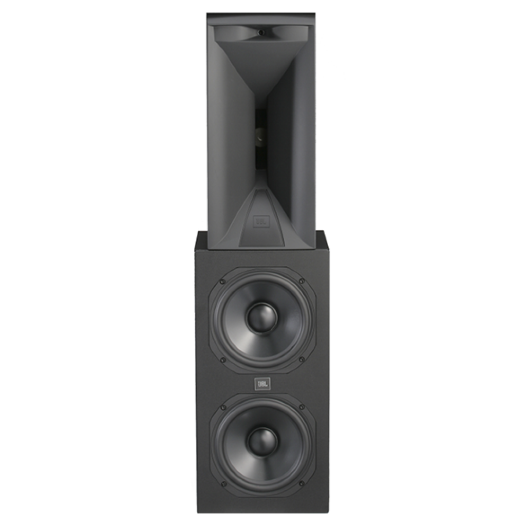

I very recently had the chance to audition the JBL 708 as I’m in the market for a new pair of reference monitors for my studio and really enjoyed what I heard.......but what I was listening for may be quite different than the direction of this thread...... neutral, balanced and revealing......needing to be able to perceive all of the image factors that make a great 2channel recording.......depth, height, stereo wide, etc......things sometimes taken for granted when listening as opposed to creating a mix.
I used my usual reference tracks across genres.........some Steely Dan, Pink Floyd, chamber music, symphony’s and some extreme metal for clarity....lol. The 708s didn’t disappoint and were very analytical.......a great tool for mixing in a clinical sorta way. Plenty of dynamic headroom on tap too......these can get LOUD. But when not analyzing from reference....the 708 is a bit boring to tell the truth. If I wanted to listen for the sake of pure enjoyment, I couldn’t say the 708 would be my weapon of choice
Also got to audition these in the same day a few hours away later in the day as a side note checking out a commercial studio for film scoring....
Sceptre S8 | PreSonus
Now I’d be the first to admit that the improved acoustics of the space would be a factor in most cases BUT i was listening in the nearfield so the only unaccounted difference would be low end mud clouding my perceptions in a sales showroom. Vs a professional control room...and to be fair, the retail showroom was fairly treated sans any bass traps i wasn’t aware of.......but the Sceptre S8 bested those 708s in every conceivable way.....from imaging characteristics, clarity into the mix, low frequency extension, ....all of it. The design is unusual and apparently not new...been around 5 years or so but I’m near to tell you.....if this is all by the coaxial design.....this implementation is a diamond in the rough.

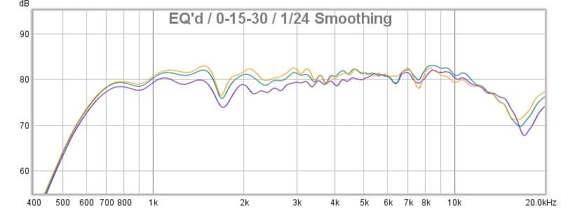

Here's a picture and a measurement of my Waslo Cosynes
![9m7UeLD.jpg](https://imgur.com/9m7UeLD.jpg)
![0AmDLSA.png](https://imgur.com/0AmDLSA.png)
Here's a picture and a measurement of my Kali LP6s, with a roundover added
When I replaced the Cosynes with the Kalis, my initial reaction was "This is a giant downgrade." Which is interesting, because the Kali measurements look way better.
I wish there was some kind of metric that could take into account things that the mic doesn't see. For instance, I think there may be something to coaxial radiation that the mic isn't telling us. If you'd asked me a year ago, why the Unity horns sound so good, I would've said that phase has a lot to do with it. But I'm now thinking that it's the coaxial nature of the radiation that's more important.
Another possibility is that it's simply the giant waveguide. I have generally found that big waveguides measure better than small waveguides. Basically it's fairly trivial to get a 6" waveguide to measure well, but getting a 24" wide waveguide to measure well is challenging. But though the big waveguides measure worse, they seem to give the listener the ability to "see into the mix" that the small waveguides don't do. I noticed this same thing back in the 90s, with the car audio waveguides: they didn't measure very well, but they had an x-ray quality that conventional tweeters DON'T.
Long story short, my experience with a two-way with waveguide (Kali LP6) versus a coaxial horn (Cosyne) are similar to yours.

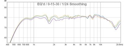

Hey john!
Thanks for posting measurements of the cosynes! I made a horn from Bill's spreadsheet this weekend and used a similar micro driver to you (peerless 0.5inch). Is the bunching up of directivity after 3k a symptom/intended feature of this horn?
I made a 23cm 1000hz version and despite the difference in size they measure similarly. The cosynes really interest me!

With all of the waveguides that I've built, I've consistently noticed an issue where the wavefronts don't "see" the walls of the waveguide.
For instance, all of our simulations assume that the compression driver or the tweeter produces a wavefront that's perfectly flat.
But here in the real world, tweeters tend to beam.
Due to this, when the coverage angle of the waveguide is particularly wide, the wavefront simply doesn't see the walls at all.
It's a bummer, because it means that the wavefront traveling down our wavegides simply doesn't see the walls at all.
There's numerous ways to fix this:
![DSC_0045-copy.jpg](https://www.choicehifi.com/wp-content/uploads/2019/01/DSC_0045-copy.jpg)
1) You can make a waveguide that 'squashes' the vertical wavefront. Basically you're robbing from Peter to pay Paul. You're narrowing the vertical directivity so that the horizontal directivity is well behaved.
![JBLSynthesis_SAM1HF_Front_Hero_Black_Web.png](https://www.jblsynthesis.com/on/demandware.static/-/Sites-masterCatalog_Harman/default/dwe4598c14/JBLSynthesis_SAM1HF_Front_Hero_Black_Web.png)
2) You can makes a waveguide that squashes the wavefront on the horizontals. Same idea as above, but rotated 90 degrees.
2) You can makes a waveguide that squashes the wavefront on the diagonals. Same idea as above, but rotated 45 degrees.
You can make a waveguide with a narrower beamwidth
You can use a vertical diffraction slot
And on and on and on.
Basically if one or both of your angles is wide, you're going to need to consider a diffraction slot (or slots) because the wavefront simply will not SEE the waveguide walls if the beamwidth is wide.
Your measurement shows this: above about 6khz, it doesn't see the walls at all, that's why the beamwidth is about 180degrees.
For your waveguide, the easiest fix would be to add a stub at the throat. Make it the same diameter as the driver. And then start with a length of about 25mm, and progressively shorten it.
The idea is that the 'stub' is going to take the converging wavefront and concentrate it into a flat wavefront. This is going to take some trial and error.
In horns and waveguides, the throat is paramount, you absolutely MUST get the throat right or the entire thing goes to hell. Geddes understands this, it's why he has a patent on interchangeable phase plugs. Basically you have to treat the driver, the phase plug and the waveguide as a single unit. A compression driver which works well on one waveguide may not work well on another.

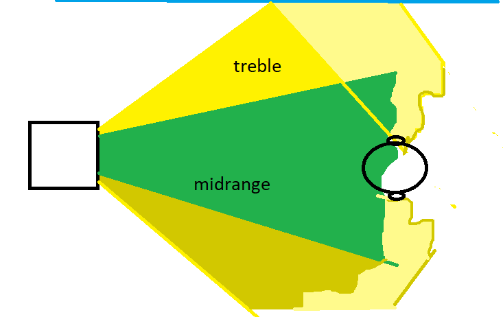

I should mention that the sound and odd directivity of the Cosyne isn't due to any great design skill or insight, it's pretty much accidental/lucky. But I'd go along with Patrick's suggestion that larger synergy-like horns just seem to sound better than smaller ones. Maybe it's because you get directivity in the midrange, rather than only at the treble (where it's usually much easier to get). I didn't get the same behavior at high frequencies when I measured the Cosynes, but I never got them outdoors to measure patterns at distance, I wasn't in any condition to move big things like that outside and back...
Of course, the pattern gets beamier above about 15kHz with a 1" driver.
I've read somewhere that wider coverage angle at high frequencies than at midrange can be a preferable situation, maybe for providing a more in-the-room sound from some of the HF energy coming from the side of the listenr, while keeping the image clean with the more confined midrange.
This sketch is what I'm trying to say -- narrower pattern for midrange than for treble.
I'm leaning toward that theory, because in my current system I've gravitated into a setup that gives a similar behavior, which I find very convincing. I'm using an array of small drivers for treble dispersion behind the Smallsyns, feeding them with a DSP-delayed signal. Getting much of both worlds, sharp stable imaging; and ambience.
