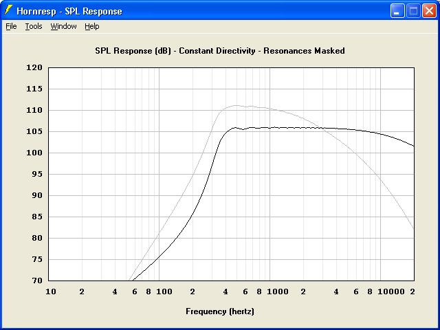

Jmmlc said:Additionally if we use a perfect theoretical diaphragm (a constant velocity diaphragm), simulations (BEM , FEM, Hornresp...) never give an extended response curve in the HF... as we obtained using a TD2001 horn on a Le Cléac'h horn (Fc = 380Hz , T = 0,8).
Hi Jean-Michel,
Currently the production version of Hornresp cannot simulate a constant velocity diaphragm (over the full frequency range).
In recent days though, I have been looking at the possibility of including such an option (as suggested by you in the Subwoofers Hornresp thread).
The attached screenprint shows the power response of a TD2001 driver on a Le Cléac'h horn (Fc = 320Hz, T = 0.8) for a constant diaphragm rms velocity of 10 cm/sec (black trace) compared to the same horn system with Eg = 2.83V (grey trace).
It is interesting that the HF response is significantly extended in the 'constant velocity diaphragm' case. Note that this applies to all horn types, not just Le Cléac'h horns.
Kind regards,
David
Hello David,
Thank you a lot to study the possibility to use in Hornresp a constant velocity diaphragm.
Your simulation is very interesting as it may prove that some of the published measured parameters for the TD2001 (e.g.: mms or mmd) that are difficult for me to estimate through my own mesurement are somewhat eroneous...
Your simulation is also so near of my measurements (though your simulation is most probably "constant directivity power" while mine is on axis?) that it lead to thgink that the TAD TD2001 is really excellent and that the model of the TD2001 I developped for Hornresp has to me modified....
Best regards rfom Paris, France
Jean-Michel Le Cléac'h

David McBean said:
Hi Jean-Michel,
Kind regards,
David

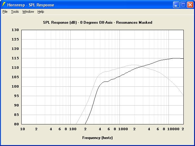

Jmmlc said:Though your simulation is most probably "constant directivity power" while mine is on axis?
Hi Jean-Michel,
Your assumption is correct.
The equivalent simulated on-axis pressure comparison is shown below (black trace = constant velocity, grey trace = Eg 2.83V).
Kind regards,
David
