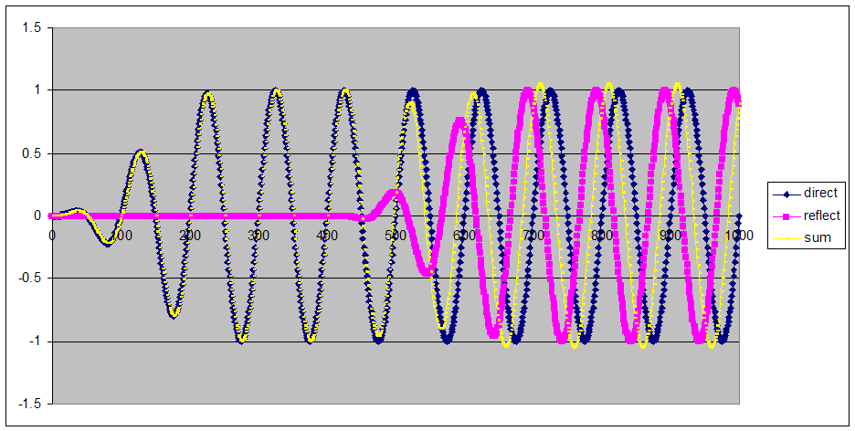

A 130Hz high Q annulation in the response could eventually correspond to the interference between 2 signals having a diffference of path of 3,9meters which value don't correspond to anything precise in the auditorium. Eventually it can be due to the large rear chamber.

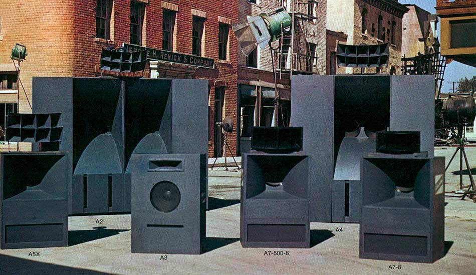

Here's a photo from the 1975 Altec catalog (source: Lansing Heritage website) that shows the A2, A4, A5X, and A7 series loudspeakers. The setting of a Hollywood backlot is entirely appropriate, since the A-series were the standard of the industry from 1945 onwards, and were behind the screens of Cinerama, VistaVision, Todd-AO 70, and Super Panavision 70 movie theaters.
Anyway, I'm interested in a LeCleac'h version of the Altec A-series short horn, minus the bass-reflex enclosure. It seems like a scaled-up version of mige0's tweeter horn might do the job.

How one can define phase at low freqs in a room anyway? Consider a simple illustrative example of a direct wave and a later arriving reflection. The summed signal will exhibit temporal phase shift at the time the reflection hits in. Then imagine a room with multiple reflections - at a given frequency and at a given time the signal will have a random phase! How one can have phase linearity and constant group delay in a room at low freqs? This leads to the situation where phase relations of the harmonics of a musical instrument when reproduced in a room will be all messed up.
How to measure phase at low freqs? Since the phase will have temporal randomness the measurement result depends on the time window samples are taken. What is the correct time window? Since in a practical sized living rooms multiple reflections arrive already before one full cycle of direct wave has passed, there is no change to have uncorrupted wave to measure the phase in the first place.
It is very true that different types of speakers do better than others in this respect. The one with the highest directivity wins of course. The most practical high directivity source at low freqs is a dipole line array. A second order gradient source would be even better, but it's very rarely seen in practise even with diyers.
I think it's also very true that it does not make sense to do measurements in an anechoic chamber. As we are doing high quality systems they must be designed for the room they will be based in.
- Elias
