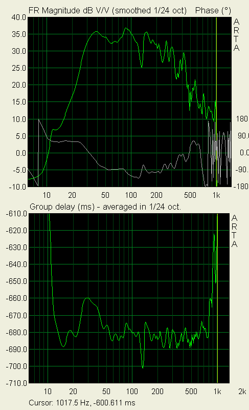

Hello Panomaniac,
Jean-Paul used to program the DCX2496 with 2 different configurations, so he can switch between them.
One of this configuration is with equalisation below 35Hz (which is not useful IMHO) and the other one without equalisation below 35Hz.
Listening demonstrated that without equalisation was better and this was verified by the pulse mesurement done by the logsweep+ convolution method.
Measurement performed with equalization shows that distortion rises a lot (may be due to too much equalisation: +18dB at 20Hz!).
response with and without equalisation below 35Hz:
http://zepload.com/images/1242489777_estrade D 0cm & cor.jpg
Response + distortion with equalisation:
http://zepload.com/images/1242565743_Disto 0cm estrade cor.jpg
Response + distortion without equalisation:
http://zepload.com/images/1242565693_Disto 0cm estrade sans cor.jpg

panomaniac said:
OK, same as me. Now, do I have room for a horn like that? Hmmm....
Oh, OK. I see. Yes, it is very handy for that. He is just using it as an RTA. But isn't there a little EQ down at 35Hz to flatten the low end? Maybe from a DCX or something? What is the EQ shown in the measurements? Was that EQ only for measurements?
A little low end boost on a system like this should not hurt. It would extend lower - and I doubt the 416-8A is working very hard! [/B]
I see! Distortion does rise quite a bit just to get those bottom 10Hz.
Was there a conclusion as to where the distortion is coming from? Horn, amp, 416-8A, DCX? Or is it a combination of all of these?

panomaniac said:I see! Distortion does rise quite a bit just to get those bottom 10Hz.
This is certainly a very interesting bass horn, it would be nice to learn more about it. It certainly raises a lot of questions.
Non-linear distortion limitations of the driver. Anytime you near fs for bass drivers - distortion goes way up. Amplifying below resonance is generally NOT a good idea (..and driver control starts to rely heavily on driver compliance).

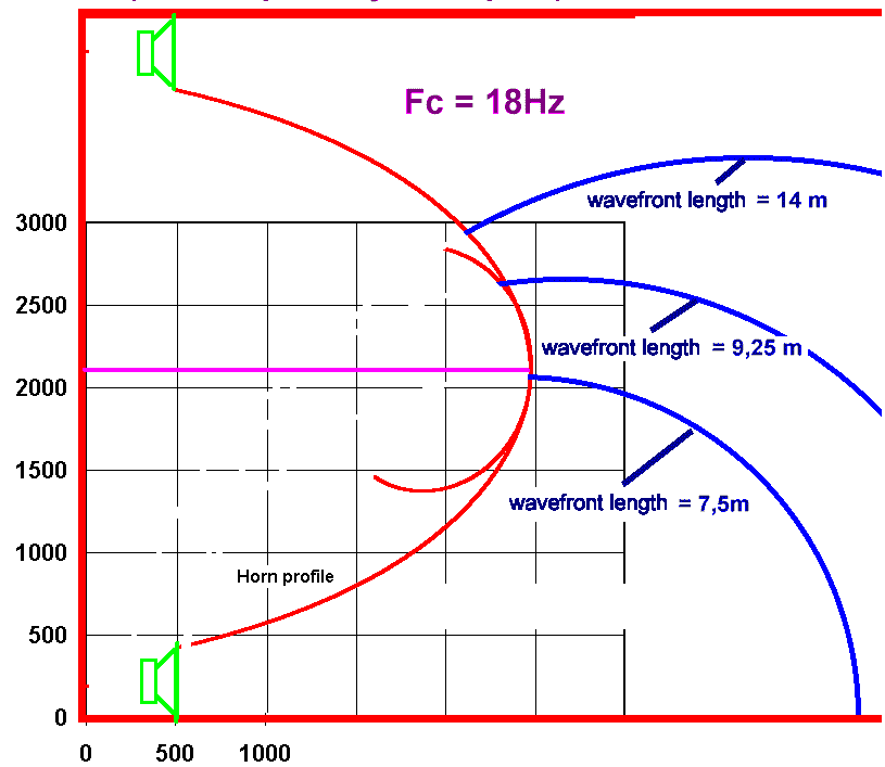

About diffraction in horns like Jean-Paul or Frédéric's basshorns
It only happen on the horizontal edge of the top plate of the basshorn. I recommanded myself to the builders of those kind of basshorns to use some Iwata's slots near that edge. But unfortunately until now nobody follows my recommandation.
Where the quasicylindrical waves Le Cléac'h bass horn is better than most other basshorns is the ease for the wave to drag along the walls of the listening room (which can be considered itself as a part of the double horn) and the floor (despite some vertical diffraction).
This is illustrated by the attached graph. We can see on the graph that in the horizontal plane the wavefront can expand a lot before a first reflection occurs.

hello Jean Michel
i've seen some time ago a paper of yours, where it shows the acoustic radiation of a few orchestral instruments. For certain, most instruments radiate in a vertical range , from the floor to 1,5m - 2m of height . From this starting point, is it not a most accurate reproduction, if a loudspeaker radiates also in a similar vertical range ? For some time, i thought, point source reproduction would be the best. But this doesn't occur at a life event. I got a very good integration of the channels of my system, and it reproduces as a whole single acoustical cloud, giving a nice, lifelike dimensionality, in a vertical range , and loads the room quit evenly.

Merci JM.
I have seen that wavefront graph before, but forgetten it. Thanks for reposting. It gives a nice top view of how the horn could be built.

Angelo,
It is impossible to reproduce the radiation pattren of most musical instrument in stereophony. The way loudspeakers are separated on a vertical line will have little or no influence on that.
Human hearing is poor in localizing the height of the sources of sounds but soome people are more sensitive to that and they can perceive a tweeter placed on top of a medium horn itself placed on top of a large bass horn. For them the necessary distance between the axis of the different horns and loudspeakers of the same channel is a problem as they can perceive the tweeter, the medium and the bass as different sources when a "normal" audiophile will pereive it as a single source.
I have a friend who even has the problem when listening to VOT and to a 3 ways Onken System!
On the other hand, in most musical event, the sources of low frequencies are generally positionned at a lower height than the sources of medium frequencies and themselves are positionned at a lower height than the sources of high frequencies so, a set up as those of JeanPaul or Frédéric 's systems reproduce accurately that pattern

With such bass horn as the Le Cléac'h horn the group delay is constant above 40Hz.
Furthermore as you can use them until 250 to 350Hz there is an excellent pulse response.
Because you simply cannot have a constant group delay below 150Hz -200Hz with conventional arrays (even in infinite baffle) their pulse response is quite bad compared to the bass horns. (Additionally they will be difficult to use until 250Hz or more).
I'd like to see this (if possible).
Are you saying that there is no phase shifting between the 300-40Hz region?
Or, are you perhaps saying that the phase shift is shifting at a constant rate vs. freq..? (i.e. 25 deg. phase shift between 200-100 Hz and a 25 degree phase shift between 100-50 Hz.)
Hello ScottG,
You'll find in attached file:
1) the response curve of a Le Cléac'h Basshorn unequalized (the response is a bit limited in LF due to ARTA's FFT window the max length of which depends on the length of the signal window... )
2) the phase curve (the "true" phase curve not a useless "minphase curve")
3) the group delay curve (the "true" group delay not the one calculated from the minphase)
As you can see the group delay is perfectly constant from 40Hz to 800Hz, something very difficult to obtain with a bass-reflex or a closed enclosure...

Thanks Jean-Michel!
When I look at it though I don't see either phase or time delay ("group" delay) as "constant" or "perfect" from 40Hz up.
Between 80-130 Hz there is significant phase rotation and as a result significant time delay. (..upwards of 40 degrees of rotation and 5ms of delay.) Interestingly, it appears to be the start of horn "ripple" (with 130 Hz as the dominate null beginning upper freq. ripple), and I'm betting it shows up in the impedance.
Are you seeing that as well?
Note that a well designed IB can (for the most part) significantly better this performance. (..at least in these two areas, NOT that it would necessarily sound better in this range.)
I'm not unconvinced that a bass horn as we have here sounds better (40 Hz up) than an array of IB (or Aperiodic or Cardioid/Dipole systems), but I don't think "constant group" delay is the reason for that perceived superiority.
![cannotbe :cannotbe: :cannotbe:](https://files.diyaudio.com/forums/images/smilies/cannotbe.gif)
Hello ScottG.
I think as a majority of people you don't know how to read a phase curve.
A rotation of 40° in a large interval of frequency has no meaning by itself.
If the variation of the phase is linear with the frequency then this is a pure delay. A linear variation of the phase is impossible to see on a log frequency scale.
That's why it is much more important to consider the group delay curve which is the derivative of the phase curve (versus puslation)
For Jean-Paul's bass horn the group delay is perfectly constant wiithin 40Hz to 800Hz (with some noise as always with analysis).
This is also very clear on the CSD graph (see attached). The 130Hz accident is due to the driver itself.
Please show me a better group delay curve (not obtained from a min phase curve) and a better CSD for an array, a bass reflex or a closed enclosure ... having the same use for bass reproducing.

I'm probably a missing several things here. Any web/free resources to suggest (to better my understanding.. and others)?
I haven't had measurement capability for some time now, nor have I kept previous files. In any event, my recent proposal (base on your 40 Hz up limitation) did NOT suggest that simply an array, bass reflex, or simply a "closed" enclosure could better the group delay and phase character you presented. Please carefully re-read the content and context:
