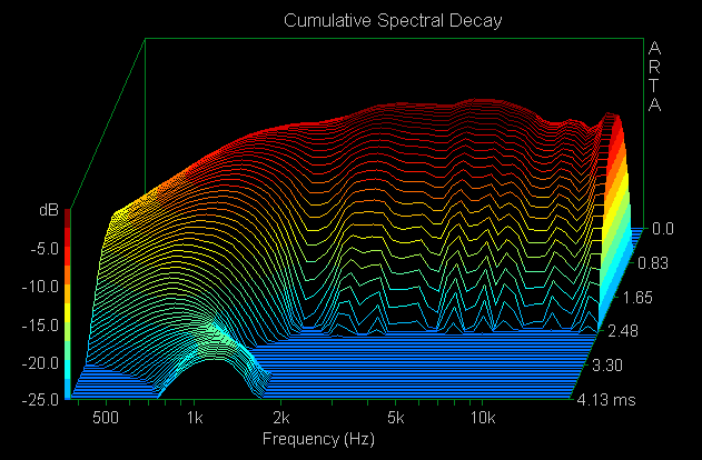

Hello Angelo,
For what it seems there is no chrome plating, those horns are manufactured in aluminum and there is no surface treatment butonly a mirror polishing final step.
(I don't know who made them but could see 3 pairs of them at an audiophile meeting organized by a French forum 2 weeks ago.
I could measure one. Here attached its waterfall
Best regards from Paris, France,
Jean-Michel Le Cléac'h

Wow, smooth waterfall! (down to 2kHz... even smooth below, but not as fast)
What driver is on the horn?
How does the driver measure in another "good horn" by way of comparison? (if such data is available)
_-_-bear
PS. Sweet looking horn... but the speed of sound in aluminum is faster than in air...so I wonder about that aspect, and if the rear side of the horn is damped by anything??
