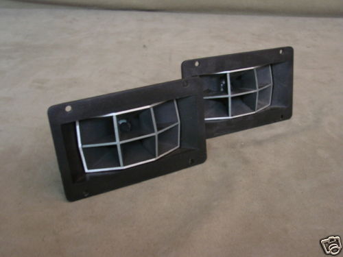

I have a couple of pair of "multicell" tweeters made by Pioneer. See photo below.
It's a faux multicell. The vanes are just glued into the horn and don't go all the way back. It's a small, transparent dome tweeter. Not a bad driver, decent off axis.
I may try to extend the vanes farther down into the throat of one pair to hear if it makes a diff.

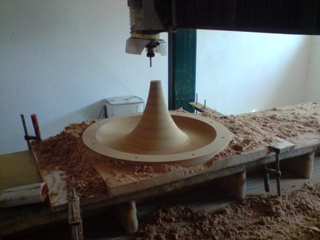

The problem of diffraction will affect 10-15kHz region so can be neglected. Exit diameter is without tolerance and horn moulding can be +-1mm in reality so I suspect it is better make a bit smaller horn entrance and let user to sand transition by the hand? Horn model and mould is now ready.

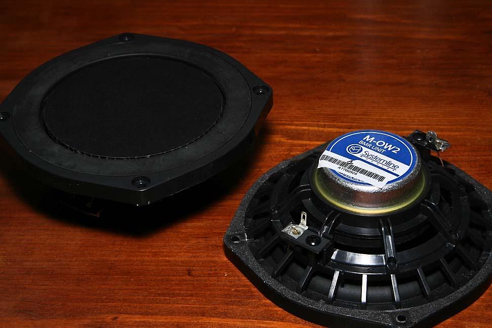

Balanced Mode Radiator, "flat piston" I've got from Systemline is quite unbalanced at 3rd mode (11,5kHz). I suspect power response must be calculated because what I hear is rather smooth driver. It can be easily attached to a horn so that compression chamber forms. The idea with mass balance is to put 10-50mg at highest mode nodal line or average nodal lines for first few modes. Nodal mapping must be performed. You can also see that BMR unit from Naim Ovator changed during last month - earlier had foam damper at the center and at Munich it is absent. They still tweak the construction before serial production.
