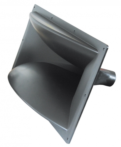

As you know I have no commercial interest in audio but I wanted to point out that my friend Marco Henry has completed a commercial version of a horn systems using 3 Le Cléac'h horns (one upper bass, one low-mid/mid and one mid-high/treble) .
Pictures of that new issue of the "Grande Castine" can be seen on Musique Concrete's website:
http://www.musique-concrete.com/MC/ENGalery.html
Below 80Hz the system is helped with a special subwoofer (not pictured) conceived by Marco Henry (from what I know it uses a large rectangular diaphragms and operates in dipole...)
The "Grande Castine" will be demonstrated soon in an Hifi shop in Paris. I'll let you know when it will be possible to listen to it and where.
The "Grande Castine" (without the subwoofer) uses 6dB/octave crossovers, it is time aligned and its efficiency is around 112 dB/1W/1m. The minimal listening distance is quite small (3 meters) and the sweet spot is large. The 3D image is fantastic. The coherence between the drivers is excellent. Marco told me that it is better to operates the "Grande Castine" inside an auditorium having minimum 50m² area.

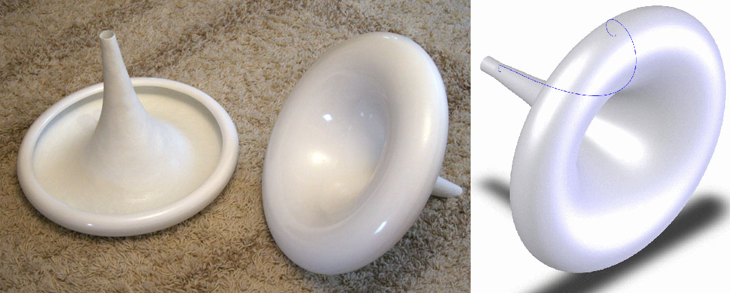

Thanks. It is MDF, and I did make this on my router - you can see some parts for the throat of the second horn to the right and behind the horn I'm holding up. It's non-symmetrical there - it has a foot attached, so it wouldn't be possible to make on a lathe. The pic below is of some of the throat parts before assembly.
Step down was between .04 and .01", although I also used an optimized machining setting that limited scallops to a height of 0.001 so in some areas it could have been finer. Basically it still needs a bit of sanding the way I cut it in order to get it perfectly smooth.
