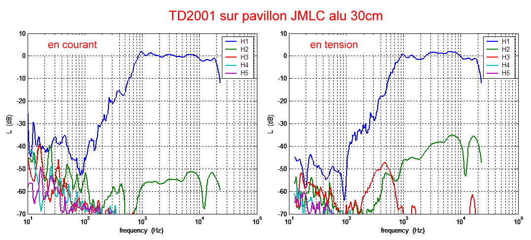

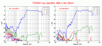

Another question. When designing JMLC round horns for compression drivers that are able to reach 330Hz, what is a reasonable electrical impedance, and acoustic impedance, and group delay, etc. What is there to look out for?
I know that the impedance for the TAD TD-2001 can be problematic below 600Hz. But there are others like Yamaha JA6681B that can do a better job at 330Hz.
If I got it right, e.g. a 1st order capacitor would have trouble because depending on the frequency in the music it would highpass at different points.
If above statement is true, is there anything to do about it? Maybe an autotransformer could help. I have read that an autotransformer can lower the impedance. Here JMMLC and David Slagle are debating autoformers vs l-pads.

"Hello,
There is not always a need to have a very low impedance source to drive compression, drivers.
With excellent drivers like the TD2001 a high series impedance is beneficial.
Either a linearization of the frequency response cruve can be acheived and a reduction of distortion (as predicted by Mills and Hawksfod).
see my measuremenst of a TAD TD2001 compression driver mounted on a Le Cléach horn (with high pass) in the following link.
Best regards
TD2001 current driven (left) and voltage driven (right)"
- JMMLC
Although in the last example, JMMLC highpassed it much higher than 330hz, so impedance was hardly a problem.

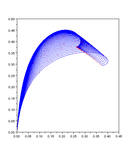

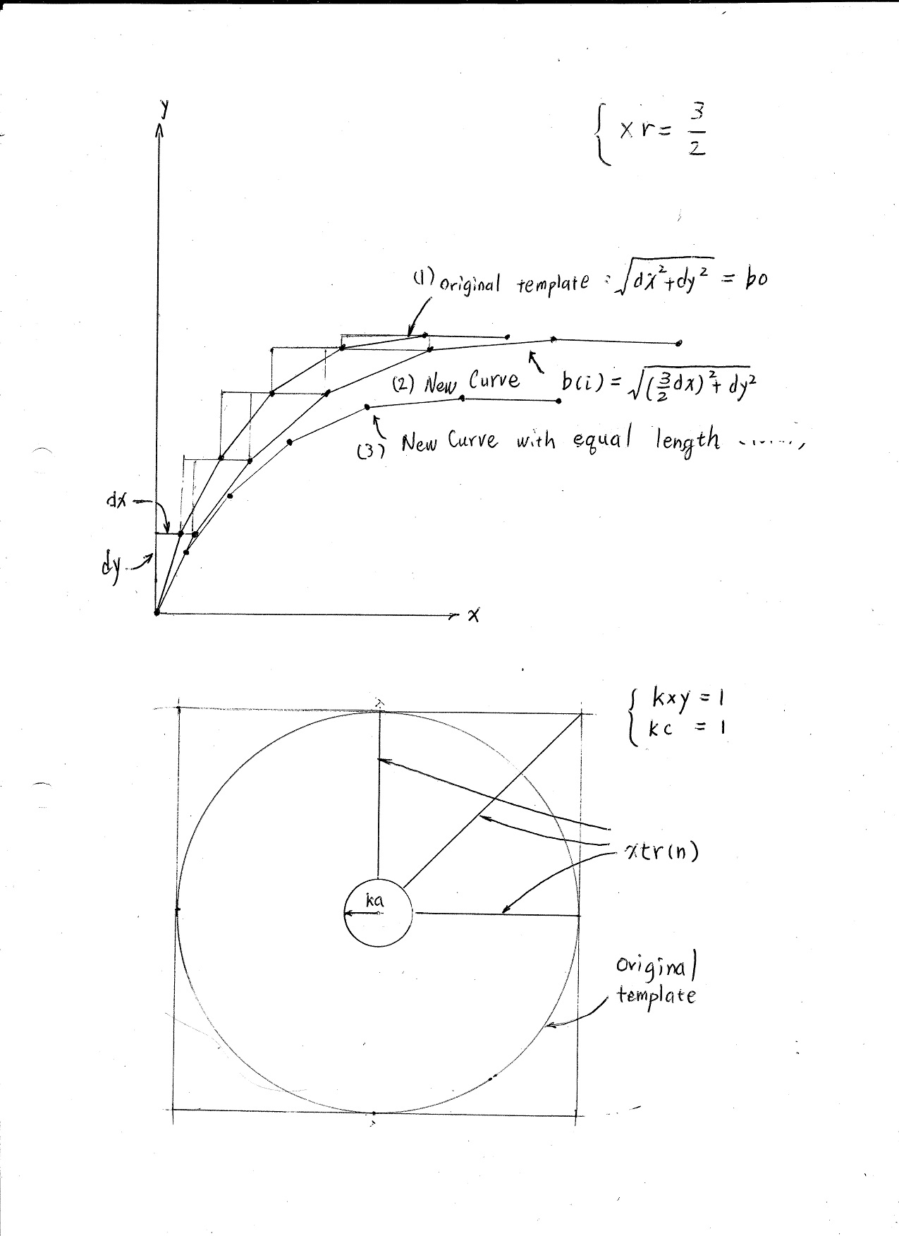

Here is the second module for calculating a horn.
Firstly, use the module 'cal_Le_Cleach_horn_template.txt' with
f0=320;
a=0.0254/2;
T=1/sqrt(2);
run a template profile, and save it as data file
save('Cleach_horn_template_f0_320_a_0254_T_1_sqrt_2.dat',theta,d,h,Lt)
Stretching (or compressing) the template curve along x axis,
and then make the new curve has same total length as template curve.
We will get a new curve with same total length but different x axis length.
By the bisection method (same as used in first module),
we will get a set of curve that meet x axis length command 'xtr'.
The set of curve make up the square horn initial profile.
nth=360;
There are 360 curves composing the horn profile.
We only have to generate 91 different curves.
nd=96;
A fixed length L, equals the length from throat to 90 degree (max y) divided by nd,
is used to do piecewise linearization on each curve,
The initial profile will not meet the expansion rate we need.
The data is saved as a temporary file
save('cal_Le_Cleach_horn2.dat',nd,th_n,rs,L)
for next step calculating.
Best regards,
Hsieh W.M.

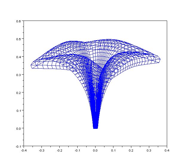

Here is the last part for a square horn.
Having got the temporary data file 'cal_Le_Cleach_horn2.dat'
from previous step, running this last module,
we will get a square horn as images attached.
I usually save the result as a data file for subsequent processing.
save('320Hz square horn_kc_1_final.dat',nth,d,h,phi,b0,i)
The method in this module is adjusting the expansion theta,
step by step from throat to mouth, according to the horn equation.
At(i)=Ah*(cosh(x/x0)+T*sinh(x/x0))^2;
The expansion theta in each direction is adjusted by the same ratio
from its initial value.
th_n(i,n)=th_nd(i,n)*(1+sD/10);
where sD is index of bisection method.
But there is a problem in this module.
The "wavefront surface" calculation formula used in first module
is not applicable in this module. Because the surface is not round.
I can not find a new method to calculate this surface.
I just change the coefficient from "2*%pi" to "2*%pi/nth".
That is, use "piecewise round surface" to represent the real surface.
s(i)=s(i)+2*%pi/nth*(d(i,n)*b(i)*th_n(i,n) + b(i)^2*(cos(th_a)-cos(th_b)));
I don't know whether this is a good approximation or not.
I had run a same horn with nth=360 and nth=3600 respectively,
There are only little differences around mouth.
Best regards,
Hsieh W.M.

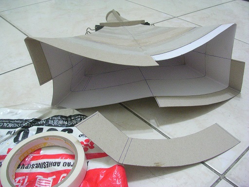

I call it rectangular JMLC horn.
It is calculated by JMLC wave-front expansion method, but with different expansion rate in each direction.
fc 1kHz, 1 inch throat, T=1/sqrt(2).
Sample is made by cardboard, and reinforced by wall putty.
Hi Hsiehwm
Great build :confused:
Am looking myself for a build for TAD2001 with rectangular jmlc, for same reason as you state (proximity listening round 3m). I aim a cutoff of say 290-300 to use properly the 2001.
Would you publish your way of building, maybe in another thread ?
BR from Paris
Jean-Louis

Hi Jean-Louis,
The constructing steps are very simple.
A round horn can be approximated by a set of conical segments.
A JMLC type horn, with equal wall length at every direction,
can be decomposed to small pieces like a round horn.
I write a procedure to do this, and print it out by a CAD tool.
Constructing begins from throat. Stick the small pieces by twin-adhesive,
two layers overlapped, and glue the gap between pieces.
But I don't think this is a good method for a large horn.
Without any mold or scaffold, it is difficult to construct precisely.
And vibration will be a big problem, especially at throat.
Best regards,
Hsieh W.M.

Hello WHG,
Thanks for the message been provided.
The approach you mentioned is just like JMLC's IWATA horn.
But the shape transformation is applied on "pseudo wavefront surface".
If we change it to horn shape, the approach will not work.
And this approach can not derive a horn shape like JMLC's E-horn.
In E-horn, the expansion angle reaches 90 degrees simultaneously in each directions.
Best regards,
Hsieh W.M.
