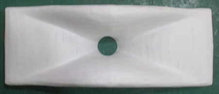

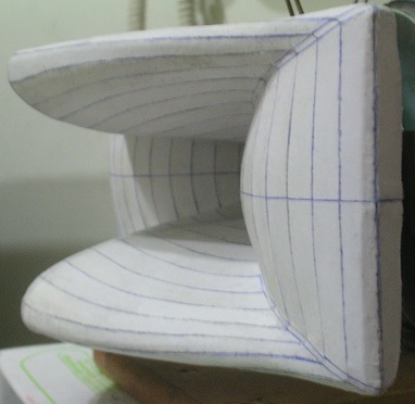

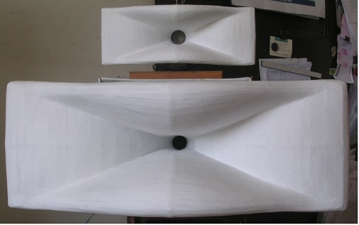

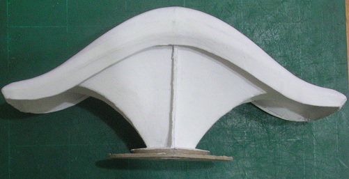

Jean Michel on LeCleac'h horns
I call it rectangular JMLC horn.
It is calculated by JMLC wave-front expansion method, but with different expansion rate in each direction.
fc 1kHz, 1 inch throat, T=1/sqrt(2).
Sample is made by cardboard, and reinforced by wall putty.

Sorry, there is no simulation or test data for it. The BEM program is too difficult to me to understand. I had made some round and elliptic type JMLC horn by the same method, and rectangular type seems more suitable for short distance (< 2 meter) listening.

I post my rect horn profile here because I think what Jean Michel said is right.
If you know how to calculate his "wave front" surface, you can get almost
any shape of horn you want.
Jean Michel's method is really superior than any other old design method.

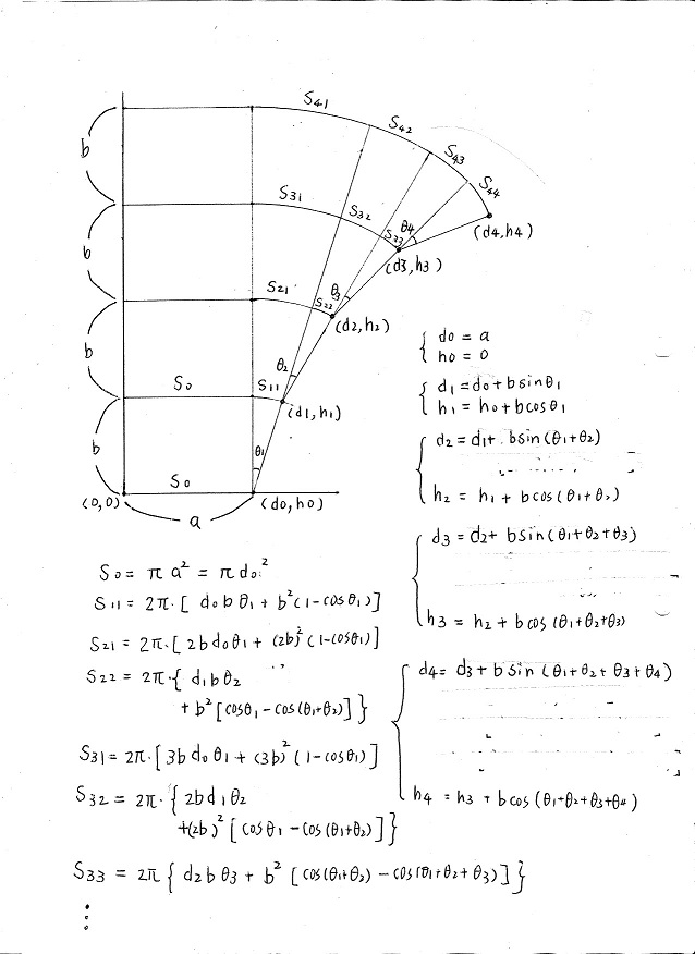

The code is executed on OPEN SOURCE SOFTWARE Scilab.
It is the first and kernel part of the calculation.
The result is a profile of round horn.
I save the profile as a template for subsequent calculation.
You may note that the profile is more different from JMLC's spreadsheet near mouth.
Because I use integration formula to calculate surface.
Please let me know you can run this code by yourself.
It will be easier to explain others codes.
Best regards
Hsieh W.M.

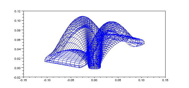

Hi again,
Bit sooner than promised - I ported code to matlab (almost nothing too it really) and got the attached output.
Looks reasonable to me! It took quite some time to run but I assume that's because of your more refined calculations.
It will take me quite a bit longer to go through the mathematics and understand the code, but all good so far.
Look forward to hearing how the elliptical calculation works; do you basically repeat the circular calculation multiple times for different parameters?
Thanks again, great stuff!

Curvature & Element Issues
Hi cv,
>snip<
Best regards
Hsieh W.M.

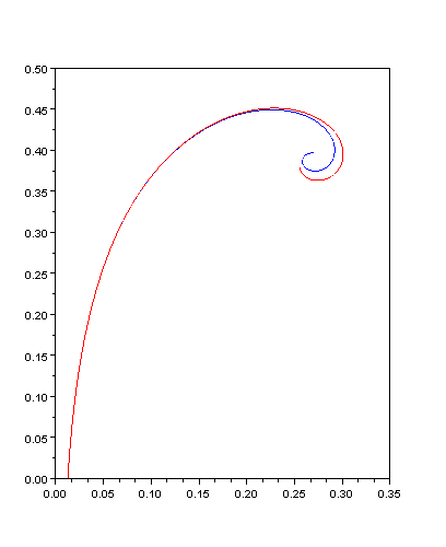

For a round section horn I do not see how this departure could be that large, between the elemental approximation and the integral for it.
For other horn boundary conditions, that departure, particularly in the [x,z] plain, would be expected as the controlling area expansion is over an entirely different surface expansion.
Further I note, that the center element shown here as a straight line segment, should be in most cases, an arc bounded by an angle equal to that of the tangent at the compression driver exit.
WHG
WHG

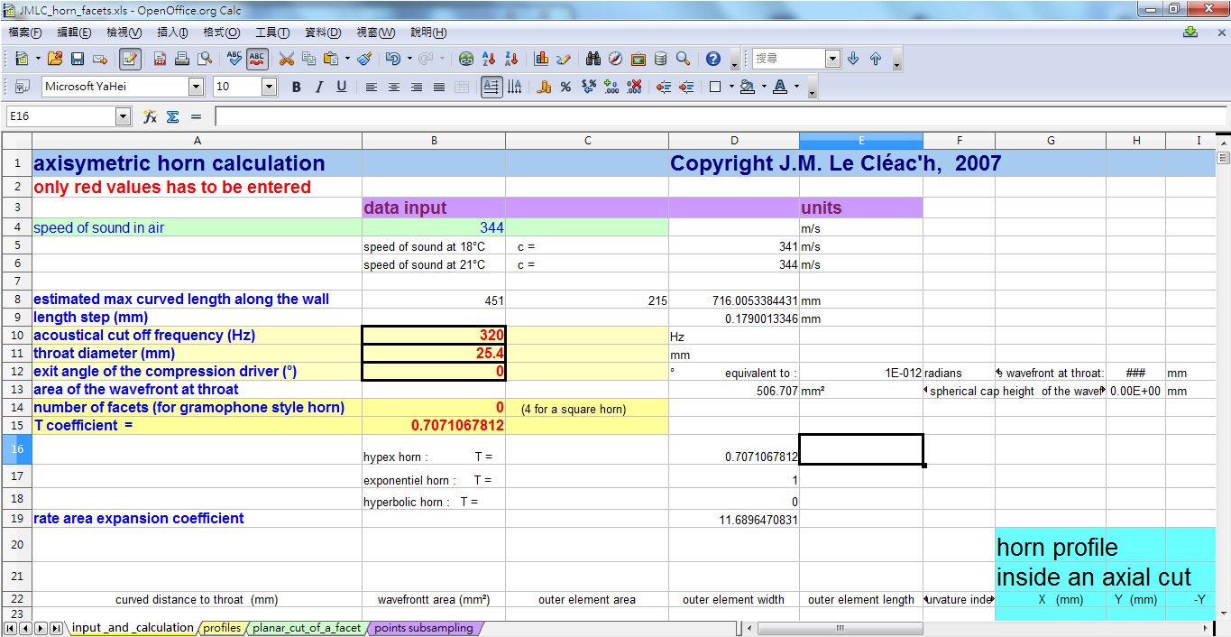

Hello WHG,
Images attached is a comparison between JMLC's spreadsheet (red) and my method (blue) with same condition.
Best regards,
Hsieh W M

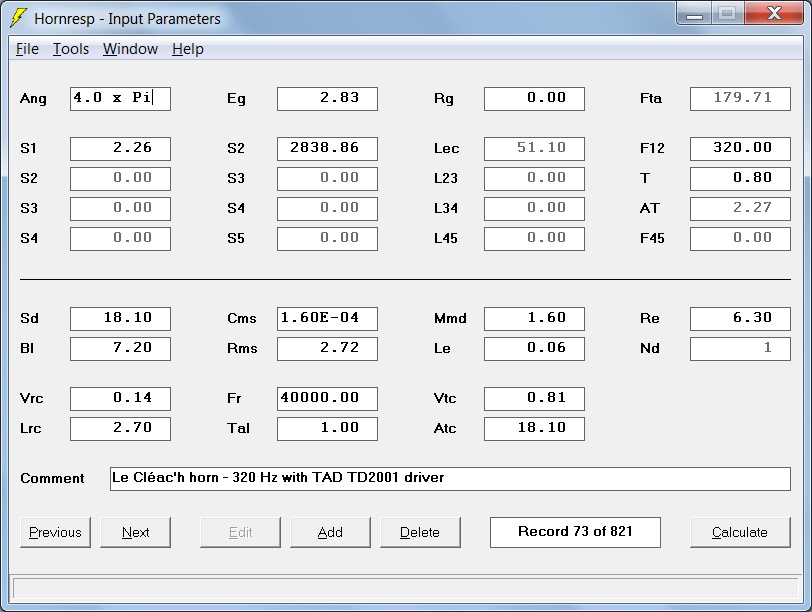

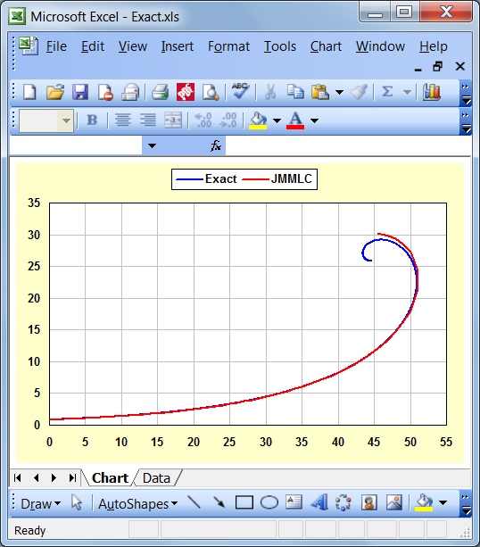

How does it compare with that produced by DJM's Horn Loudspeaker Response Analysis Program [1]?
Hi Bill,
I haven't checked the code to see if the calculations are identical, but the results appear to be very close to those produced by the "exact method" documented in my Post #1139 and subsequent related messages. Hornresp has the option of exporting data using either the "exact method" or Jean-Michel's 2007 spreadsheet method. The Hornresp "exact method" is extremely accurate.
Kind regards,
David
