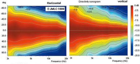

Jean-Michel,
The E-JMLC-1000 has higher directivity in the vertical plane in the high frequency range, going to a lower directivity at 1000 Hz (nearly double the beamwidth) than the horn has in the horizontal plane.
In other words, the pattern flips.
Art

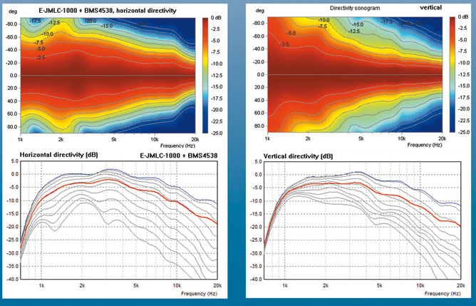

Hello Art,
I disagree. Such E-Jmlc 1000à is to be used over 2kHz and then you can see that between 2kHz and 3kHza, the horizontal and vertical directivity are the same and then above 3kHz, vertical directivity is higher than horizontal directivity.
Only at the lowest frequency range such horns can be modeled by a planar piston of the dimension of their mouth...

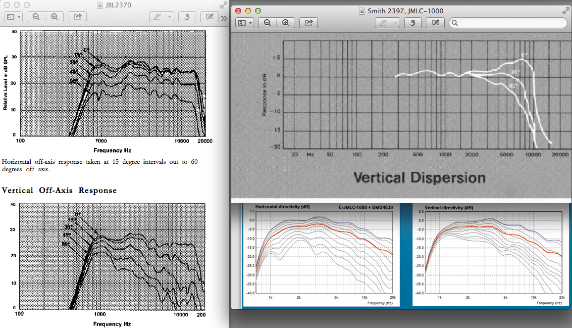

Jean-Michel,
I would agree that the pattern flip in the range of frequency you specify the horn to be used is not problematic, but the difference between the "horrible pattern flip" exhibited by the Smith horn and the pattern flip the E-JMLC 1000 polars show is just a matter of degree.
The pattern flip the JBL 2370 bi radial exhibits is similar to the E-JMLC 1000, though the 2370 has a larger vertical height, so the flip occurs at a lower frequency.
The Renkus Heinz complex conic horns have vertical heights similar or equal to the horizontal width, so do not exhibit the pattern flip common to all horns with vertical heights less than the horizontal width.
Any horn requires the vertical height to be a wavelength long to provide pattern control, simple physics determines that your horn with a vertical height of 115mm will begin to have progressively wider dispersion below 2260 Hz as the waves begin to diffract around the mouth.
There is nothing wrong with your horns obeying the laws of physics, but you seem to be disagreeing with those laws 😉.
Art

Thank you for the graphs that demonstrate that the Smith horn possess more "pattern flip" than the E-JMLC horns (despite what you said).
Any horn requires the vertical height to be a wavelength long to provide pattern control, There is nothing wrong with your horns obeying the laws of physics, but you seem to be disagreeing with those laws 😉.
Art
Doing this is assimilating the horn to an equivalent rigid flat piston. If with truncated horns this is often the case I disagree with that statement when it comes to "quasi-infinite horns" such as the Le Cleac'h horns which naturally have a roll back at their mouth.
Most of the time in horns and loudspeaker design we still use such simplistic physics laws and this is a brake to creativity.
