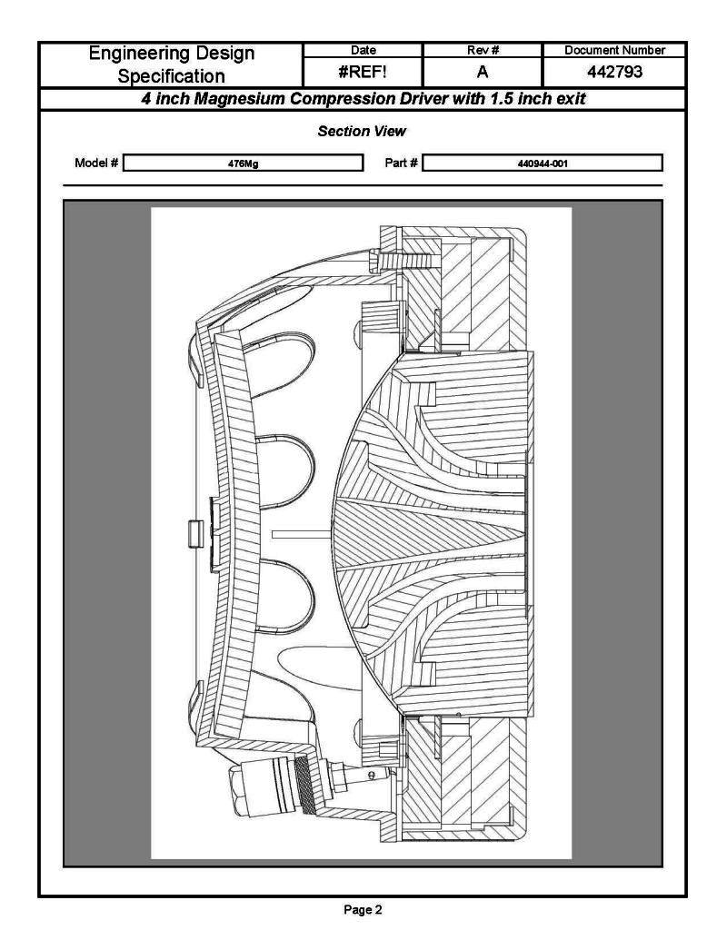

hello, i have not worked alot with compression drivers.
are the phase plugs easily removed for experimenting?
I am thinking of 3D printer which might make a interesting phase plugs for experimentation.
The outer extent of the phase plug is part of the magnetic circuit (pole piece) that delivers flux into the voice coil gap. Typically it is made from a specialized mild steel know as 'Swedish Iron'. In ALE and Goto Unit drivers, the pole pieces are made from the exotic steel called Permendur [1]. Once these components become saturated, they limit the flux density that can be delivered into the magnetic gap. Reducing carbon content and alloying with cobalt are the methods used to elevate the permeability of the steel. Bottom line: consider plug modification to be one step away from designing a compression driver from scratch.

Hi J-M,
Short Comment Follows:
The aberrations in wave front shape occurring in phase plug annuli and at their confluence, can be attributed to the viscosity of air at differing frequencies, surface roughness of the phase plug boundaries, and the high acoustic pressures that occur within these confined spaces, as well as the slope of the annular passages. Here air rarefaction and compression are taking place far outside domain of the linear elasticity of air. Thus a coherent plane wave front is impossible to achieve no mater what geometry might be used. The best that can be expected by a design effort is to minimize the effects of these short-comings. That may turn out to be just polishing the phase plug surfaces of an otherwise good design.

Here is a very good scale drawing with the Coherent Wave phase plug. Maybe someone can calculate the flare rate from it or at least get an idea.
Rob:)
