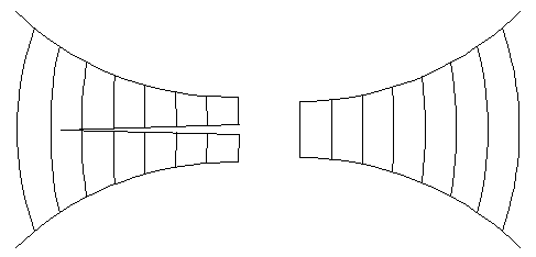

In an ideal world the horn would begin at the diaphragm, and wouldn't notice the transition between the region with the slits and the consolidated throat, or the horn proper.The phase plug ends inside the driver and there is an opening with finite length before the exit. The device with no throat would have a 0 degree exit angle, correct?
It would be presumptuous for the compression driver manufacturer to begin a horn profile when it is the end user that wants to specify the horn. They might choose instead to make use of this length inside the driver body by specifying a wavefront shape that can be worked with by a generic horn. The exit angle could be anything they wanted, but it is probably better to keep the throat expanding and so to make the exit angle more than 0.

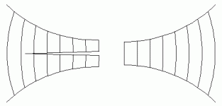

I've drawn a horn that uses a divider, and provided the pressure on each side of the divider is the same, the horns should function the same as each other. Bends won't have an effect below a certain frequency. It is up to the phase plug designer to make this work to a useful upper limit.
