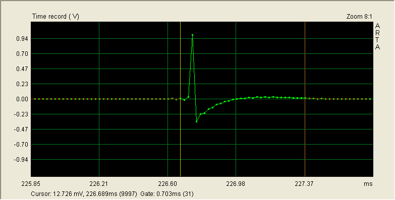

To illustrate what Lynn said about the tail of the Impulse Response, here is a IR I obtained on last Sunday on one of my axisymetrical horn (Fc = 320Hz).

Isn't the overshoot a normal part of the high pass filter?

The high-pass filter used for that IR measurement is a single 100 microfarad capacitor.
This capacitor is not the high-pass I generally use with a TAD TD2001 mounted on that horn (which is the high-pass of a quasi-optimal Le Cléac'h crossover so 3rd order) but was used to protect the driver from low frequency send to it during the logsweep of sine sent by ARTA.

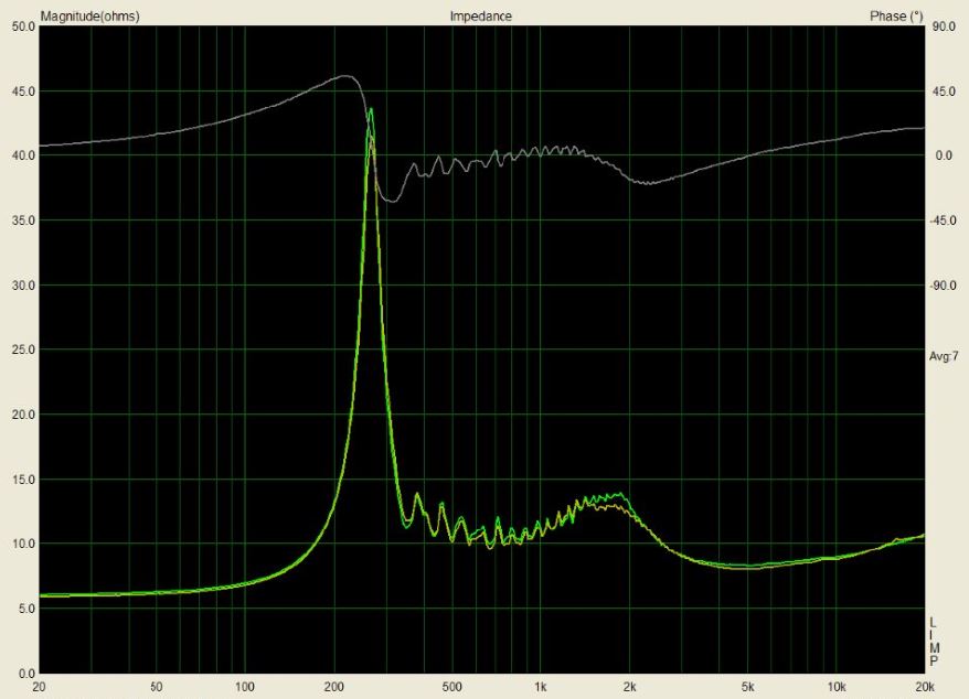

So probably, as the resonance frequency of the river is 260HZ (see the green curve on the attached impedance cure obtained on last Sunday using Limp), the overshoot is due to a residue of that 260Hz resonance.

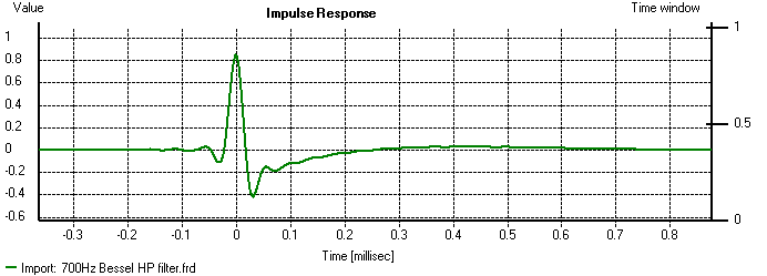

Here is what an ideal Bessel high pass @ 700 Hz would look like as an impulse in HOLMImpulse and in ARTA. We see very much the same shape as Jean-Michel's measurement. The real measurement isn't perfect, but it's not far off.
