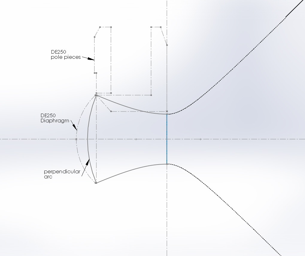

Not to pollute the LeCleac'h thread, but the BMS drivers aren't perfect either, at least not the 4552nd which I have and have taken apart. Here's a drawing I made a while back.......disregard all the weird bending business after the CD throat :rolleyes:
That's about a 26° exit angle. You can see where the throat is straight then sharply changes angle? The straight part of the throat is a guide where a thin wall cylinder attached to the diaphragm/back plate slides in to center the vc in the gap. The "u" shape at the top of the drawing is the phase plug, along with a bunch of radial slots that I didn't draw.....

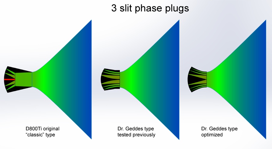

The throat should start at the phase plug adjacent to the cone. At the points you've marked the pressure from each of the slits should be in phase. The cross sectional area at this point on the horn should be appropriate for the combined pressures from the phase plug, and it afterwards continues the same expansion.
ra7
Joined 2009
You are assuming that the horn starts where the phase plug ends. I may be wrong but this is almost never the case. In the JBL diagram, and in the drivers I have seen, this is not the case. The phase plug ends inside the driver and there is an opening with finite length before the exit. The device with no throat would have a 0 degree exit angle, correct?
Phase plug.
Something similar to the last figure in jzagaja's post would probably be ideal. Jack, is someone making these drivers?
I can see why this might be important. We want the wavefront to not have any sharp discontinuities in its path. But why don't manufacturers spec this very important parameter? And why don't horns specify it either?
