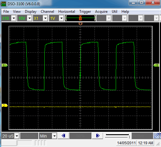

Anyway, mikelm I managed to move the board around a bit and get it to behave for a few minutes. Here is the 20kHz square wave performance at nearly 40v p-p across a 7R load. What do you think?
By the way, when it's not oscillating the DC offset is stable to within a few mV.
By the way no 2....the rise and fall times aren't quite as impressive as they were yesterday as I have upped the gate stoppers to 500R in an effort to stop oscillation. However, the ringing has entirely disappeared which is very good!
Yeah not bad huh? What loads would you like me to try it with?

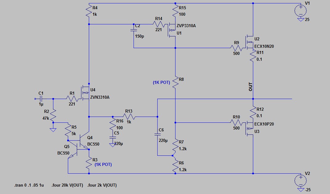

Thanks Mikelm.
Sure here it is.
I know the miller cap is very large but it is the smallest I have lying around. I also intend to bypass the bias pot with a 1uF cap, but for the moment it seems to make things worse so I have taken it off.
Also my source resistors are actually 0.47R as I didn't have any 0.1Rs handy.
I have tried all of the following both separately, in combination and all together at once:
1) Output filter with 100n cap and a 10R and 5R resistor.
2) With and without the miller cap.
3) Original VAS degen resistor was 50R, now it's 100R.
4) I upped the gate stoppers on the main fets from 221 to 500R.
5) I tried adding 220pf to gate of n channel fet to balance them (rod elliot had problems with this).
Look forward to your comments. Yikes it's 2:20am! Time for bed I think.

Sure here it is.
I will try dropping the OLG further tomorrow.

Just wondering ... what is the purpose of C6?

danspy, if you can, try to increase C6, for example 330~470uF. Let me know what results you get.
Also, let R6 be 1K and R7 be 1~1.5K.
