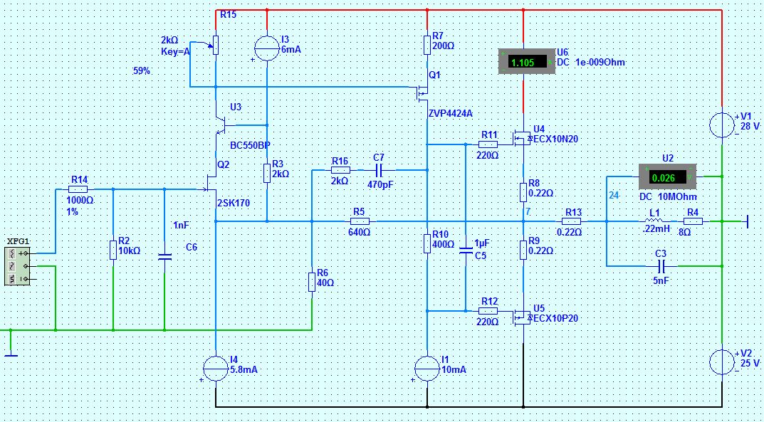

The working circuit
Mikelm,
Your circuit looks good. Do you think you'll be building it any time soon? I want to hear what you think of it. Is the output choke really necessary? I quite like the vas comp too.
Dansky, thanks for the schematic. What is it about the sound you think is missing? Your construction is much neater than mine. Looks good!
This is my current circuit which appears stable. I'm not sure how to test capacitive loads exactly, but I put a 1uF cap directly across the output and tried square and sine waves from 0 - 20kHz and low and high power. No apparent problems, just a little ringing on the square wave test. Is that useful info?
Currently the overall gain is quite low, and it will take the full 2V RMS from a typical CD player to get anywhere near clipping. This suits me fine as it saves me having to use an attenuator except for very low volume listening.
The thing that really made the difference was increasing the feedback and sacrificing some CLG. The OLG is still not too bad though - only 100R and 60R degen resistors for the input and VAS stages respectively. I tried a lot of OLG/CLG combos and this is the first one that worked. It seems very stable now, and I am unable to entice it in to oscillating by tapping the input or components with my finger, etc.
Probably dominant H3 because i am grown up with it, MC Tape Walkman, and i never had a Turntable.

Yeah, I think you're right. Sometimes I think it lacks "detail" and "definition" but then I listen carefully and realise it's all in there, just a little more "integrated" than I'm used to. The final version especially has shown a vast improvement in definition, i think partially due to the addition of the 1uf cap across the bias resistor. What kind of music are you listening to?
We both have pretty different amplifiers really. The only similarity at this point is that we both have fet output stages and a SE input so I wonder how they might compare sound wise. I will add the jfet input when they arrive, though I am reluctant to mess with an already good thing. Fortunately the pinouts are the same.
Another thing, when I finally got rid of the oscillation I heard a distinct improvement in the sound. Whether this was due to the removal of the oscillation itself, or the circuit changes made to remove the oscillation, I don't know.
Oh, one more thing you might like to try. The cap across the bias resistor made an audible difference for me. My previous simulations demonstrated that the cap reduces distortion at high frequencies and I'm fairly sure I could hear that....
Anyway, it's certainly better than a lot of others I have heard, and the trouble shooting and development process has been a real buzz.

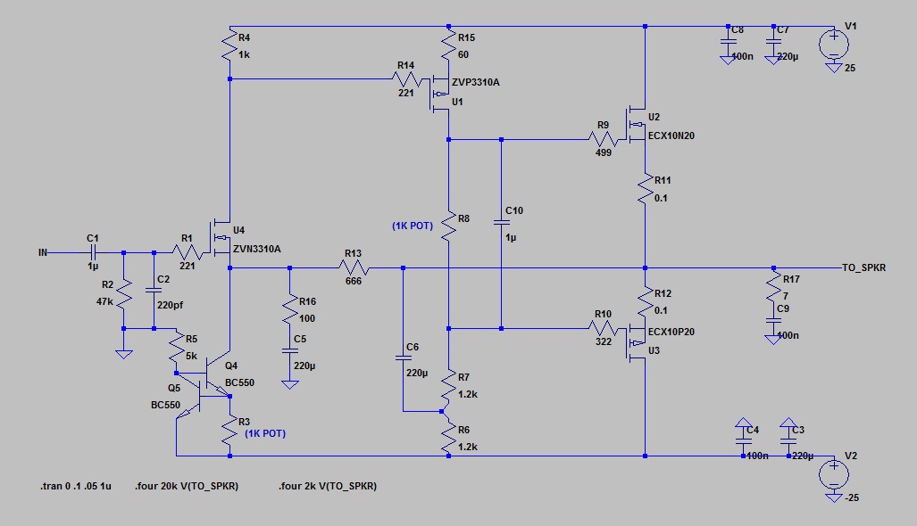

I wanted to ask you, what results do you have in your sims when you increase the 1uF capacitor, in terms of distortion?
Another thing, try to decrease the gate stopper resistors, not in sims, but in your current assembly, and listen, how much does bass change on this?
Can you upload the sim file along with the models?
I started to think that I should assemble mine and try it out myself, too, tomorrow will see if I can get all the components in one go from local shops.

It seems I have told a white lie about the suckout capacitor. When I was trying different things in simulation it did have a positive effect on HF distortion when used with a BJT VAS with a miller cap, but with the current uncompensated FET VAS it actually makes things worse.
Funny, because I still maintain that I like the sound more with it in place...
My apologies for misleading you. I have simmed so many circuits in the last week or so that they have all blurred together, and I assumed that the benefit would apply to any VAS.
That said, it is still worth trying danspy as you do indeed have a BJT VAS.

Metal,
Here are the figures. It would seem that the sucker cap helps at 2kHz and is detrimental at 20kHz. Note these figures are at about 22v p-p output. Seems it would be worth using one in that case as I can't even hear 20kHz. Maybe there's a measurable reason for why l prefer the sound with it in after all.
2kHz with sucker cap:
Fourier components of V(to_spkr)

2kHz without sucker cap:

20kHz with sucker cap:

20kHz without sucker cap:

Total Harmonic Distortion: 0.018387%

Number [Hz] Component Component [degree] Phase [deg]
1 2.000e+03 1.077e+01 1.000e+00 0.26° 0.00°
2 4.000e+03 1.171e-03 1.087e-04 -99.77° -100.02°
3 6.000e+03 1.723e-03 1.599e-04 3.53° 3.28°
4 8.000e+03 5.715e-04 5.306e-05 86.34° 86.09°
5 1.000e+04 4.196e-04 3.896e-05 -178.06° -178.32°
6 1.200e+04 2.265e-04 2.103e-05 -90.46° -90.71°
7 1.400e+04 1.429e-04 1.327e-05 -0.68° -0.94°
8 1.600e+04 7.802e-05 7.244e-06 86.67° 86.41°
9 1.800e+04 3.862e-05 3.586e-06 178.45° 178.19°
Total Harmonic Distortion: 0.020595%
DC component:0.0145908
Harmonic Frequency Fourier Normalized Phase Normalized
1 2.000e+03 1.077e+01 1.000e+00 0.27° 0.00°
2 4.000e+03 2.753e-03 2.555e-04 -87.40° -87.66°
3 6.000e+03 2.442e-03 2.267e-04 5.93° 5.67°
4 8.000e+03 1.128e-03 1.047e-04 97.18° 96.92°
5 1.000e+04 6.313e-04 5.859e-05 -169.94° -170.21°
6 1.200e+04 2.522e-04 2.341e-05 -77.84° -78.11°
7 1.400e+04 3.497e-05 3.246e-06 10.23° 9.97°
8 1.600e+04 8.356e-05 7.756e-06 -72.68° -72.95°
9 1.800e+04 1.246e-04 1.156e-05 17.52° 17.25°
Total Harmonic Distortion: 0.036304%
DC component:0.0132126
1 2.000e+04 1.071e+01 1.000e+00 -0.10° 0.00°
2 4.000e+04 1.061e-03 9.904e-05 -105.91° -105.81°
3 6.000e+04 2.070e-03 1.932e-04 46.34° 46.45°
4 8.000e+04 5.842e-04 5.452e-05 143.10° 143.20°
5 1.000e+05 5.539e-04 5.170e-05 -112.98° -112.88°
6 1.200e+05 3.031e-04 2.829e-05 -22.04° -21.93°
7 1.400e+05 1.686e-04 1.574e-05 73.58° 73.68°
8 1.600e+05 8.860e-05 8.269e-06 -170.81° -170.71°
9 1.800e+05 7.558e-05 7.054e-06 -79.16° -79.06°
Total Harmonic Distortion: 0.023223%
DC component:0.0127333
1 2.000e+04 1.072e+01 1.000e+00 -0.09° 0.00°
2 4.000e+04 3.822e-04 3.565e-05 -0.16° -0.06°
3 6.000e+04 1.582e-03 1.475e-04 78.07° 78.17°
4 8.000e+04 3.238e-04 3.020e-05 -170.82° -170.73°
5 1.000e+05 2.356e-04 2.197e-05 150.60° 150.69°
6 1.200e+05 5.721e-04 5.335e-05 -145.37° -145.28°
7 1.400e+05 5.804e-04 5.413e-05 -64.54° -64.45°
8 1.600e+05 3.747e-04 3.495e-05 -9.06° -8.97°
9 1.800e+05 5.225e-04 4.874e-05 7.96° 8.05°
- JFET input, MOSFET VAS, LATERAL output = Perfect!!
