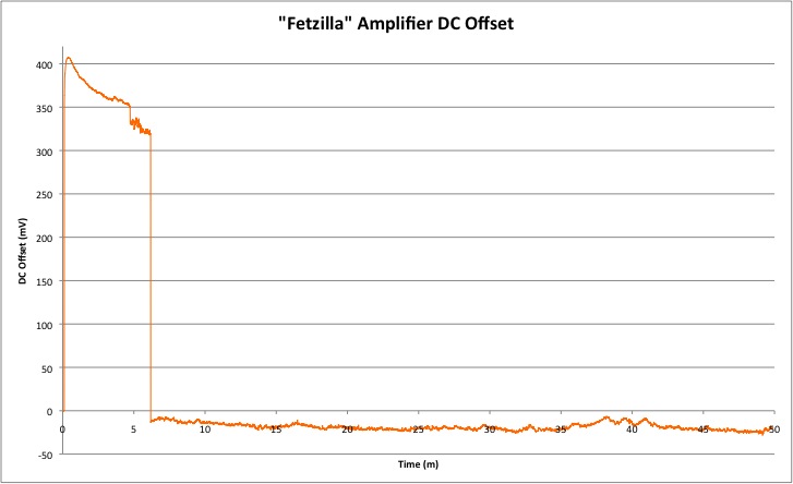

I'm still not sure we need a servo yet - if you don't mind a little drift. I'm going to buy a multimeter today that has datalogging capability so I can measure the DC offset every second for an hour and see how it changes. It will be interesting to see the graphs when it's done.

I bought a multimeter yesterday with logging capability but can not get it to work with my computer as it uses an old school rs232 serial cable and software made for win98. Bought a USB to serial adapter but no good. Taking it back today to swap it for s USB one - if they have any.

All,
Here are the DC offset results. Test interval is 0.5 seconds for about 50 minutes into a 7 ohm resistor. As you can see it did stabilise at about -20mV at about 7min or so...but I wonder what the hell happened to make it drop from +325mV or so!? I will have to test again and confirm if this happens every time.
So what are your thoughts regarding the need for a servo or other offset control? I think I could now readjust and have it stabilise at +/- 10mV, but the high offset on power up is a worry.

Hmm, interestingly the big drop at 7min can be induced instantly by touching the input. It would seem that when the amp is first turned on with no source attached it is in some kind of metastable state, and just the slightest stimulus can make it stabilise. Probably even the noise from a source would be enough....
Maybe no servo is needed?
