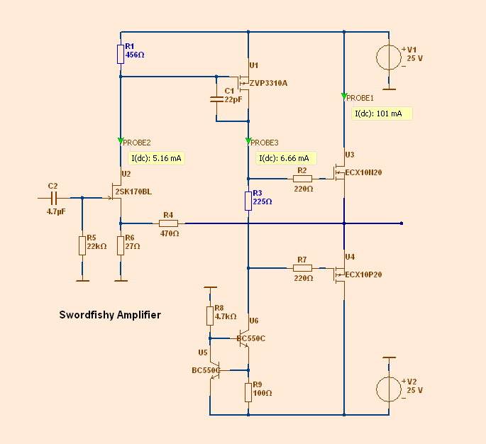

SWF,
I think the stability is quite good, but, the ongoing, undamped overshoot concerns me.
First up, try about 47pF from drain of the VAS to the jfet source, and if that is not sufficient, add a 10pF silver mica miller cap across gate/drain of the VAS.
I hope this scotches the overshoot... and it should also improve the sound quality further.

A second solution to stability issue is a cap from vas drain to output.
with resistive load you will have unity gain. but with a capacitive load it will start working as the gain fall below unity.
try 470pf - 2.2nf.
It works well.

Brief comment on the fb resistor: it does not destabilise anything at all. By using the series fb resistor to set up the DC operating conditions of the amp we actually simplify the circuit. In practice, it will have an almost constant DC current through it, fixed by R4, the source/gate resistor of the VAS.
Idss for the 2SK1780 is listed as ranging from 2.6ma to 20mA, in three distinct ranges. I'm hoping that SWF is using the BL series, the middle range, 8-12mA. 2/3 of the Idss is correct, but as pointed out the fact the gate bias is positive indicates either the stage current is too high or the grade of the jfet is inappropriate.
This is a low transconductance device with very low noise, around 22mS. That means Id increases by 2.2mA for each 100mV of gate potential increase. (22mA for each volt). A BF862 will therefore generate another 6dB of loop gain, and compensation might need revisiting. An increase of VAS degeneration could do this, of course.
I don't actually recommend a cap across the fb resistor to stabilise things. I prefer a combination of miller cap on the VAS, and phase lead from VAS drain to fb node. In my experience it's more predictable, more stable. It does work, but to me it's less elegant.
Mike, interesting that the mosfet VAS actually rolls off at HF!! This can only be the capacitance at the gate pulling back slew rate, but it's not what SWF found at the outset. This certainly explains why lag compensation is not required even though we have about 75dB of loop gain.
SWF, the rating of the S170 is 400mW. For reliability I gun for no more than one third of this, 135mW, so you are on the limit, particularly as your climate is subtropical. OTOH, you should try for 2/3 of Idss for best results. Fortunately, you only have low voltage across the device.

Having built lineup's original circuit I prefer the version without the CCS in the input, but it will be interesting to see what everyone else thinks.
Lineup,
I actually tried removing the Feedback Cap yesterday and had some pretty bad DC offset issues. Not sure if this will apply with the CCS version, but it was pretty terrible with the front bias version.
Yes, but back then I was using the ZVP3310A, a much smaller TO92 device compared to the TO220 IRF9610. I assume the gate capacitance was much smaller too?
Hugh, I actually have both current classes of JFETs (the higher class is still coming), so it will be interesting to experiment. Indeed, I do need to reduce the current.
I set up the schematic yesterday without really tweaking the resistor values and was so gob smacked by the results i had to post the schematic before I had checked everything was running within spec.
I hope to try your suggestions for removing the overshoot over the coming days.

Yep, the IRF9610 has no less than 170pF of Ciss, pretty high.
I note it can do 200V and 2A to 20W, that's a serious device. The curves look quite non-linear at very low currents. I wonder if there are other mosfets which can do no more than say 500mA, with all other characteristics similar and a lower Ciss?
That might sound better, but then, it might need quite a bit of compensation, too. Might check Siliconix, they have some smaller ones.
The bootstrap will bring much more current variation in the VAS, which in turn will boost lower order harmonics, chiefly H2, H3 and H4. It also relaxes the compensation issues because of the inductance of the bootstrap cap. However, you may not prefer the sound; I like it, but tastes vary.
