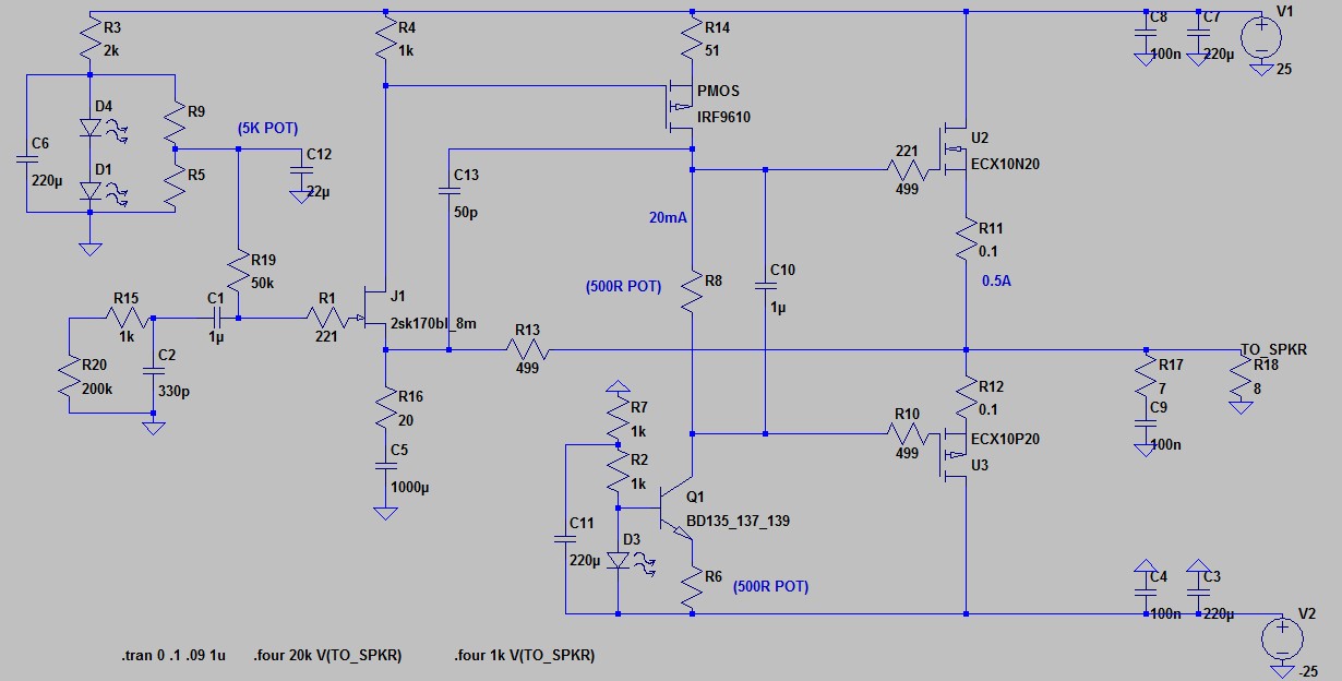

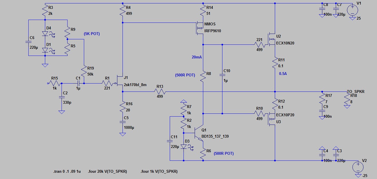

swordfishy has built an amplifier without compensation cap.
I will publish a diagram from swordfishy's latest.
With a bias of the JFET with CCS from negative rail.
Here is swordfishy's great amplifier again:

Hi All,
Well I just tried a few more things and now we're really getting somewhere.
First, I increased the input drain resistor to 1k to bring the current down to 4.5mA. All good, no adverse sonic affects.
Second, I added the filter cap to the input bias as lineup suggested. Not really any sonice affect, but clearly good practice.
Third, I added a grounding resistor to the input.
Fourth, I tackled the capacitive load overshoot and ringing square wave issue. I tried three things:
1) I wired a 4.7nF cap from the VAS to the output as was suggested here by Sonnya. This caused the amp to oscillate so I quickly removed it and aborted the idea.
2) I tried a 150pF miller cap. Made no difference.
3) I was so keen to try Hugh's idea of a cap from the VAS to the JFET source that I improvised and used 3x 150pF polypropylene in series for 50pF. Perfect. Now no capacitive load under 100nF makes any change to the 20kHz square wave that is worthy of mention. A 1uF cap will still make it do some funky things, but better than before.
It may be the placebo effect, but I would suggest that it sounds better too...
So ladies and gents, here is the current circuit. It is very good indeed. I think a change of VAS fet may make it even better!

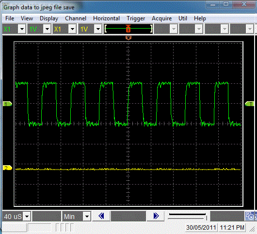

Hugh, mikelm, all,
With the 50pf of compensation outlined in post 531, the square wave is now clean up to 100nf of capacitive load. I would expect that further compensation would improve things further. What are the pros and cons of adding more capacitance here?
Thanks for your input.
Btw, mikelm that link did not work, but I'll go search for jlh at amazon.
Thanks Mikelm, I'm going to order what I can find of those.
Here is the current 20 volt peak to peak, 20kHz square wave with 7.27R and 100nF... Anything below 100nF looks much the same. 1uF is pretty messy, but a vast improvement on yesterday. Need I pursue this issue further or are these results good enough?
I have dropped the VAS current to 15mA as the devices were getting quite warm with no heatsink.
Edit: I posted the wrong photo. This is shot is actually with 75pf of compensation, but 50pf looks pretty much identical

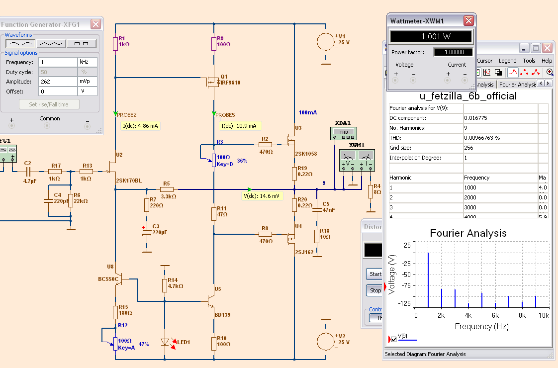

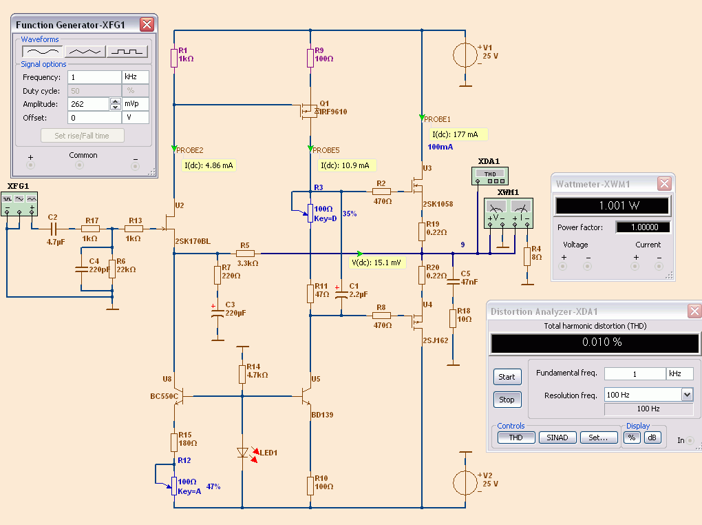

Hello swordfishy and mikelm
I have made an official version of Fetzilla
Eventhough people are free to build how they like
this is the one version I recommend people to build.
It is based on swordfishy's published amp, with super-good sound.
What is remarkable is that his amp is stable without compensation cap.
This is because of IRF9610 lower gain
but also emitter degeneration of VAS IRF9610 with one 49.9 Ohm capacitor.
This version below should be equally stable, sound good
and not give any headache with oscillation.
Fourier analyse at 1 kHz shows nice spectrum
with H2 and H3 sticking out. This is how we want it.
I be back with further tests later.

hello mikelm
I'd be happy if you tested my circuit in real life.
swordfishy tested DC-linked version, with no big cap.
he was not happy DC-offset problems, like Hugh suspected.
I think you need not test the DC-linked version without cap.
It is simply not good and safe.
But the official version I posted now should not cause any problems.
I think it might sound good, too.
I suspect the VAS with IRF9610 is working wonders.
Only thing I forgot is one 2.2uF cap across the Gates of output.
Like in diagram below:
- JFET input, MOSFET VAS, LATERAL output = Perfect!!
