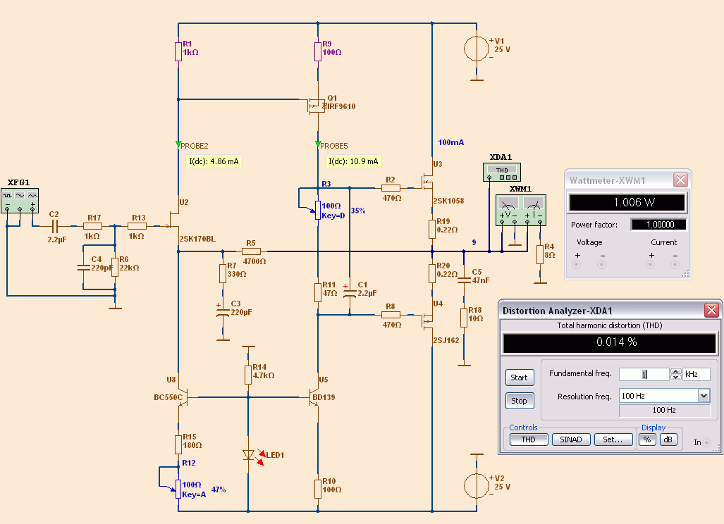

That test was temporary Fetzilla with no emitter resistor for IRF9610
and the feedback divider was the lowest: 150/10 Ohm. (gain x15)
Such an amplifier has got high OLG, and so need compensation.
If you try the official Fetzilla with THD 0.010%
you will notice it has more H2 than H3.

I do AC analysis.How do you determine which compensation is right...??
Can you do that in simulation.. Don't you need real circuits for that..??
If there is an overshoot in AC curve, we can guess circuit is not stable.
On previous page I show how to use AC analysis.
True is that a real circuit seldom match the compensation done in SPICE.
But to compare 2 things is possible in SPICE. The relative value.
For example I had posted a circuit with 22pF
Danspy got oscillations until he useed 100pF.
So, compensation in SPICE has got a value on its own.
But should not be confused with a real circuit. At least when it comes to compensation.

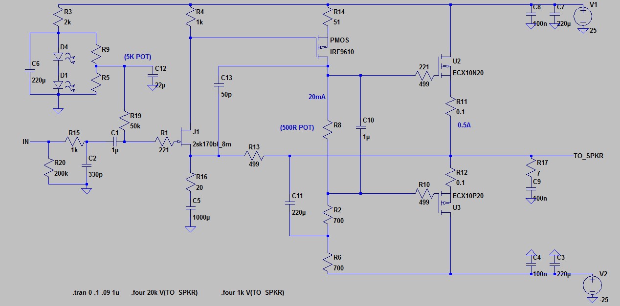

Edit: VAS current is actually slightly lower than 20mA, maybe 16-17...easily changed with smaller bootstrap resistors....I only had 700R available.
All,
I have been fussing about the CCS in the VAS for the last few days. All of the ones based on active devices have pros and cons. Some are noisy, some oscillate, some latch up. All require extra parts and possibly a pot that adds noise and could go open circuit at any time.
One thing I would like is to be able to run 20mA in the VAS. This sounds better and can drive vertical fets if necessary. The BD139 struggles with such currents and no heatsink. Adding a heatsink is a nuisance.
In my opinion, if we can offload the active CCS in the VAS and get good sound it might be nice. (Geez, I' m sounding more and more like Hugh every day).
Imagine! A HiFi, sweet sounding amplifier with only 4 active devices. An amplifier in almost its purest form. A buffer, a voltage amplifier and a current stage. No active devices anywhere else in the circuit to add colouration or artifacts. The only thing purer is single ended class A.
Well here is a working solution.
You may recall that I didn't have much luck with the bootstrap VAS (danspy did - though he never scoped it to check stability). Well I have learnt a lot over the last few weeks, and now I know how to get an amp stable. Here is a working circuit. It is by no means tweaked. There may be better values for the bootstrap capacitor, bootstrap resistors and VAS degeneration and compensation. But it works and works well. Stability is as good, if not slightly better than before. Slew rate is also very good.
I have only listened at very low volumes due to a quietly sleeping girlfriend, but I think it also has the potential to be my favourite sounding. So here it is:

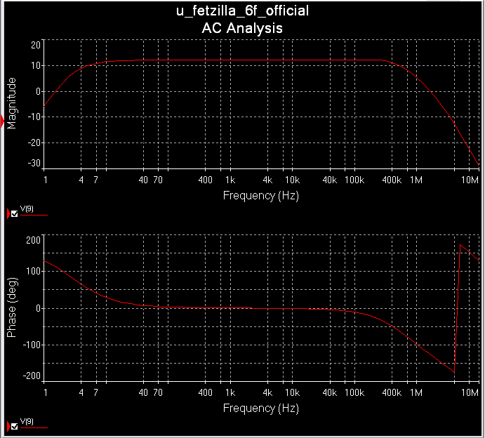

What I like to know is if 'official' is stable and good WITHOUT any comp cap.
My thought is that people who build should not have to worry about oscillations.
You could run some squarewave at 1kHz and 20kHz.
If needed I will change to feedback divider to higher values.
Do it when you have time.
Here below is latest official.
And the AC Analysis curve that shows no 'overshoot' of the circuit.
The curve is done without input filter 220pF
