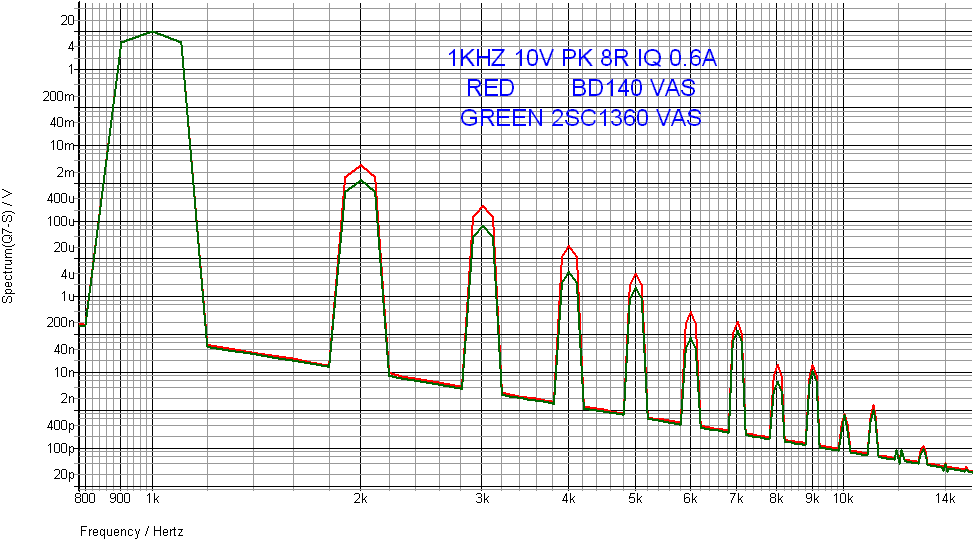

Better performer as VAS is 2SA1360, while BD140 is not as good , yet it can outmatch an IRF9610.
Slower BJTs like MJE350 are such a failure that this highlight the critical choice of the VAS component.
There s a flaw in the schematic that must be corrected to make the amplifier sound good, more on this later as soon as i ve checked the issue.

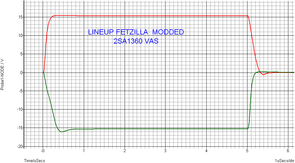

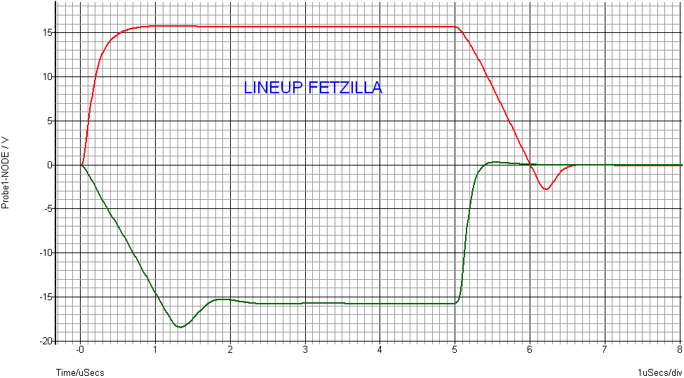

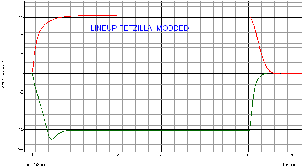

Here some comparative simulations using Lineup version Fetzilla, that seems
to be the best one in the lot, with the said flaw corrected.

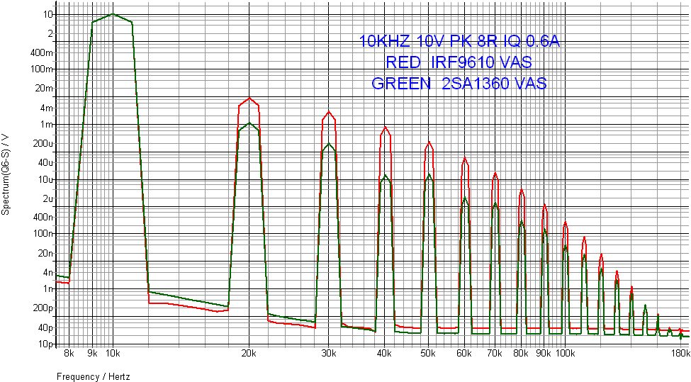

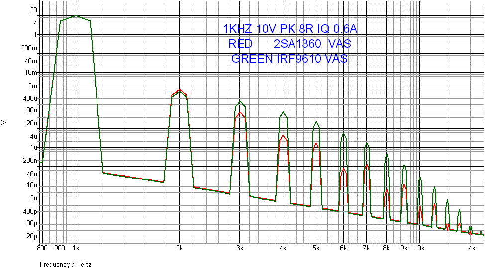

What appears is that distorsion is acceptable for any kind of VAS
at 1KHZ , but at 10KHZ, the mosfet VAS produce annoying level
of THD that is 20db higher than the best BJT based VAS.

Next we can test inpiut JFET.
And why not put a BJT LTP while we are at it.
And finally we remove Lateral output for a better driver+BJT.
And there you have it: THe Blameless Amplifier.
